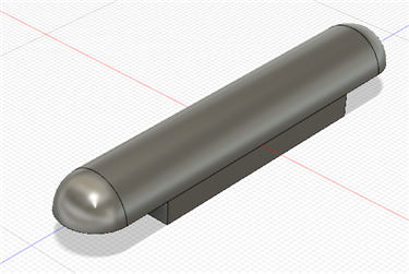

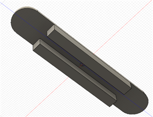

It has been a crazy 24 hours.  I spent quite a bit of time yesterday afternoon/evening agonizing about my next steps in getting WalkyII to improve his steps.  I had been watching WalkyII walking in slow motion, looking for any unusual hitches in his stride.  A couple of things that I noticed had to do with the stability of his spindly legs. As he starts leaning into his tilt his feet almost touched.  This seemed to worsen his balance as his center of gravity moved outside of his weight bearing foot.  Being the 'rocket scientist' that I am, I thought that I need to prevent this tendency for his weight bearing leg to flex inward.  That, and as I reworked his lower control arms, I noticed that being more rigid than before, they were twisting the servo control horns (due to the fact that the lower control arms were not parallel to the ground).  So, I quickly designed a couple of fixes for WalkyII.  The first fix was a slider/bumper that attached on the bottom lip of the body, that would help to keep WalkyII's legs from pitching inward.  The other was a bracket for the leg to lower control arm attachment point that would lower the leg end of the control arm ball joint.
Here are some views of the resulting designs (from left to right - top of bumper, bottom of bumper, control arm pivot extension):
