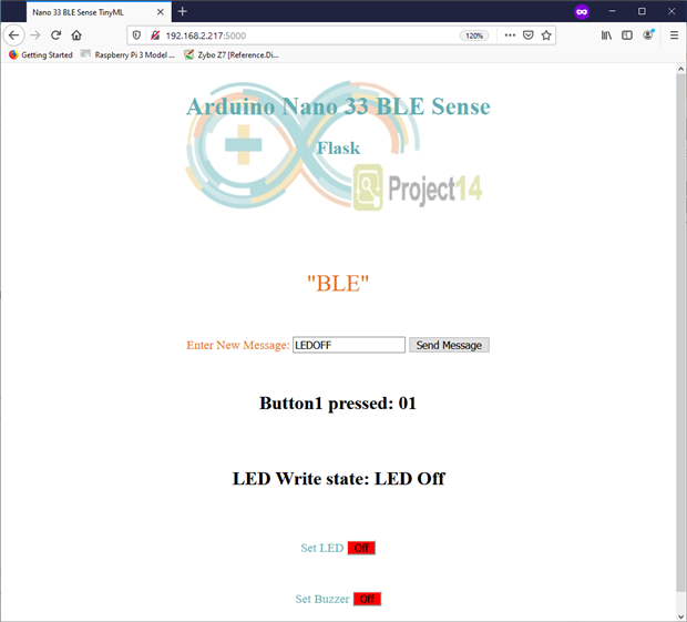

    4. Read the string in
if (stringCharacteristic.written())
     String inValue = stringCharacteristic.value();
     Serial.print("String value:");
     Serial.println(inValue);
     if (inValue.equals("LEDON")) {
         stringCharacteristic.writeValue("LED On");
     else if (inValue.equals("LEDOFF")) {
     else {
        stringCharacteristic.writeValue("UNKN");
BlueZ - Write and Read commands

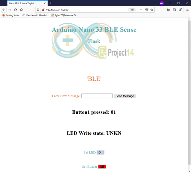

  NOTE: Arduino code was expecting "LEDON" or "LEDOFF" otherwise returns "UNKN" for unknown.

    3. In the Flask views.py file, an instance of the BLEDev class is created to pass RESTful POST and GET commands to the Nano 33.
        a.  Import nano_ble_sense.py BLEDev to the views.py file
from .nano33_ble_sense import BLEDev
        b. Create an instance of BLEDev
nano33 = BLEDev("BLE33", "hci0")
       c.  Read a value from the Nano 33
            Ex:
   NOTE: I have no idea why this is being created as a table.
btn1_output = nano33.send_read_command("0x000e")
led_output = nano33.send_read_command("0x0013")
       d.  Write a value to the Nano 33
            Ex:
nano33.send_write_command("0x0013", newNanoMsg)
    4.  Initialize the webpage.
@app.route('/')
def index():
    now = datetime.datetime.now()
    timeString = now.strftime("%Y-%m-%d %H:%M")
    print (timeString)
    arduino_logo_path = os.path.join(app.config['UPLOAD_FOLDER'], 'auduino_logo.jpg')
    templateData = {
        'title' : 'Nano 33 BLE Sense TinyML',
        'time' : timeString,
        'btn1_output' : btn1_output,
        'led_output' : led_output
        #'ledState' : ledState

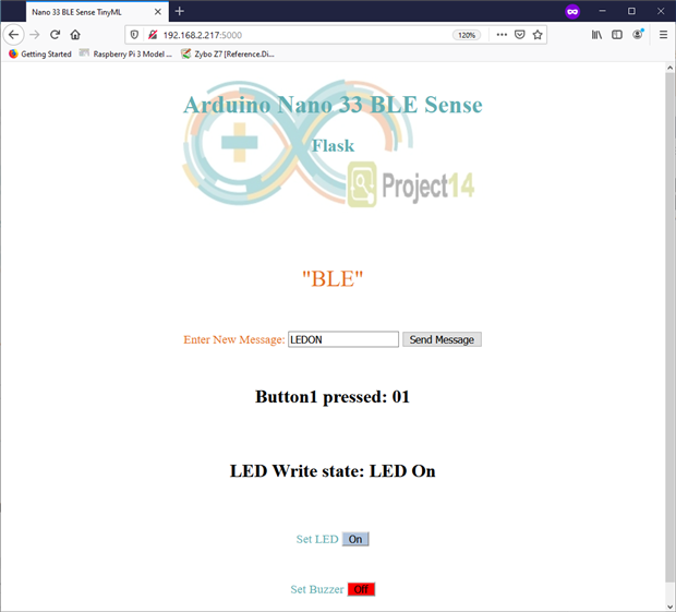

    5.  Reading a command from the HTML page and passing it through Flask to the Nano 33
@app.route('/nanoMsg', methods = ['POST'])
def show_nanoMsg():
    newNanoMsg = request.form['newMsg']
    print("Message received '" + newNanoMsg + "'")
    return ('nanoMsg', 204)
    6.  Readng a button press from the HTML page and sending a commands to the Nano 33 to turn on the LED
@app.route('/ledBtn', methods = ['POST'])
def set_ledBtn():
    ledState = request.form['ledState']
    if ledState == 'On':
        print ("LED ON")
        nano33.send_write_command("0x000b", '01')
    elif ledState == 'Off':
        print ("LED OFF")
        nano33.send_write_command("0x000b", '00')
    templateData = {
    7.  Read a button press from the Nano 33 and update the HTML page with the Button state.
@app.route('/nanoBTN1', methods = ['GET'])
def get_Btn1():
    print ("BTN1 value: ", btn1_output)
    templateData = {
    return render_template("index.html", btn1_output=btn1_output)
    8.  Start flask
$ python3 run.py
 * Serving Flask app "app" (lazy loading)
 * Environment: production
   WARNING: Do not use the development server in a production environment.
   Use a production WSGI server instead.
 * Debug mode: on
 * Running on http://0.0.0.0:5000/ (Press CTRL+C to quit)
 * Restarting with stat
 * Debugger is active!
 * Debugger PIN: 236-143-413
2020-04-23 21:48
HTML Webpage
   1.  The webpage code is placed in index.html under the templates folder.
<!DOCTYPE html>
<html lean="en" data-ng-app>
<head>
    <!-- define on/off styles -->
    <link rel= "stylesheet" type= "text/css" href= "{{ url_for('static', filename='css/style.css') }}">
    <!-- define the toggle function -->
    <script language="javascript">
        function toggleState(item) {
            if(item.className == "on") {
                item.className="off";
                item.value="Off";
            } else {
                item.className="on";
                item.value="On";
    </script>
    <meta charset="utf-8">
    <title>{{ title }}</title>
</head>
<body style="background-image: url({{ arduino_logo }})">
<body>
   <header>
      <p>
        <div>
          <h1>Arduino Nano 33 BLE Sense</h1>
           <h2> Flask </h2>
        </div>
      </p>
   </header>
      <p>
      <form action="/show_index" method="post" >
        <div>
          <!-- <img src="{{ tinyml_logo }}" alt="TinyML Logo" id="tinyml_logo" ></img> -->

    2.  Initial page shows the Input Box and buttons to interact with the Nano 22.
         NOTE: The Flask page can be reached using the Raspberry Pi IP address and Port 5000
    3. Send a LEDON Message to the Nano 33
    4.  Message seen from Flask
Message received 'LEDON'
Sending command: sudo gatttool -i hci0 -b D8:4C:FD:36:96:EB --char-write-req --handle=0x0013 --value=4c45444f4e
192.168.2.220 - - [23/Apr/2020 23:13:03] "POST /nanoMsg HTTP/1.1" 204 -
    5.  Message reported in the Arduino IDE Serial Monitor
String value:LEDON
    6.  Set Led Off via the Set LED Button
    7.  Button press reported by Flask:
LED OFF
Value returned: 00
Sending command: sudo gatttool -i hci0 -b D8:4C:FD:36:96:EB --char-write-req --handle=0x000b --value=00
192.168.2.220 - - [23/Apr/2020 23:17:38] "POST /ledBtn HTTP/1.1" 204 -
2020-04-23 23:17
    8.  Button press seen from Arduino IDE Serial Monitor
LED off
LED on
