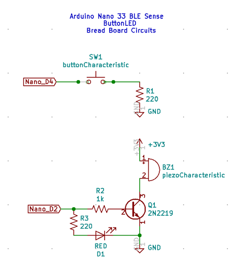

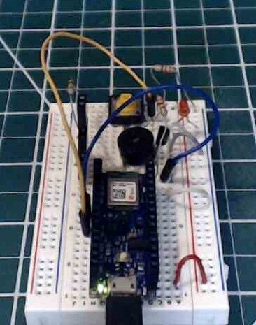

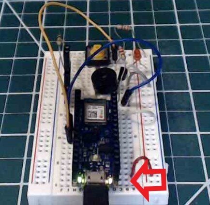

The Circuit
  • Connect the Button to Pin 4 of the Nano
  • Connect the Pizeo Buzzer to Pin 2 of the Nano
  • The On-board LED_BUILTIN

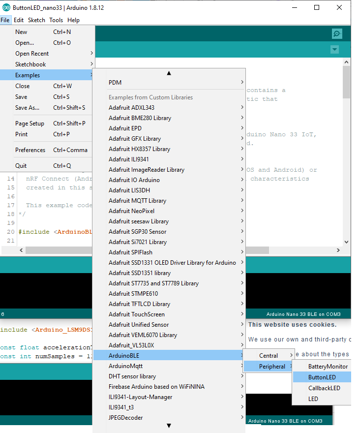

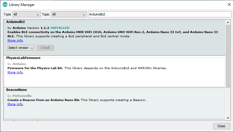

Prepare Arduino IDE
   1.  Install the ArduinoBLE Library
        https://www.arduino.cc/en/Reference/ArduinoBLE

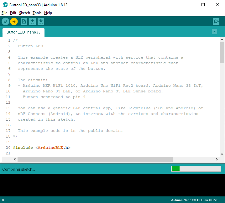

2.  The ArduinoBLE->Peripheral->ButtonLED example was used for this post.
3.  Compile and load the code to the Nano
       NOTE: An added Characteristic for a Piezo Buzzer was added for this post.

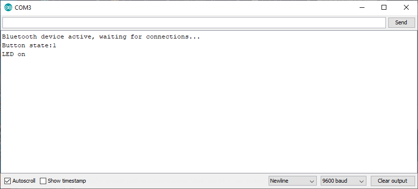

  1. From the Arduino IDE, open the Serial Monitor to enable the BLE radio.

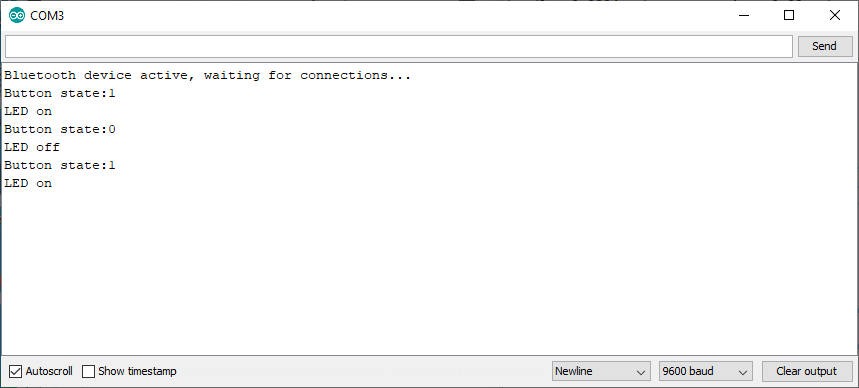

   6.  Read the Button state using handle 0x000e from step 5.
[D8:4C:FD:36:96:EB][LE]> char-read-hnd 0x000e
Characteristic value/descriptor: 01
   7.  Press the button connected to the Nano and read the value from bluez.
Characteristic value/descriptor: 00
   8. View the change of state from the Arduino IDE Serial Monitor

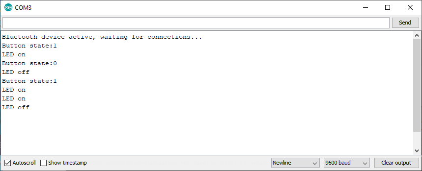

   6. Write '01' to handle 0x000b to enable the onboard LED.
[D8:4C:FD:36:96:EB][LE]> char-write-req 0x000b 01
Characteristic value was written successfully
   7. Write '00' to handle 0x000b to disable the LED.
[D8:4C:FD:36:96:EB][LE]> char-write-req 0x000b 00
   8. View the Serial Monitor for the LED state notices

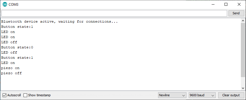

   9.  For the Buzzer, writing a '01' to handle 0x0011 will turn it on.
   10. Writing a '00' to handle 0x0011 will turn it off.

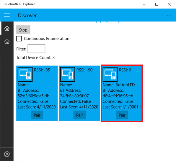

Attempt to connect using Windows 10 Bluetooth LE Explorer
  An attempt was made to connect to the Nano 33 BLE Sense using Windows, but the only semi successful app was the Bluetooth LE Explorer in that the app would not pair to the Nano.
Overall, the Nano 33 BLE Sense was easier to get working with BLE than something like the MKR WiFi 1010 and did not require a firmware upgrade to enable it.
