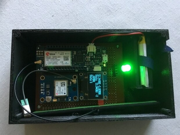

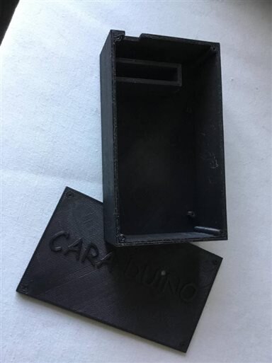

  • Enclosure

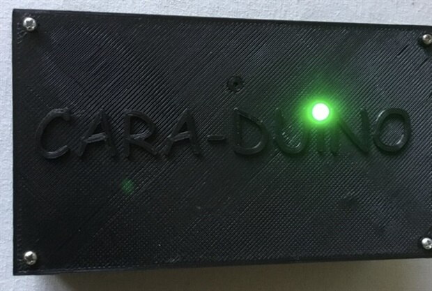

make a case
locate in caravan
test it still works.

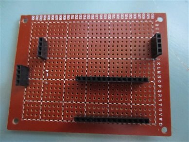

Parts added as afterthoughts

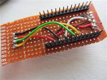

Perf board 90mm x 70mm
female headers
Oled display

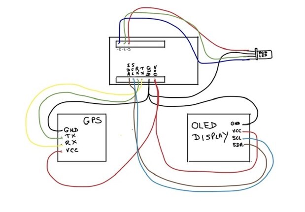

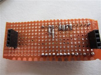

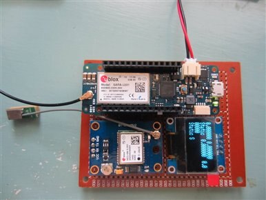

Connecting everything up
First insert the Sim Card.
Then connect the GPS. The GPS I am using has 4 pins VCC, GND, TX and RX.
Here is the connection diagram.

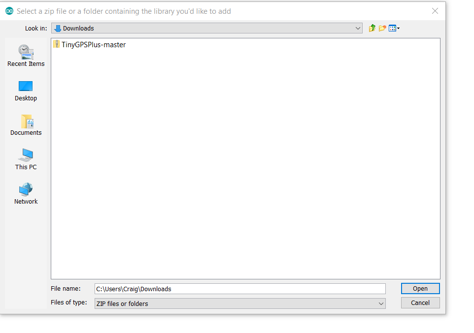

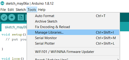

Loading Libraries
Before you can write the script you need to load the necessary libraries. I opted for the TinyGPSplus library which can be found on github here.
https://github.com/mikalhart/TinyGPSPlus

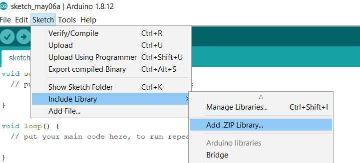

Download the zip file.
Then in Arduino IDE Sketch > Include Library > Add ZIP Library

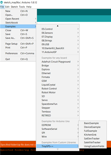

Find your download and click open
The library will be installed and you can check this by looking at the examples under the File menu

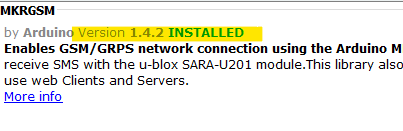

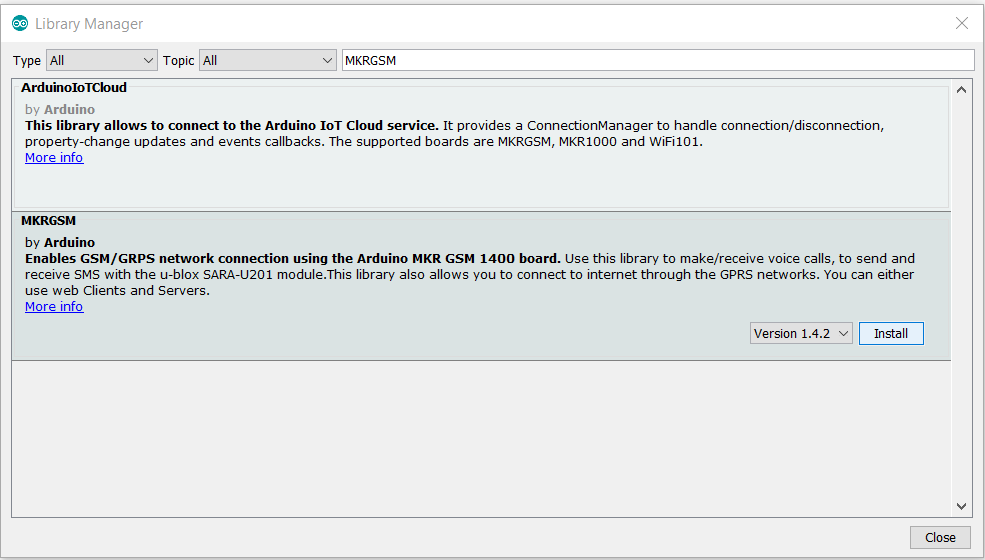

Next you need to install the GSM1400 libraries and this can be found under Tools>Manage Libraries..
Search for MKRGSM and click on install.
When it is finished the version number and INSTALLED will appear alongside the author.

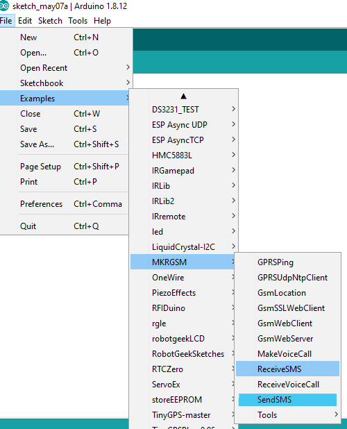

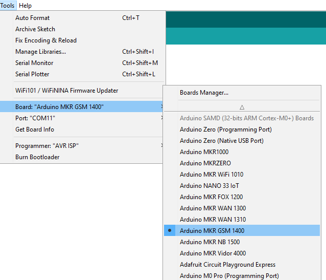

With the libraries installed select the board -
We now also have the sample sketches for MKR1400 available. I opened up and tested the sketches ReceiveSMS and SendSMS and they worked really well.
I also tested the TinyGPSplus BasicExample and this also worked well.
I stripped down the three samples and this formed the basis of my sketch which I have annotated as best I can. In some places I am aware the coding could be improved and I would appreciate any pointers to this end. I noticed that the latitude and longitude coordinates constantly fluctuate and I did some analysis of the values. I found that the values constantly change even if the gps isn't moving. So just storing the latitude and longitude then checking again later for a match wouldn't work. So I decided to store the latitude and longitude but only alert if either the latitude and longitude position changed by more than .0003.

With the sketch working I wanted to get away from the jumper cables and have something more stable. So I started work on attaching everything to a piece of perf board. First try wasn't very elegant
See photo.
As you can see it isn't pretty and also it needed solder both sides which is nigh on impossible.
This is my second attempt which I think is much better and it also includes the RGB LED as an status indicator..
Enclosure
So now I need an enclosure. I thought about disguising it as a Bluetooth speaker but in the end I want to hide the device out of sight if I can, so I opted for a plain box.
I drew it on FREECAD and printed it.
I have made the box bigger than required because I am thinking about how I could incorporate a pir so I have left enough room for whatever I come up with. I am hiding the OLED display under the lid (I will probably remove it and just leave the socket empty for future use as this will save energy). I realised that this would mean there was no visual indiction as to what was going on inside the box so I have made a hole in the lid to incorporate an LED. This means a slight change to the sketch and the circuit.
So the sketch change involved making the LED turn to red  while waiting for connection, Change to green once working and change to blue while in halt mode.
Here is the circuit board installed in the enclosure. One problem with my enclosure design is that the gap between the battery and the usb socket is too small and only one of my usb power supplies fits. I have redesigned the enclosure slightly larger but haven't had time to print it.
So this is it working
And finally it working in its enclosure
I have tested it in the car going shopping but because of the lockdown I haven't been able to go to the caravan to test it. So I don't know what kind of impact the caravan will have on the signals or where I will have to site it in the caravan to make it work.
I think it works quite nicely but time will tell.
