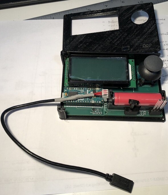

The attached charging cable is terminated with a female Micro-B USB jack.  I modified the PCB to remove the connection from the Arudino (lifted the in-line diode) and tacked a header to the pins attaching the power pack to the motherboard.

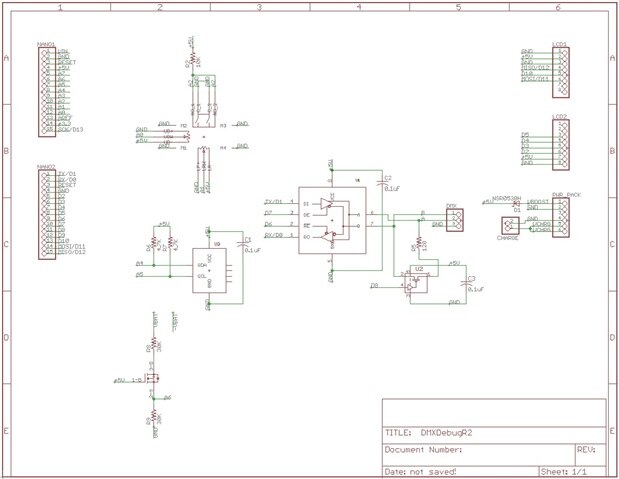

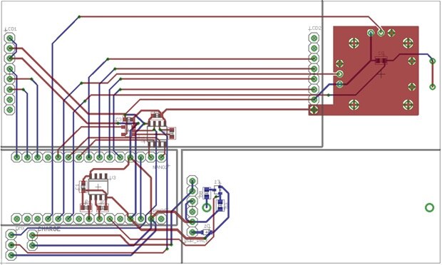

With all the changes on this relatively simple board, I decided that I should update the documentation.  This is how I should have built it:

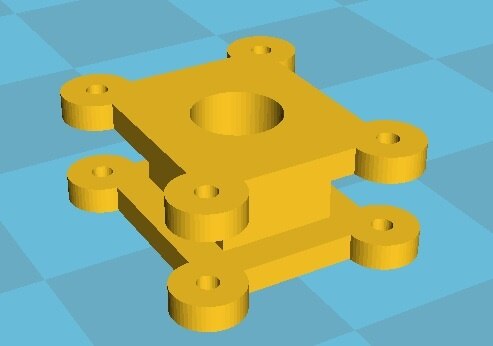

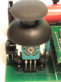

I had one additional part that I needed to fabricate, a riser for the joystick, positioning it at the proper height to be flush with the top panel.  As I went to find the Fusion360 drawing files today, I could not find any of my recent parts (I hope this is a temporary problem).  So I have included the *.STL file that I use to generate the gcode (in CURA).  Here is the CURA view of the joystick riser along with a picture of the built part:
