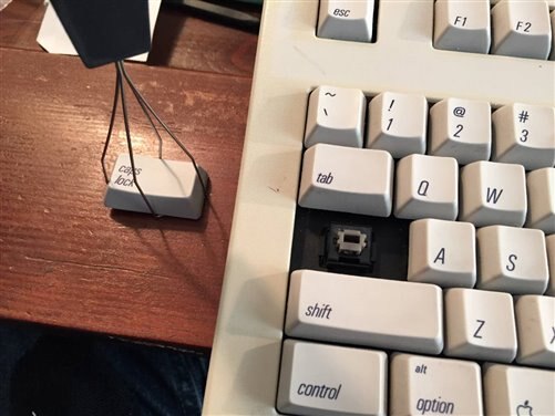

this projected has sincerely been evolved from Annoying 'CAPS' Lock Buzzer : Arduino Recipe
What about typing into your shell at lightning speeds and you accidentally pressed the vicious key?
What if, the key was pressed even before you started coding off?
What if you want to PRESS that key?
...you stand no chance(#challenge ), until the Arduino has been PLUGGED.

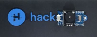

It only requires a plain old Arduino Pro Micro to make your own CAP!HACK
hence after, modifying some scripts within the IDE
CODE:
#include "HID-Project.h"
const int pin = 3;
void setup() {
  pinMode(pin, OUTPUT);
  // Sends a clean report to the host. This is important on any Arduino type.
  BootKeyboard.begin();
void loop() {
  // Update Led equal to the caps lock state.
  // Keep in mind that on a 16u2 and Arduino Micro HIGH and LOW for TX/RX Leds are inverted.
  if (BootKeyboard.getLeds() & LED_CAPS_LOCK)
    digitalWrite(pin, HIGH);
    BootKeyboard.write(KEY_CAPS_LOCK);
    delay(5); // 5usec; you may try to even lower that out for automated scripts..it Works!
  else
    digitalWrite(pin, LOW);
