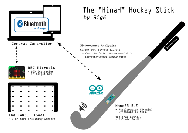

It is 23h00 and the mission requirements for the Hack in a Hurry ("HinaH") Hockey Stick project have now been flushed out.
The Arduino Nano 33 BLE board comes with a 9DOF motion and orientation-sensing LSM9DS1 SiP (system-in-package) from ST Microelectronics. The mission is to attach the Arduino Nano 33 BLE board to the hockey stick and use BLE to transmit the live motion sensing data (linear acceleration and angular motion) to a remote central controller. The purpose would then be to use this data to evaluate the hockey players technique when trying to hit a target with a hockey ball.
The small target area (or goal) will be monitored by a BBC microbit which will have at least 1 or 2 proximity sensors attached. These proximity sensor will determine the degree of accuracy (left or right of a plumb line) of the ball strike. The LED's on the BBC microbit will be used to provide user live feedback. The number of successful strikes and degree of accuracy data can then be related back to the central controller.

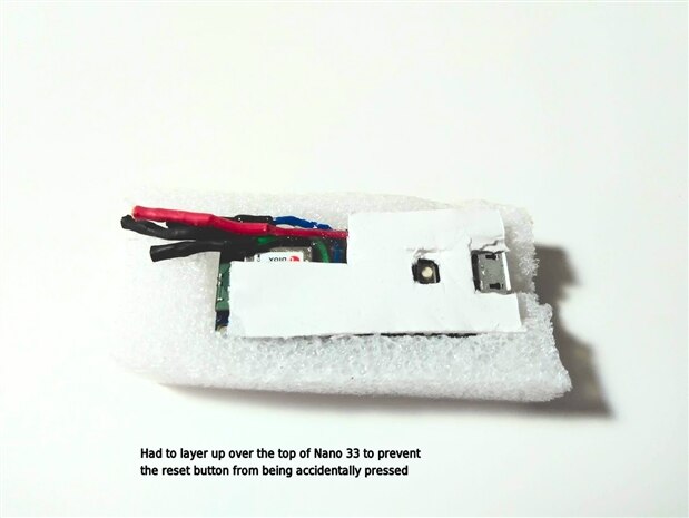

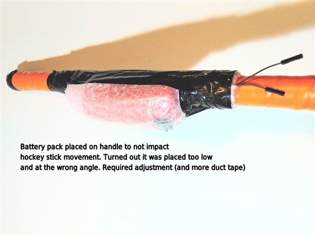

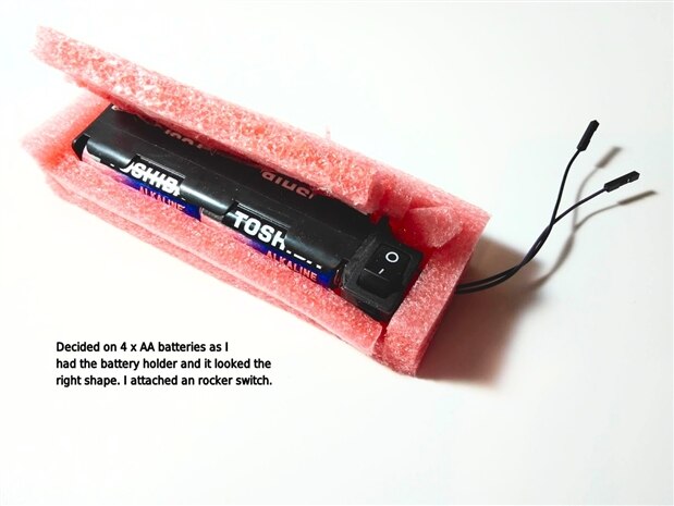

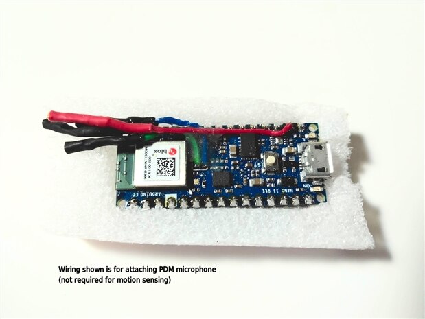

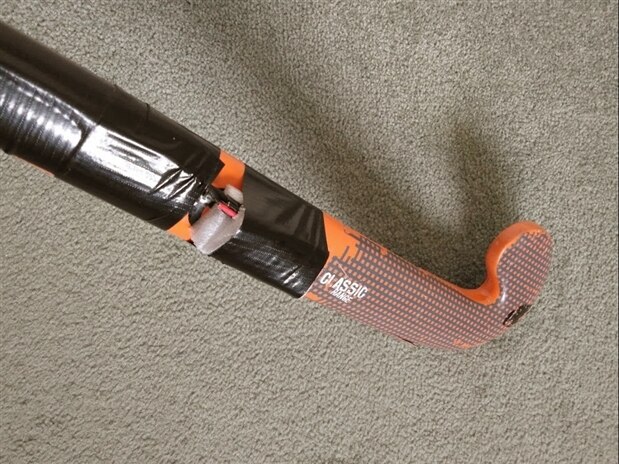

1. Kit out the hockey stick with battery pack and the Arduino Nano board.
2. Download the Arduino LSM9DS1 library and run through the examples.
3. Do some research on visual outputs for motion data (had seen some videos before using Processing for graphic output).
Completing step 1 did not take too long. I had plenty of packaging foam and duct tape lying around so I was good to go.
{gallery:autoplay=false} Arduino Nano 33 BLE on Hockey Stick

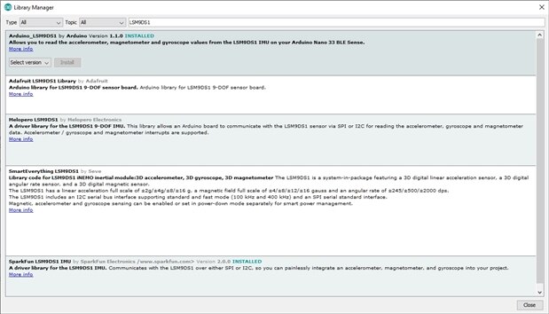

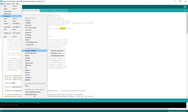

The Arduino IDE provides a very handy Library Manager tool. Typing in "LSM9DS1" gave me a list of options to choose from:
As you can see, I installed the Arduino version.
The curious thing I found, following the installation of the library, was where the LSM9DS1 examples are placed when you have the examples list open within the IDE. It took a bit of head scratching... only to find them right under my nose.

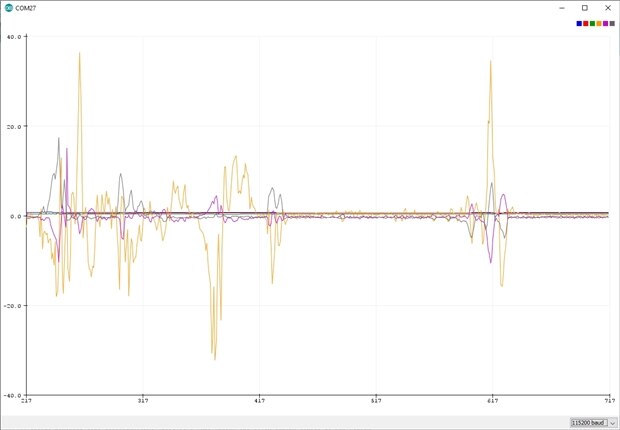

I combined the SimpleAccelerometer and SimpleGyroscope examples together and opened up the SerialPlotter tool to review my data. All looked good at face value.

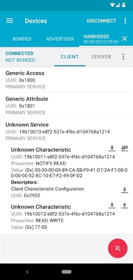

For my second sprint of the day, I decided to concentrate my efforts on the BLE side.
To create BLE Applications on the Arduino Nano 33 BLE board requires the ArduinoBLE library. This library is based off the BLEPeripheral library, which I was quite familiar with already.
My aim was to create a BLE peripheral application which had it's own custom service. I started with the "Button LED" example provided as this used a custom service and two custom characteristics too. All I had to do was modify the variable names to make them more meaningful and then change the properties to suit. The big change for my application was that I wanted to transmit a byte array for all my movement data. For this you have to define your characteristic slightly differently.
BLEService MovementService("19B10010-E8F2-537E-4F6C-D104768A1214");   // create our custom GATT service
// create movement data characteristic (this is a Byte Array) and allow remote device to use Notify
BLECharacteristic moveDataCharacteristic("19B10011-E8F2-537E-4F6C-D104768A1214", BLERead | BLENotify, 24, true);
// create acceleration & gyro sample rate (Hz) characteristic and allow remote device to get notifications
BLEShortCharacteristic SampleRateCharacteristic("19B10012-E8F2-537E-4F6C-D104768A1214", BLERead | BLEWrite);

I now was able to use my phone to connect with my Arduino Nano 33 BLE board and transmit a data array and inform the user of the sample rate. Here is a screenshot when using the nRFconnect app.

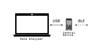

It is now lunchtime on Monday and I was thinking about how best to capture the BLE data using my laptop and decided to keep it within the Arduino family, so to speak, and use an ESP32 device as there is plenty of Arduino code examples about.
To create a BLE central device there is an ESP32 example called "bleclient.ino", which you can readily work off. The nice thing about this example is that you can get the ESP32 to scan and automatically connect with peripheral BLE devices that are advertising a particular service UUID. So, this is what I did. Then all you need to do is add in the GATT service and characteristics for my HinaH Hockey Stick nano 33 device and you are good to go. Well, sort of.
The ESP32 uses a notify callback function, but here you need to be careful not to overload this function with code as it very quickly gets snarled up and your ESP32 simply freezes. This happened to me a couple of times but once I had it cleaned up it seemed to work fine.

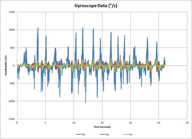

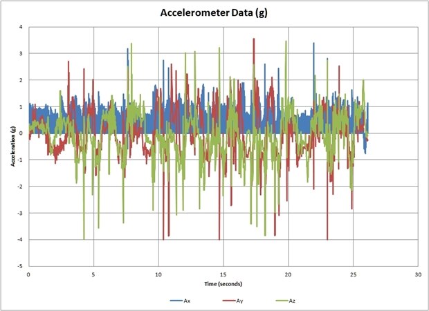

And finally, I got to do my first live test:
I then cut and pasted that serial monitor data into Excel and created two charts, one of Acceleration (g) and one for Angular Velocity (°/s).
{gallery} Movement Data
There was nothing untoward that I could see from the BLE data received. I was able to obtain 6DOF data updates every 0.01 seconds or so, which is pretty good in my opinion.
So I am rather pleased with the result and how short it took to get this far. The gadget goal device using the BBC microbit can wait for another day as the spotlight needs to remain on the Arduino Nano 33 BLE board. It is tiny and makes movement analysis quick and simple.
