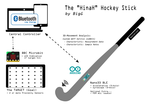

It is 21h00 on Saturday the 16th of May 2020 and I've decided to make a later entry with a project idea I hatched only 30 minutes ago. The reason is that I had read earlier today that the NanoRama competition deadline had been extended and it was only yesterday that I had given up in despair with my original project.
This time the plan is simple.  It starts with a hockey stick...
Then prove that you can really rapid prototype with an Arduino Nano 33 BLE board within 48 hours.
So, much like the popular TV series 24, I've got 24 hours to update my progress.
To be continued...
The mission
It is 23h00 and the mission requirements for the Hack in a Hurry ("HinaH") Hockey Stick project have now been flushed out.
The Arduino Nano 33 BLE board comes with a 9DOF motion and orientation-sensing LSM9DS1 SiP (system-in-package) from ST Microelectronics. The mission is to attach the Arduino Nano 33 BLE board to the hockey stick and use BLE to transmit the live motion sensing data (linear acceleration and angular motion) to a remote central controller. The purpose would then be to use this data to evaluate the hockey players technique when trying to hit a target with a hockey ball.
The small target area (or goal) will be monitored by a BBC microbit which will have at least 1 or 2 proximity sensors attached. These proximity sensor will determine the degree of accuracy (left or right of a plumb line) of the ball strike. The LED's on the BBC microbit will be used to provide user live feedback. The number of successful strikes and degree of accuracy data can then be related back to the central controller.
