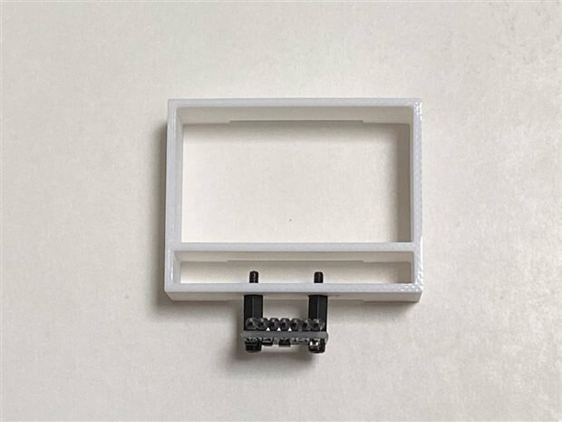

The next step in my project is to print a mounting fixture for the micro-LIDAR TOF sensor.  I wanted to position the sensor lens in approximately the same plane as the laser lens.  Any small discrepancies will be corrected when I calibrate the offset.

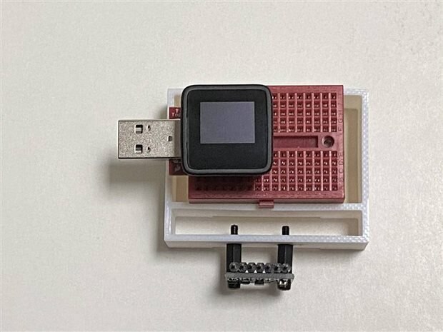

The shroud has a press fix onto the spindle/laser mount.  The lower shelf holds the VL6180X and I picked standoffs of the appropriate length to adjust the sensor lens position.

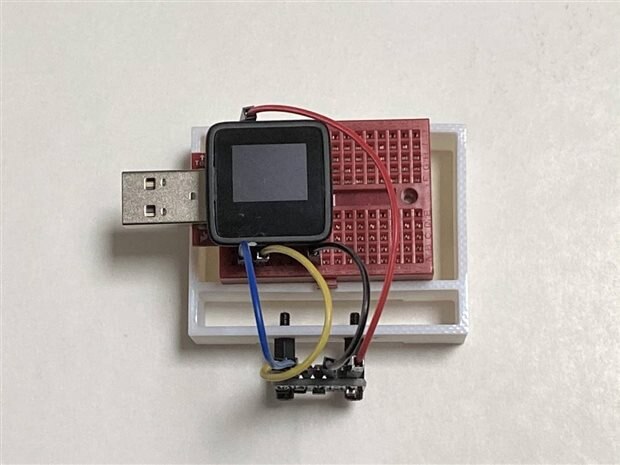

While I am prototyping I am just going to mount the solderless breadboard into the upper cavity.  This allows me to continue using the USB programmer.
The assembly with sensor connections.

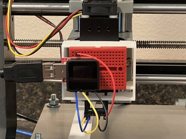

Mounted on the spindle/laser holder.
When I am done testing I will remove the USB programmer and mount the MicroView in a socket on a small proto PCB.  I'll wire the power and ground from the GRBL controller.  I also need to add the wire to the z-limit input of the GRBL controller.
The next step is to do the performance testing with the VL6180X using the averaging program.  I decided to combine a few of the steps from the previous blog and just do all the integration/testing on the cnc/laser machine as I'll need to get wired to the GRBL controller and it's probably better to do the testing in the use environment.

    This method doesn't have the accuracy/repeatability required for 3D printing or CNC.  I find that I adjust my bed infrequently when 3D printing and for CNC the tool variations require me to manually adjust.  The laser is a lot more forgiving in focus tolerance and I need to refocus frequently whenever I change material thickness (anywhere from thin cardstock up to about 1/2").  So I'm hoping that this will work for the laser.
