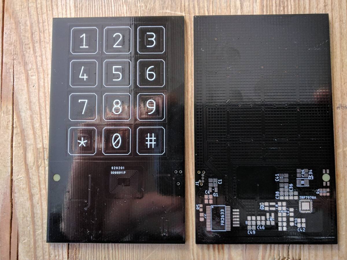

Recently I started work on a new board. This one will be a front door entry system, so I decided to go with something that could read my NFC implant but also had a numeric keypad for the kids (and anyone else) to use. Not everyone wants to be chipped. Crazy, isn't it? I'll write more up on the board when it gets closer to completion, but for this post I'm going to concentrate on a small PCB antenna that's intended for use with a tiny implanted tag. I've successfully used a wirewound inductor before, but I decided it was time to try a PCB trace antenna. This is the most common way to make an NFC reader, but nobody seems to have tried to tune one for an implant - probably because it means it will be worse at reading larger tags. Anyway, this is about creating a small PCB antenna and more importantly tuning it so that it read well.
So, this is the PCB. It's based around a MSP430FR2633 for it's great capacitive sensing for the buttons. There is also a TRF7970A NFC transceiver as I'm familiar with this. You may also notice that I've gone for a reverse mount RGB LED that shines through that unmasked piece of the board. I'm really pleased with how that looks. Check out this video of the buttons in action to see if you agree.

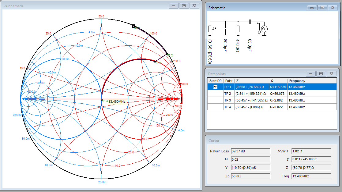

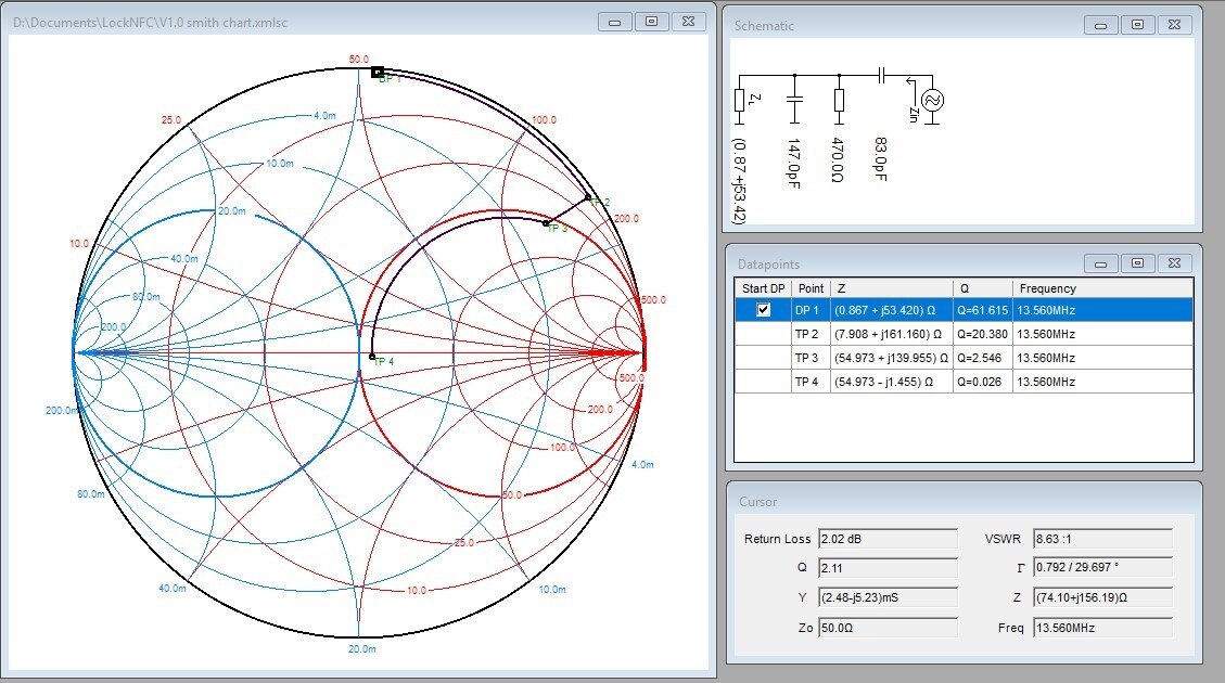

So it turns out that the PCB trace I expected to be about 1μH turned out to be 0.627μH with a resistance of 0.867Ω - otherwise expressed as 0.867 + j53.42Ω. The article suggested a parallel resistor of 362Ω so i went with the closest I had of 470Ω. Calculating the parallel and series capacitances seemed trickier. I ended up using some Smith Chart software from Fritz Dellsperger. and to be honest I sort of went with trial, error and adjustment to try to get the final point as near to 50Ω as possible. I managed a theoretical 54.973 - j1.455Ω
I approximated the parallel  capacitance to 100pF + 47pF = 147pF and the serial to 68pF + 15pF = 83pF. With the measured value of my PCB trace and the matching components I had it had previously been 8.847-j135Ω. No wonder it wasn't great!

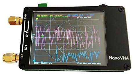

I had a bit more antenna work to do and had heard good things about the NanoVNA - a $50 (or less) budget VNA. This VNA may be a bit limited compared to a "proper" VNA, but does an excellent job at 13.56MHz for NFC antenna tuning. I simply followed this helpful guide to using the nanoVNA and downloaded the NanoVNA Saver software it recommends.
https://hexandflex.com/2019/08/31/getting-started-with-the-nanovna-part-1/

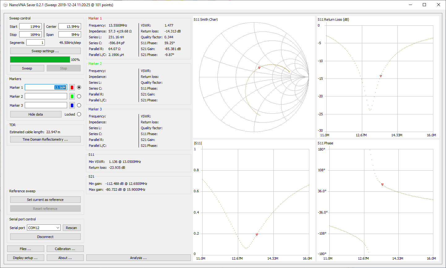

Tuning a different antenna - and seeing where the theoretical values can be tweaked in practice - was very easy. This is the antenna when I used the theoretical values from the Smith chart simulation. The tuned frequency is about 500kHz too low. (The antenna still worked OK.)

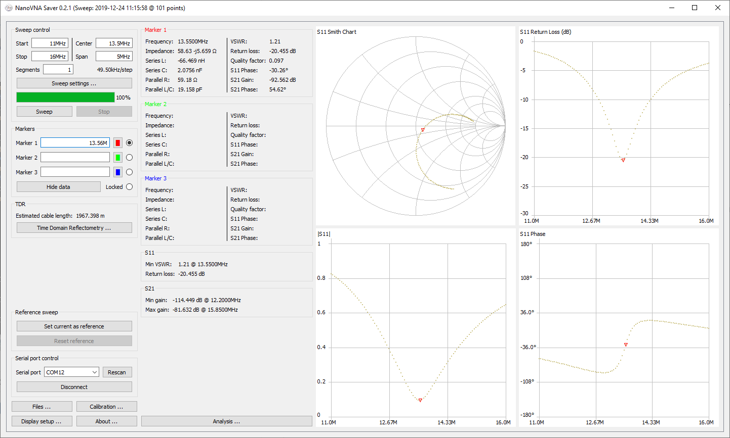

And this is an improved version where I reduced the series capacitance to see what happened. I managed to move the tuned frequency much closer to 13.56MHz.
I would definitely recommend the NanoVNA for NFC antenna matching.
