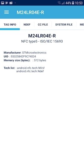

The M24LR is according to ISO 15693 so it is a Type 5 Tag (NFC-V compliant) or T5T.

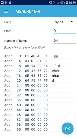

Now I show the content of a NFC tag with one NDEF Message containing one NDEF Text Record.
This is the whole content in hex bytes:
E1 40 40 01 03 0F D1 01 0B 54 02 64 65 42 65 72 6E 68 61 72 64 FE
The rest of the eeprom is filled with 0x00 or 0xFF. But this doesn't matter.
CC
NDEF Message
TLV Block
NDEF RecordPayloadDescription
E1Magic number, shows that the content is NDEF formatted. Always 0xE1
40
Version and access condition
Bit 7 and 6: major version
Bit 5 and 4: minor version
Bit 3 and 2: Read access: 0=always, 1=RFU, 2=proprietary, 3=RFU
Bit 1 and 0: Write access: 0=always, 1=RFU, 2=proprietary, 3=Never
so in this case: Version 1.0, read access always, write access always
40
MLEN - memory length
multiply this value by eight to get the memory size.
0x40 x 8 = 64 x 8 = 512 bytes
01
additional feature information
This byte is usually set to 0x01
03
TLV Block tag field
0x03=NDEF message
0F
length of the NDEF message
0x0F = 15 bytes
D1
Record header
0xD1= Well-Known Record, SR=1 (length stored in 1 byte), ME=1 (last record in NDEF message), MB=1 (first record in NDEF message)
01length of record type field
0B
payload length
0B = 11 Bytes
54
Record Type
0x54=Text Record
02encoding (UTF8) and length of language code (2 bytes)
64 65
language code
"de"
Text string
"Bernhard"
FETerminator - Last TLV block
The NDEF tag could also contain more NDEF messages or more NDEF Records. I hope the structure is now clear and additional records can be decoded using the links provided.

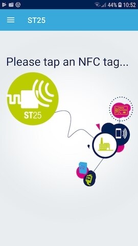

ST25 NFC Tap app
ST25 proposes to use its ST25 NFC Tap app to programm the M24LR. The app is available in the Google Play store: https://play.google.com/store/apps/details?id=com.st.st25nfc&hl=en_US
After startup the app shows this screen and wants you place a NFC tag near the reader.
When the M24LR si placed under the reader the app shows information on this device.

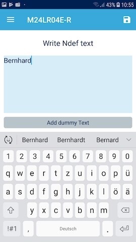

In the NDEF tab the previous described Text Record can be created.
The app can also show the content of the tag / eeprom just like it was described before
These screenshots show how the ST25 NFC Tap app allows to manipulate the M24LR. I suppose this is also possible with any app that allows to manipulate Type 5 Tags.
