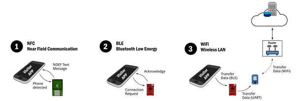

Let me now unpack what was shown in the video.

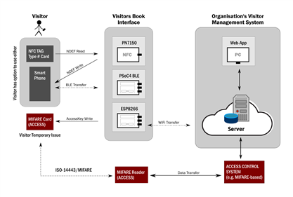

I will start with the electronic Visitor Book Interface, as shown in the system architecture diagram, which I referred to in the video as the Visitor “box”.

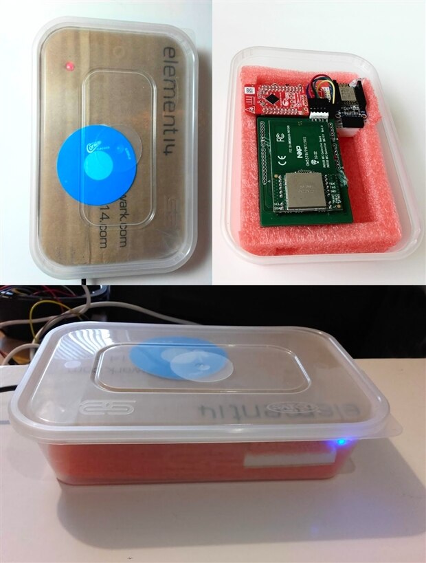

As mentioned in blog 1, the visitor’s box is made up of 3 development modules, namely the PN7150 controller, the PSoC 4 M0 / BLE module and the ESP8266 WiFi module.
I also noted in blog 1 that there was no real added value to push the three development modules inside a box and had planned to leave as is, but then it was actually tidier to have them in a box and it would allow me to evaluate the visuals using just a RGB LED as the user interface and a blue LED for connectivity status, hence it is now inside a semi-sealed plastic enclosure.

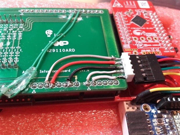

So, here is what I ended up with:
{gallery:autoplay=false} Visitor Book Interface

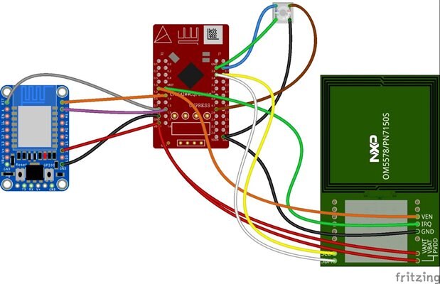

The Visitor's "box" is powered via USB (5V) through the PSoC 4 BLE Pioneer Baseboard.
I hacked the PN7150 Arduino shield to add in a UART interface for the ESP8266. It was rather fortunate that the 2nd PSoC 4 UART block pins were located just where I needed them. The PSoC 4 and the ESP8266 reset pins were connected to ensure a sequenced reboot.

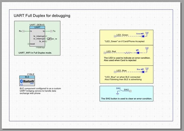

There are 2 serial (UART) connections. One is for the serial monitor to view debugging information and the other is to handle serial communication with the ESP8266.

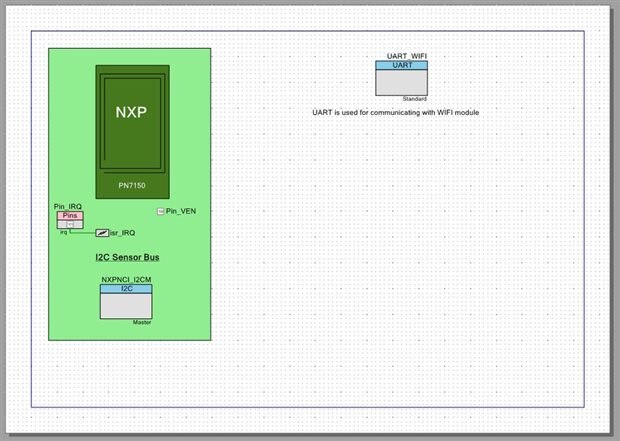

Here is the top-level design view:
{gallery:autoplay=false} PSoC Top Level Design
The firmware for the BLE module is configured as a peripheral server and makes use of a single custom GATT service with a single service characteristic to handle the data transfer between the central client device, i.e. the phone, and the module. The BLE functionality is only triggered when it detects a P2P event and has transferred a simple NDEF text message, which contains the BLE name and part of the 128-bit service UUID. The reason for doing it this way, rather than the NDEF format that allows for the transfer of BLE device information, is that I was using MIT App Inventor to develop the phone app and the NFC block available only does a NDEF text read. I always have the option to modify the App Inventor code for the NFC block as it is open source when I find the time, but I'm happy with the keep it simple approach as it works for me.

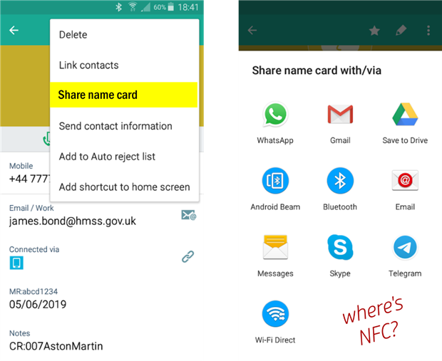

With smart phones, such as those using Android OS, there is also a range of options available to allow you to share your contact details... as shown below. But where is NFC, you may ask? Well, it’s there under disguise... but we won’t be using that method (directly) anyway.
It’s called Android Beam. Here is a quick summary of what it's about.
Android Beam was introduced in 2011 with Android version 4.0 (Ice Cream Sandwich).
According to https://developer.android.com/about/versions/android-4.0-highlights.html, Android Beam uses NFC to pair your devices over Bluetooth, then transfers files over the Bluetooth connection. It can also transfer very small pieces of data (contacts, links, etc) directly over NFC. For larger payloads, developers can even use Android Beam to initiate a connection and transfer the data over Bluetooth, without the need for user-visible pairing.
However, by 2017, ComputerWorld included Android Beam in a list of "once-trumpeted features that quietly faded away", observing that "despite the admirable marketing effort, Beam never quite worked particularly well, and numerous other systems for sharing stuff proved to be simpler and more reliable. https://en.wikipedia.org/wiki/Android_Beam
And in May 2019, it was announced that Android Beam will be discontinued in Android Q and is not present in the second Android Q beta for the Google Pixel 3.
More on Android Beam later.

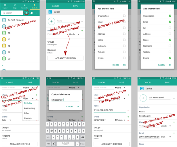

Now, let’s look at what is possible via the phone’s contact list.
So, hopefully you spotted in the screenshot gallery that the data fields missing from the array of standard options are car registration and a meeting reference, or who you are visiting.
Nevertheless, with a bit of creative thinking we can add these in by tweaking what’s available.
For example we can use “Events” to provide a meeting date and create a “custom event” where we use the meeting reference as the custom event name. Or we can use “Notes” as another option to store car reg details as well as meeting reference.
Unfortunately, this method would not really cut it in the real world. Firstly, there is the problem of getting this methodology adopted and used by all. Then for each meeting you would have to remember to manually change the meeting reference to reflect the new meeting etc. Then there is the problem of transferring this information across.

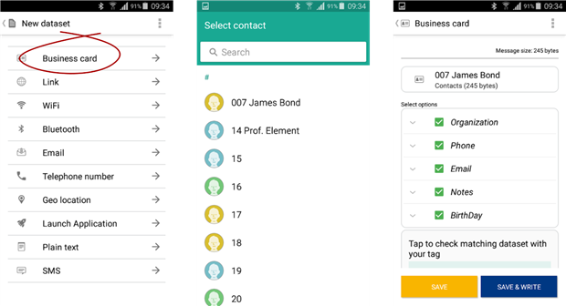

This is where NXP’s free App, NFC Writer comes in handy. I already mentioned this app in blog 1, where I showed how to use the app to provision WiFi. The same process can be used here.
Then when we are ready to transfer this information we click SAVE & WRITE and we can use our phone to write these details onto an NFC Tag Card, such as this one.
And that is it. We have a contactless card that can be used to transfer business card information to our electronic visitor book.

Option 2: Using NFC and Bluetooth LE to transfer Business Card details via a custom Android phone app.
Back to Android Beam. It was through my travails getting my own phone App to work that I discovered that Android Beam is still alive and kicking on my phone, which I found out needs to be turned on for peer-to-peer mode. So, Android Beam did me a huge favour by demonstrating the process of switching to Bluetooth to transmit large data sets actually works technically, as this was the process I intended to use for my phone app. Once again, others have thought of this process first.
As can be seen in the diagram above, the data transfer process involves three steps.
The first, is NFC where an NDEF text message is exchange containing BLE connection information.
The second is BLE where the app connects to the PSoc 4 BLE module via a custom GATT service. This allows the user to move more freely about and provide time to input their contacts or grab the details from a contacts list (as shown in the demo video) or restore saved data via the app. When the user is ready they then click a button to transfer this information across Bluetooth LE.
The third part of the process is really a bridging method of taking the information received and sending this in a suitable format to the cloud server. This uses WiFi communication.

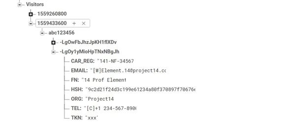

For this project, Google's Firebase was used as the cloud-based back office platform. The beauty of Firebase in this case is that it is free to use for developing prototype apps and the way it is structured means that I actually do not need any server based code. The Firebase platform handles everything for me.
The realtime Firebase database is NoSQL type database. As such it lends itself very well to JSON. So all my code does is send a JSON string with the visitors information and this arrives in the Firebase database:
The final process in the Visitor Sign-In process is providing the visitor with a provisioned access card. Here I was using a MIFARE card for demo purposes.
