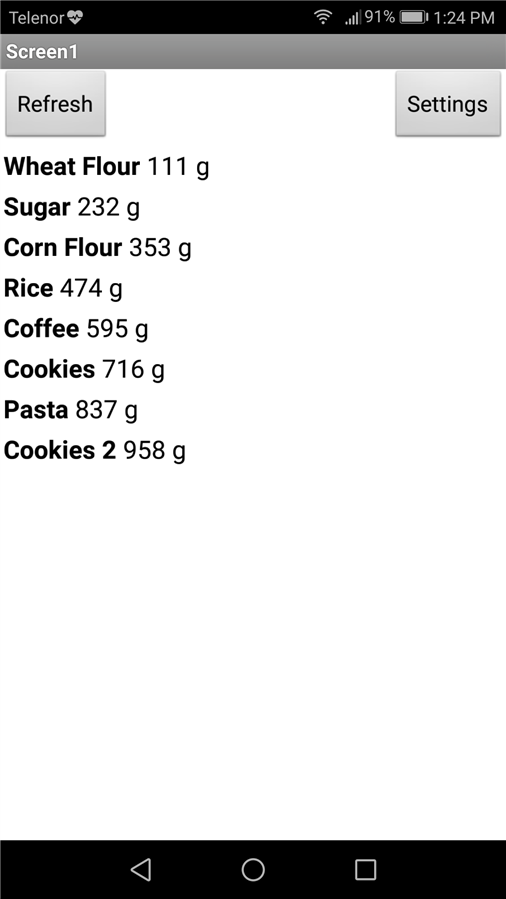

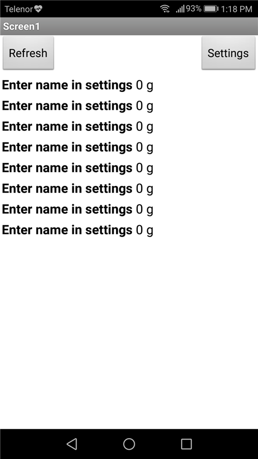

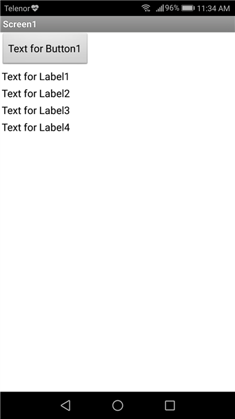

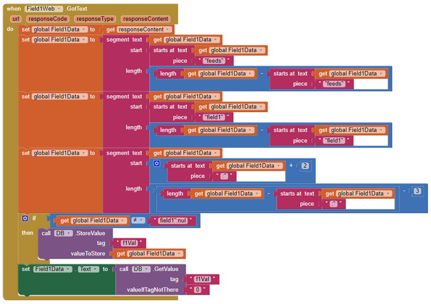

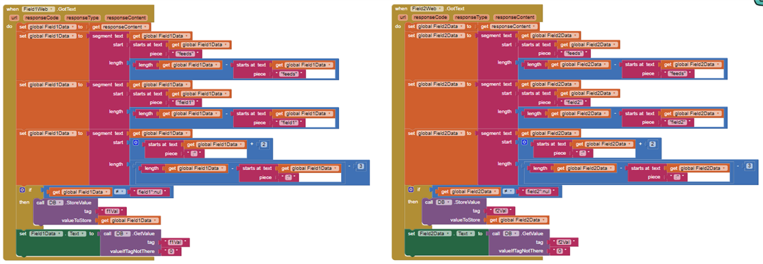

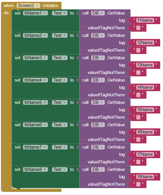

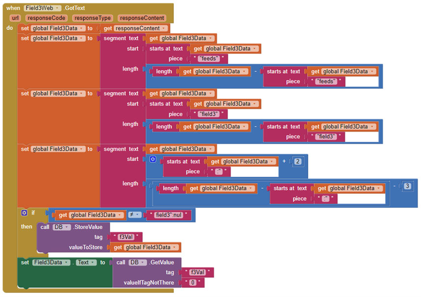

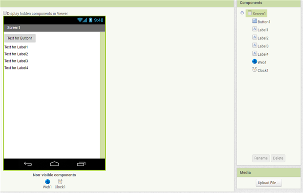

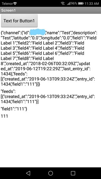

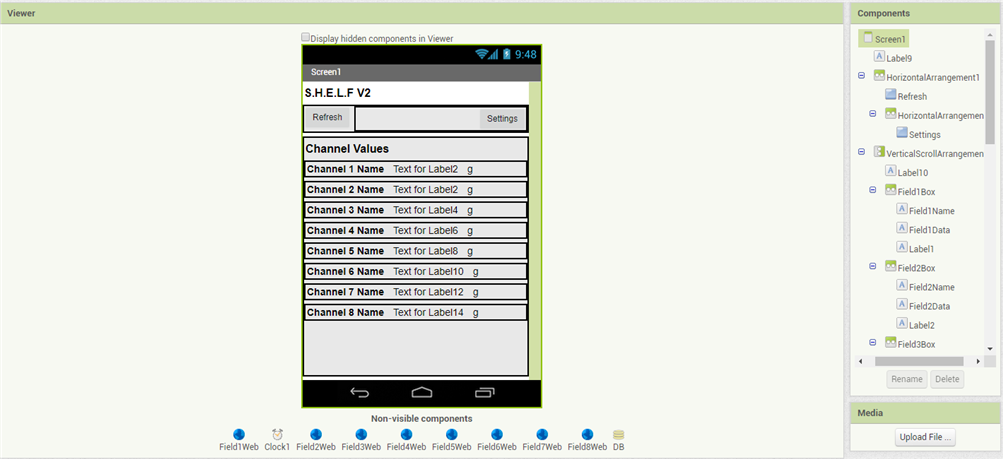

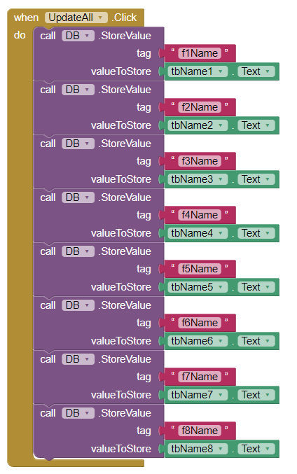

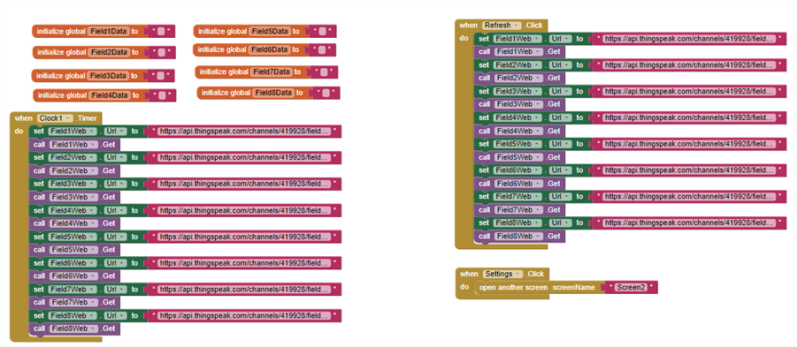

  • 4. Android App

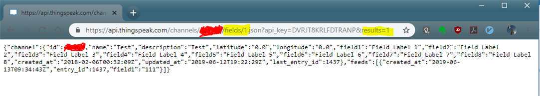

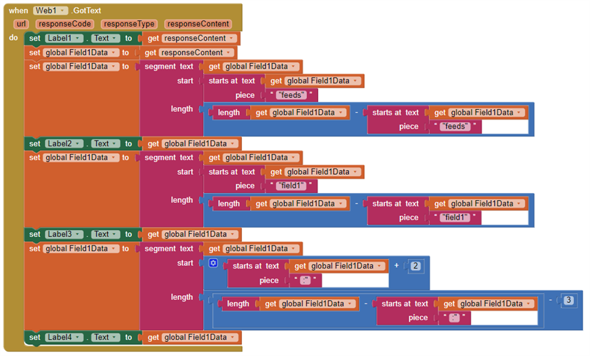

    • Extracting data from ThingSpeak

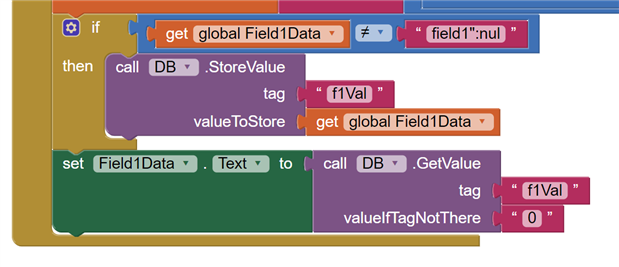

    • Complete App V1

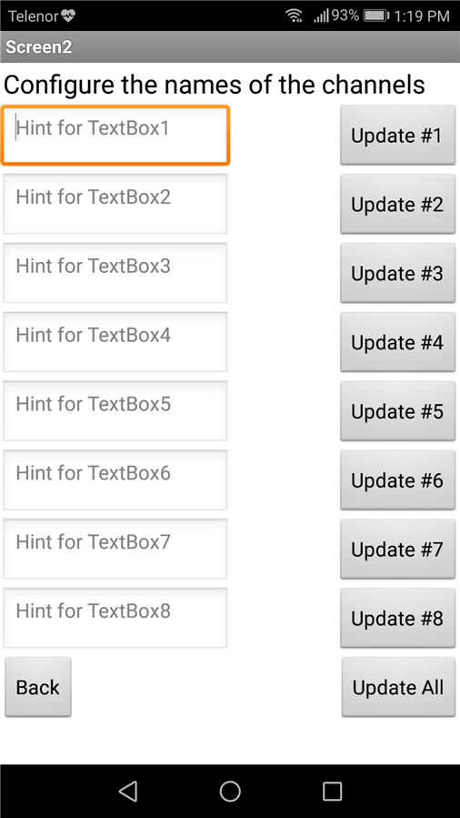

      • Screen1
      • Screen2
      • Test

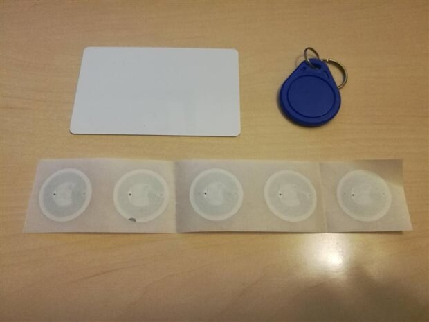

     For the V2 simply said, the plan is to use RFID stickers and RFID tags to identify the containers/items on the Last time as the brain I used a Raspberry, this time, I will be switching to an Arduino Mega 2560 and an ESP8266-07. I don't need the image processing which I needed in V1 so I can with something which is much lower powered, but which will be easier to develop, and easier to interface with all of the sensors. The ESP8266-07 will be used to upload data online so I can later access it using my phone. Last time I used a third party app which showed the value, but didn't have the interface I wanted, so this time I will be making a simple Android app which can read data from ThingSpeak (at least for now I will be sticking with ThingSpeak, since I really don't know that much about that sphere and this is the easiest route for me to establish communication between the Arduino and my phone).
How will it work?

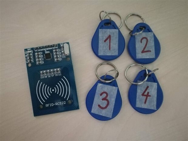

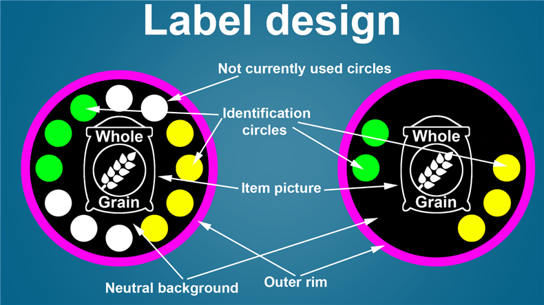

  • I want to use 2 RC522 RFID modules, one in vertical position and the other one in horizontal, this is because I plan on putting some tags on the side and some of the bottom of items
  • I'll find a couple of containers which will have the sticker on them permanently, while I will attach tags with elastic string for example, to things like bottles where the packaging gets thrown away after using it
  • The shelf will be used by picking off the shelf or placing on the shelf item by item, where all you need to do is go over the scanner
    • The stickers can be found really cheap (as low as 10 cents a piece if you buy 100 of them in pack), and I was afraid that the scanner won't read them fast, but it turns out it reads incredibly fast

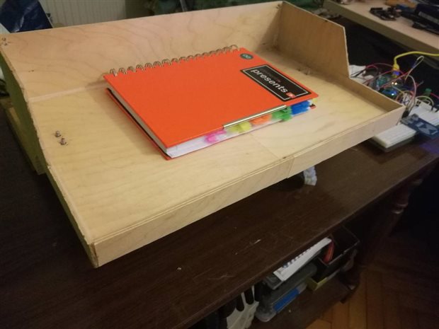

  • As for the design itself, I actually found V1 so I will be using the same piece as well as the same sensors, since they gave really accurate results last time

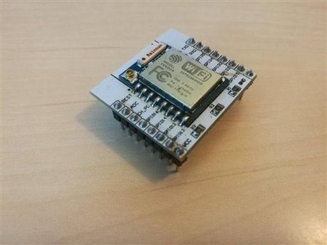

ESP8266-07 Module
     This is the module I will be using for connecting to the internet. It's small, runs on 3.3V and it's pretty easy to program. It supports serial communication (Rx & Tx pins) which I will be using to get the data from the Arduino, and upload it over to ThingSpeak. To test everything out, I made a test channel on ThingSpeak and wanted to try uploading some data, I decided just to try and upload random numbers.
Connection for the ESP8266-07
All of the ESP8266 boards I've seen run on 3.3V, be sure to check that, because the board can easily be fried when connected to 5V
     There are 2 ways I considered for programming the ESP8266, either using an Arduino Uno, removing the AtMega328 from it and using the board as a programmer or going with a USB to Serial converter, in the end I went with the converter. As for how to connect the pins from ESP8266 this is how it should be done:
  • +3.3V to VCC
  • GND to GND
  • Tx on the board to Rx on the converter/Arduino Uno board
  • Rx on board to Tx on the converter/Arduino Uno board
  • CH_PD (CH_PC)  to VCC/3.3V
  • GPIO0 on the board to GND
  • GPIO15 on the board to GND

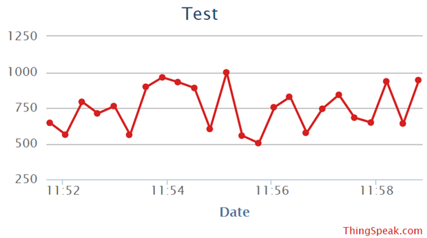

Uploading to ThingSpeak
     For the code itself, there are a lot of great tutorials online on uploading data to ThingSpeak, I tried a couple, and will be showing the option I found to be the easiest for me.
#include <ESP8266WiFi.h>
#include <WiFiClient.h>
#include <ESP8266WebServer.h>
//WiFi Settings
const char *ssid = "Put your SSID here";
const char *password = "Put your Password here";
//Site Settings
const char *host = "api.thingspeak.com";
String apiKey = "Your ThingSpeak Write Key Here";
const int port = 80;
String link, data;
void setup() {
    Serial.begin(9600);
    WiFi.mode(WIFI_STA);
    WiFi.begin(ssid, password); //Connecting to WiFi
    //With this while loop we are waiting for a connection
    while (WiFi.status() != WL_CONNECTED) {
      delay(500);
      Serial.print(".");
    //Writing to Serial when we connect to WiFi
    Serial.println("");
    Serial.println("");
    Serial.println("");
    Serial.print("Connected to ");
    Serial.println(ssid);
    Serial.print("IP address: ");
    Serial.println(WiFi.localIP());
void loop() {
    WiFiClient client;
    if(!client.connect(host, port)){
        Serial.println("Connection Failed");
        delay(500);
        return;
    data = String(random(500)+500); //Generating a random number
    link = "GET /update?api_key="+apiKey+"&field1="; //If we want to write to other fields we just have to change field1 to field2 etc
    link = link + data;
    link = link + " HTTP/1.1\r\n" + "Host: " + host + "\r\n" + "Connection: close\r\n\r\n";
    client.print(link);
    delay(6000);
     This code should be uploading a random number between 500 and 1000 to my channel field 1 every 6 seconds. For this version of the project all I need is one way communication, uploading the data to ThingSpeak, which I will then fetch using an Android app. Here is how the ThingSpeak Side looks now:
     For uploading to other fields in the channel all we have to do is change where is says field1 in the code to field2, field3 and so on. The free ThingSpeak account allows 4 channels and 8 fields per channel, for testing purposes I will be sticking to on channel and 8 fields. Adding more wouldn't be a problem by simply adding another apiKey for the second channel and so on. All that's left to do with ESP8266 now is configure it to talk to the Arduino and depending on the data sent from the Arduino upload a certain value to a specific field.

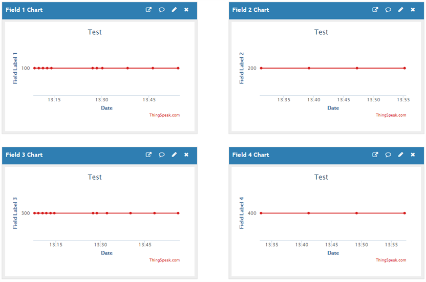

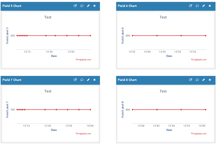

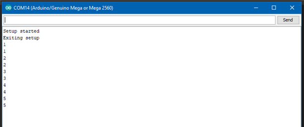

First Serial Test
     For the first Serial communication test, all I want to do is establish a communication between the ESP8266-07 and Arduino Mega 2560 and decode the data and upload it then to ThingSpeak. Since I will be only uploading integer values to ThingSpeak the way I'll be coding everything gets very simple. As the last digit of every message I send from the Arduino will be the field number and the rest will be the information that we want to upload. In other words to get the field to which I want to upload, all we have to do is get the modulo (field = data % 10), while we will get the data as data/10 (whole number division). Here are the codes I used

     To be sure it works ok, I put a delay of 1 minute between sending the data. My first test was with 10 seconds between sending the messages. There are some limitations to ThingSpeak where it is blocking some requests if they are too frequent, so I had a problem of only every second request going through. For the purposes of this project I really don't need any high speed communication. Here are the ThingSpeak charts.
This system is working without any problems, I will play around with different delays a bit more, to see what works and what doesn't but the main part when it comes to the ESP8266-07 is complete with this. For the internet part all that is left to do is make an Android app which I will cover a bit later in this blog, time to focus on the scale sensors now!

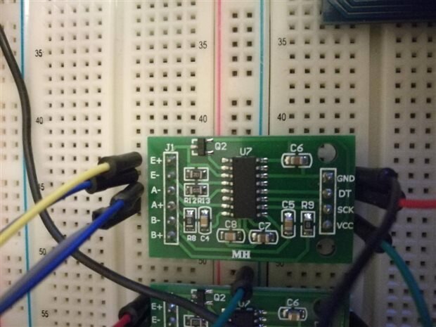

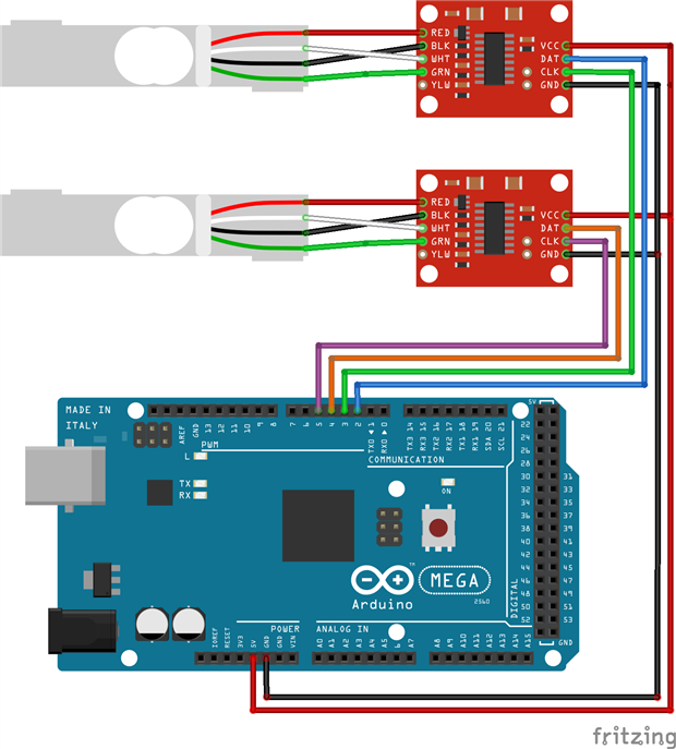

     For measuring the weight of the items on the shelf I'll be using 2 load cells and 2 amplifiers. While the amplifiers I have can both handle 2 cells each, last time I was working with these load cells I found it worked much better when using 2 amplifiers, and it's also a bit easier to do. To use the cells with the Arduino, I downloaded the HX711 library from here https://github.com/bogde/HX711 . The library has some great examples to get started with the cells and it's also explained how to calibrate the load cells. This is how I've connected the cells to the Arduino:
Connection and Code
The board I have doesn't have the pins exactly labeled as the one I used in the schematic, but the connections go like this:
  • Red (Load Cell) --- E+ (HX711)
  • Black (Load Cell) --- E- (HX711)
  • Green (Load Cell) --- A- (HX711)
  • White (Load Cell) --- A+ (HX711)
The code with the library I am using is incredibly simple, I went through the examples and extracted the things I needed from them and added other stuff that I needed, and ended up with this:

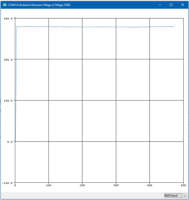

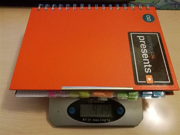

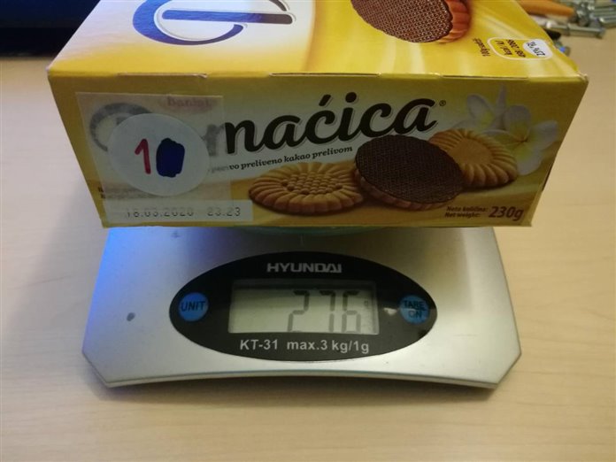

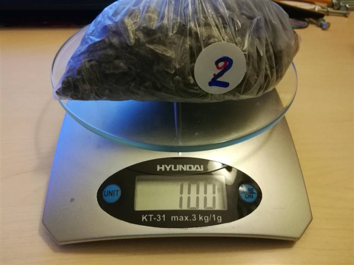

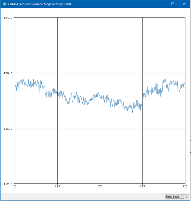

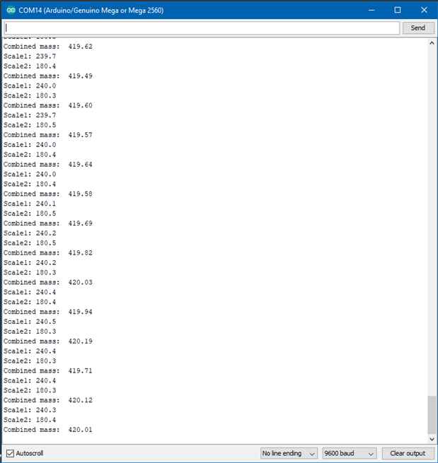

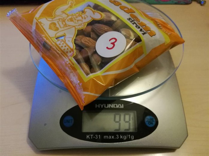

Testing
{gallery} Load Cell Testing
Test Bench: My build from SHELF V1 that I am using again
Reference Scale: The weight of my notebook is around 419g measured on a standard kitchen scale
First Results: And here we have the results from the load cells, I am extremely happy with the values I'm getting
Plot1: I let the code run for a bit, here is how the values look like
Plot 2: Here is the same plot when it scales down the value we are looking at, while it's not perfectly consistent, for what I'm planning to use it for, it will work great, since the peak to peak is less than 4g
     One thing that can always be improved are the scale calibration factors. Because I am using 2 separate load cells on 2 sides of the shelf, how much force each of the cells experience changes depending on the position of the thing that is put on the shelf. If the cells aren't calibrated good, the combined mass can change drastically while moving the item around, for that my current deviation is about 3-4g which isn't that bad, but I might play a bit more with the final setup to make it more accurate.
RC522 RFID Module
Just like with the ESP8266 modules this module runs on 3.3V make sure to double check that, since 5V can damage the board
     Now that weighing everything and uploading data online is sorted out, it's time to do the part which is the theme for this Project14, RFID. I won't be doing anything complicated with RFID, I will keep it simple, but it will the whole project work a lot smoother. I will use the standard module for RFID the RC522 module, since I already have experience using it before, because its easily accessible from anywhere and there are lot of projects online using this module, so getting any help for it is easy. Here is a blog where I already covered some things about this module: Fingerprint Skeleton Key - RFID Module - Design for a Cause Challenge - Blog Post #3 . Last time I only kept using the RFID tags, which don't get me wrong, work great, but while looking around for this project I found something that will be perfect, RFID stickers.
     The stickers are extremely cheap, I didn't buy a lot of them, so they were around 40 cents a piece, but if you buy, let's say a 100 of them, you can get them for somewhere around 10 cents a piece, which is amazing. If it suits some product, I can also use the RFID card or tag besides the stickers. For matching the objects to the tags I'll be using only the UUID like last time, since it's the thing that's read first and goes really fast with this module. For connecting it to the Arduino Mega I just used the recommended pin layout as it was in the library except the 2 easily configurable pins. Here is the code that gets the UUID and matches it with one of the saves UUID-s.

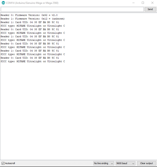

     The code is really simple, it's a modified example. The biggest thing I changed is that I've packed it all inside of a function, because it will be easier for me to use later on in the main code of the project. I tested this out with a couple of stickers and here are the results:
     The code works without any problems. There are some things I just want to point out, the UUID is longer than this, but all of the stickers I had were exactly the same except for the second uid byte, so I didn't go all through. Also, my idea was to use 2 of these modules, one vertical and one horizontal, I had problems with getting one of the modules to work properly in the beginning, and in the end, it refused to work at all. I tried using the multiRead example which can utilize more than 1 of these modules and managed to get these results:
     The Reader0 is the new module I bought which works without a problem, while the Reader1 is an old module I had from before, but which worked the last time I used it. It didn't want to show the firmware version and would only read sometimes. I tried switching the modules around to see if it was to the faulty wiring, but than the Reader1 in the code would work and the Reader0 wouldn't, so it was a problem on the board. I tried inspecting the board and resoldering the pins (one of the pads broke off the PCB), but no luck. So in the end I will only be using one module.

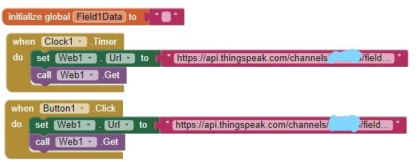

     We will need a couple of simple components for this work, a few labels, a button, a clock widget and a web component. We need a couple of labels, because I found the easiest way to extract the value from the string as you will see soon. Let's begin with the design of the app.
That's all of the UI elements that we will need, now in the block diagram, using the web component we have to load the data and this is how we do that:
You get the URL value from your ThingSpeak account, when you go to your channel, than to API keys, in the bottom right corner you will see a couple of links, the one we are looking for is Get a Channel Field, since we plan on using multiple fields in the future. The code above tries to get data everytime the clock ticks, or whenever we press the button. When we paste the link in question into the browser here is what we get:
     We get a lot of text, pretty much, one thing I did was change the number of results to 1, since we only need the last one, in the first highlighted area in the link you can see "fields/1", by changing the number after the fields we can choose the channel from which we want to get info. Some problems arise when we upload to multiple fields which I'll discuss later. Also, be aware that ThingSpeak allows the fields value to be updated every 15 seconds. Now back to the data we got, at the end of the link we can see "field1":"111", the 111 is the value we are trying to extract, here is a simple not so pretty way of doing that, but it worked great for me:
     The goal is to see what's unique in the string and take it apart piece by piece until we are left with the value. There are certainly better ways of doing this, the way I did it was finding where the "feeds" part of the string is, and after that finding the "field1" part and extracting the value after that. With that the value extractor from ThingSpeak is complete, here is how it looks like on my phone:
     On the first picture is the starting screen of our app, we have the 4 labels and the button we are using as the refresh the button, if we let the clock click and update that way, or if we click the button we should get something that looks like the second picture. In the second picture as the first label we can see exactly the same thing we saw when we put our link into the browser, second label is a string cut from "feeds" to the end, third one is cut from "field1" to the end, and in the end in the forth label we have the value itself from the desired field. A simpler way would maybe be trying to go from position to position in the string but there is a problem because the thing like entry_id can get another digit which would set off the whole string and so on. With this simple version done, it's time to make something more useful than this.

Screen1
     Screen1 will be out startup screen and our main screen. All of the things I want to have on screen1 are the refresh button, settings button and all of the field values. When we press the Refresh button, the app should try refreshing all of the data, and we press settings, the app will go to the second screen. Here is the design of the first screen:
     It has labels for all of the values, labels for all of the names of the fields, the 2 buttons as well as the background components, which include 8 web components, a clock component and a tinyDB component. The biggest change from the last app is the tinyDB component. That component is used to easily store data on the device, because otherwise, every time we close the app everything would reset itself. As for the programming part, it's pretty much the same as the last app, here are the blocks:

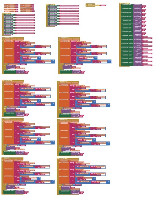

{gallery} Screen 1 Blocks

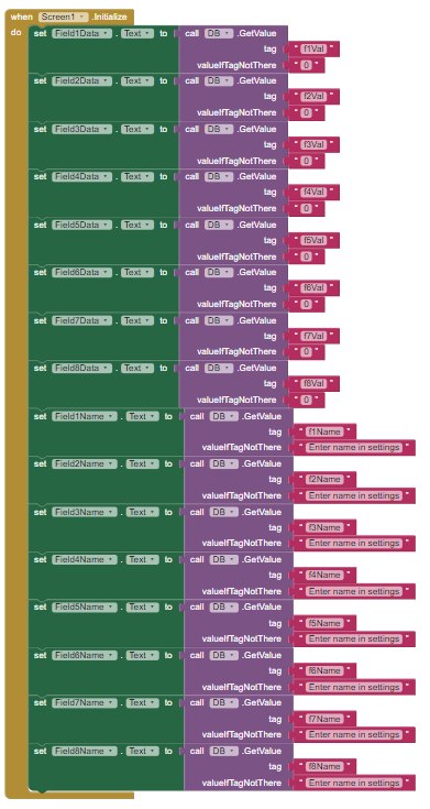

Initialize State and refresh: Initializing all of the variables and handling the updates and the button for changing the screen
Process Data: This is the same concept as in the first app, but with an important modification which I'll explain after this
Process Data 1: We copy the whole structure and just change the numbering of the field wherever we see the name field, to get and update data for the other fields
Process Data 2: We have to do that for all 8 of the fields
Field Name Update: We are retrieving the data from tinyDB to update our field names, which we will configure on the second screen
Whole code: And in the end for screen1 we end up with something like this
      As I've said above, I've made a small change to the data process part which I used in both this and previous app. The reason for the change is that I am now writing to multiple fields, and when we for example only write to field1 and try to get the update everything would work great. But, if we have more than one field and let's say we wrote data to field2 with our ESP8266, if we try to get the data the same way we will get null, since the link we used only shows the latest entry for the whole channel. Now, if you are looking at the field that wasn't the last one updated, the value you will get is null (There is probably a workaround this, but I didn't have time to fix it, so I solved it this way). To solve this problem, at the end of the data process structures for all of the fields, I just checked if the value was null, and if it was not than I can write the data to my label. Here are the blocks that made that change:
The same thing applies for all fields, we just have to configure everything to field2 or field 3 and so on. With that, our main screen is complete. It could use a nicer looking interface and stuff like that, but for now, it has the functionality we are after. Now let's do screen2.

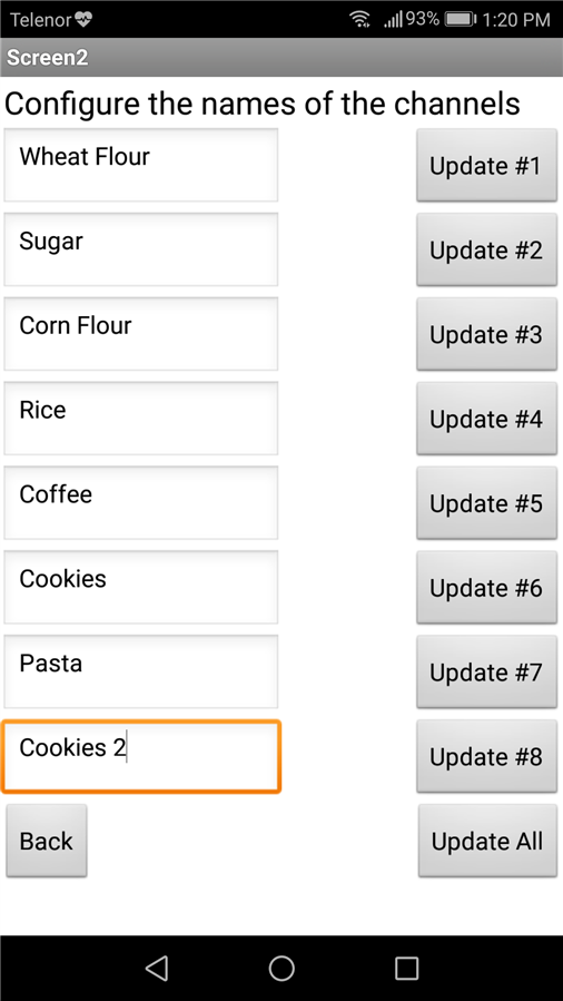

Screen2

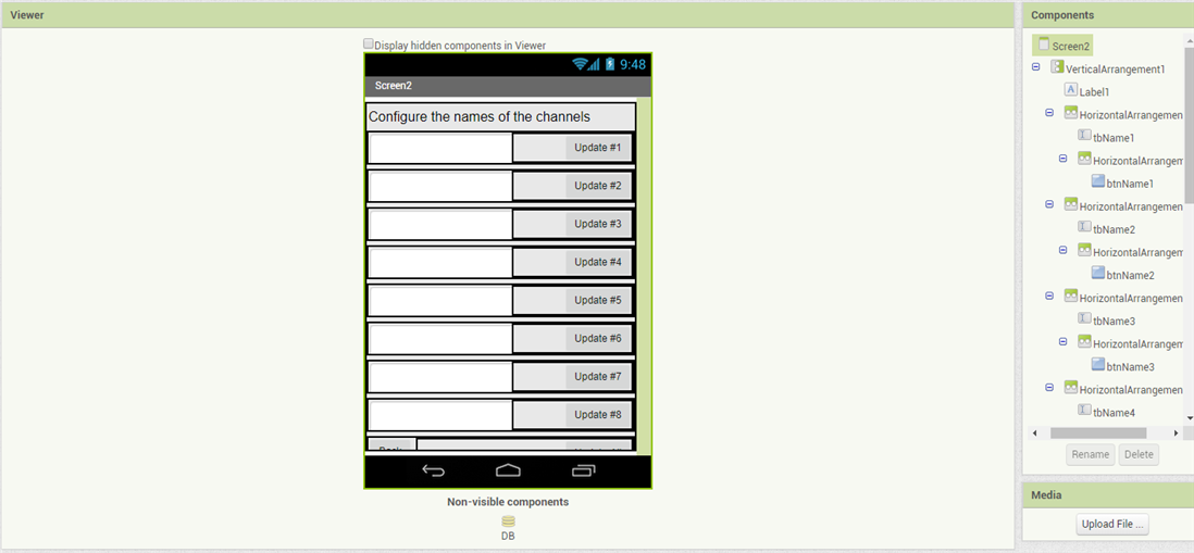

     The purpose of screen2 is to configure all of the naming labels (and other stuff down the line if needed). As I've mentioned previously, we switch to screen2 by pressing the Settings button on screen1. On screen2 we will need text boxes for entering the names of all the fields, a button to update everything (because of how everything was made step by step, I have buttons left for updating every field individually, which can be removed, but they don't make a difference), we need a go back button, for switching to screen1, and we need a tinyDB component, to store all of the data. It's important the tags we have on screen1 for the field names, match the tags we are going to use here, if we want the data to go through. Here is the design of screen2:
     Now all that's left is to program everything on this screen. This screen has a lot less functionality than the previous one, simply said, all it needs to do is save the data from the text box components when either the update all button is pressed or the update button for that channel. One thing I also added is for text boxes to have the starting text that was last entered in them, so you can easily modify it without having to write the whole thing from the beginning. Here are the blocks for this screen:

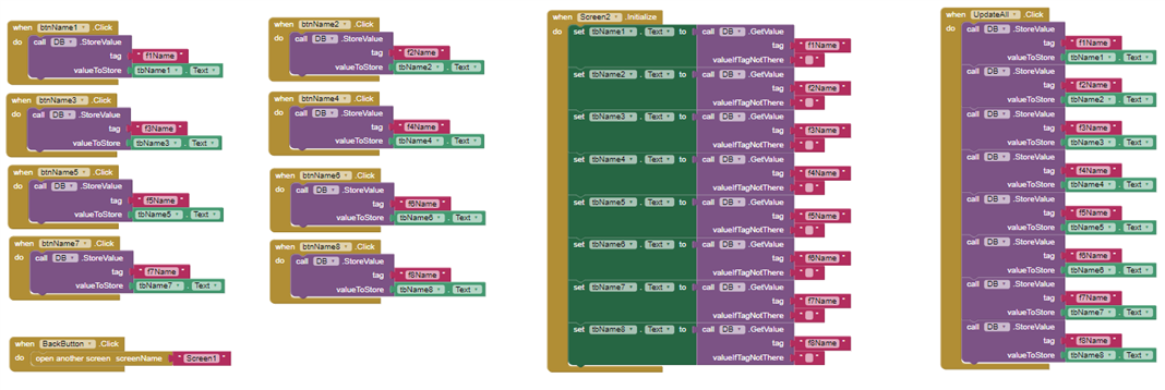

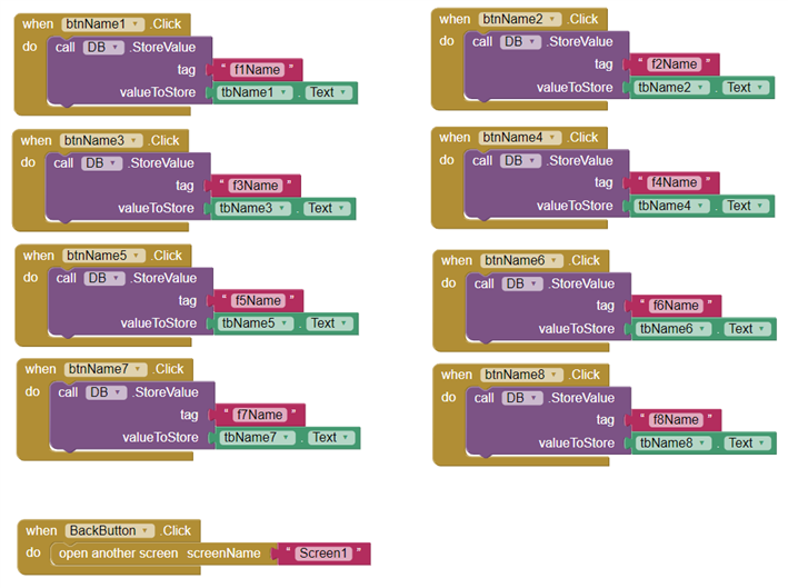

{gallery} Screen 2 Blocks
Single Field Update and Screen Switch: This is how we update single field names with the single field names button, and also switching to screen1 when BackButton is clicked
Screen2 Initialize: This part of the program handles the starting text of the text boxes when we switch to screen2. It will show the values that are saved in the TinyDB which are the values we typed in the last time, since this is the only place we change those values
Update All: The Button for updating all of the field names at once
Whole Code: And this is what we end up with
     With that out app is complete. It should cover all of the basic functionality for the first prototype. It can easily be expanded to handle things like warnings when something is going to expire soon, a temperature sensor, or even a smoke sensor, since there is a good chance that this shelf will be used in a kitchen. Here are some pictures of the app working!
Test
{gallery} App Test
Start: When we first open the app this is what we see, before it updates any of the fields or before we configure the names.
Settings 1: By pressing the Settings button we come to screen2, where we can enter the names of all the fields.
Settings 2: I entered some random stuff from the kitchen that came first to mind, and now we click the update all button, and after that by clicking back we go back to screen1.
Updated: After the update cycle finished, we can see all of the values connected to the names of the fields.

6. Testing
Here are the masses of the things I used above:
{gallery} Mass
Cookies: Accuracy isn't bad
Sunflower Seeds: Accuracy great as well, I just grabbed snacks I could find around
Almonds: And finally some almonds
