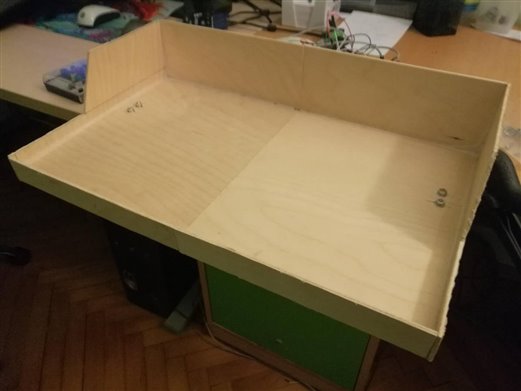

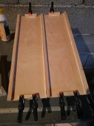

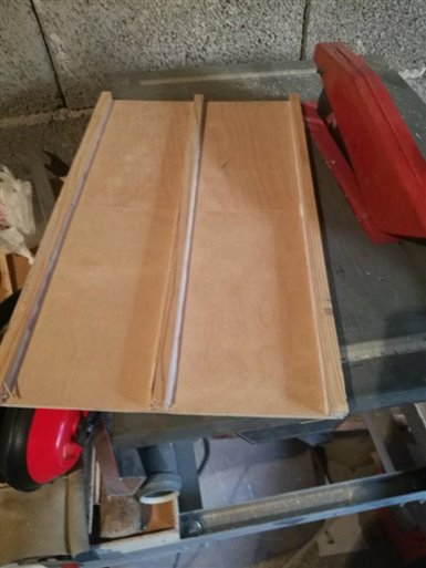

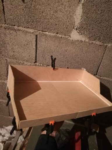

Firstly let's start of with a really basic and necessary step, and that is building the real life model/ the test bench. There were really two options for this part, it was either buying one or making one from scratch. I went with the latter. There are a few reasons to why I did this, firstly I could make it into any shape and size I want, I can choose my materials and make it noticeably lighter than a store bought one. For the material I went with 4mm thick plywood, the one that is used in schools, because I find it very easy to work with, anyone can get it easily, it's light and with supports it can be made pretty sturdy. Besides plywood i used 10x10mm slats which i utilized as reinforcement throughout the build, and of course to connect it all together I used standard wood glue. Here are some of the pictures of the shelf being made:
In the end I think it turned out pretty well, I was using a table saw, so the edges were a little rough and needed some sanding down. If you check the older blogs you will see that there was a plan on making it a two part shelf, which would have been good for weighing the lighter stuff, but I simply didn't have time to make it all work, so in the end i used only this part of the shelf. Some of the upgrades I would do on this part of the build would probably be, adding LED strips to it, previously mentioned second part of the shelf, and making at least the front rail easily detachable so it would be easier to clean the shelf if something is spilled on it. The shelf should be of course mounted to the wall, but for the sake of easier testing it i rigged up a test bench using clamps and two pieces of wood to hold it to a table, which proved to work pretty good for the testing. Here is a picture of the test bench:

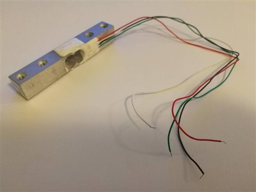

For this part I had a couple of variations based on the same idea. It was apparent that I would be using load cells, They were the easiest and least costly method to use. In the end I used two 10kg load cells on either side of the shelf. Now to successfully connect them to the Raspberry I used two hx711 amplifiers. The amplifiers I had were dual channel, but I couldn't get the second channel working properly. I had problems from completely inaccurate readings to readings that were all over the place while the load didn't change. So in the end I went with using two amplifiers which proved to be extremely simple to set up, and I didn't have any issues while using this method. First of all the load cells needed to be calibrated, on how that is done is by putting a known mass on the load cell, getting the reading, dividing that reading by the known mass, and putting that value as the reference value in the code, on how to wire up the load cell I have an explanation in my 7th blog (S.H.E.L.F. - The one item shelf - Pi Chef Design Challenge - Blog post #7 ), and a guide for calibrating load cells can be found in the libraries example code. I went with tatobari's hx711 library which can be found here (https://github.com/tatobari/hx711py). It's a great and simple library which can easily be modified with an example (first try) program which shows you how to calibrate the load cell itself.
In the end, through comparing the apparatus to a store bought scale I found maximum difference to be within 5 grams. Which is awesome for the use I intended. One thing how I would upgrade this part would be with different sections of the shelf, where one would be aimed towards bulkier heavier stuff while the other one would be a much finer part for measuring the mass of spices and stuff like that, but again nevertheless these load cells proved to be very good.

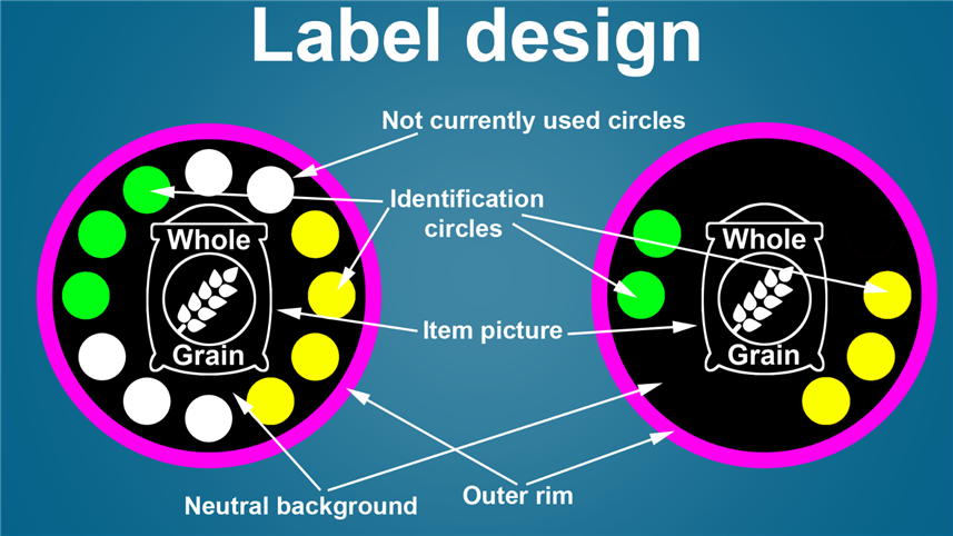

Item recognition
This is the part where I had many ideas. The goal was to in the simplest and most user friendly way possible detect the item that was placed on the shelf. The first idea was having fixed positions for things on the shelf with switches which would detect if something was placed on top of them. This idea while pretty simple and basic, but it was pretty limiting for a user, and would not be the most elegant thing when finished. Second idea was going with specially designed NFC containers/ stickers. While this idea sounds promising, I didn't go with it because of availability of NFC stickers and how it would all have to be executed. The final idea with which I went was to have stickers which could be recognized with an overhead camera. I liked this idea a lot for a few reasons.
  1. It didn't require any hardware besides a camera
  2. The stickers could be easily printed at any copy place, or at home
  3. Stickers for new items could easily be made
  4. The stickers could easily be upgraded to contain more data (container weight, how long something can sit on a shelf,...)
  5. With OpenCV the whole thing turned out to be exceptionally easier than i first thought
For this part I used a piCamera module, but a USB webcam can be also used, and would probably be easier due to the longer cable. Another big reason why I liked this method is because of the direction home automation is taking. There is a rapidly increasing number of cameras all around houses, if the trend continues like this, there will be cameras monitoring everything, which could also be ingredient levels on the shelfs. Before submitting this idea and and starting with the label part I didn't have a clue about Amazon Go. I was impressed when I saw how based on the same idea like this could be implemented on an extremely huge scale professionally. Here is a short recap of the label designs and how I used OpenCV to recognize them (for this part I went intro great detail in my sixth blog which can be found here S.H.E.L.F. - Labels - Pi Chef Design Challenge - Blog post #6 ).
The goal was to design to design a label which could easily be read, and by that I mean, without the need for a lot of coding as well as not having to have super high resolution cameras. Another important thing that i wanted to ensure was that the labels were intuitive, and that it was all in a somewhat nice looking package. I could have went with a QR code like label with a picture on the side or a name, but I just didn't like the idea. So by reading a book and just reading online about CV i found that it's rather simple to detect certain color ranges as well as circles. So knowing that I set of to design the labels. I wanted to use the least number of words possible on the labels, so the language wouldn't be a barrier, Here are some of the designs I made for different items:
Now for the technical part of the stickers. Knowing of course that there would be more items on the shelf at once meant that the each label had to be read separately. This is where the bright pink outer circle comes into play. The reason for the color is that I feel that is the least used color in packaging so while looking for the labels I wouldn't run into issues with a lot of additional noise from other stuff. When finding that circle, the next thing was to crop out the square that contained the circle so the image can go on to be processed further. When that was done it was time to detect what was on the label. That was done by a unique combination of green and yellow circles on the label. I made a list which is stored on the Raspberry which makes the connection between certain codes and items, as mentioned before this can easily be further upgraded to contain more data, some of the ways that can be done is by adding new shapes, new colors, new label, shapes and so on. All of the code will be shown later in this blog but the detailed explanation of the code of how what works can be found in the sixth blog. This part of the project is the one I am most proud of. I never before worked with image processing and really didn't know what to expect. So I planned and left a lot of time for this part from reading to watching tutorials on OpenCV, and am extremely happy on how it turned out it the end. On the downside though this meant I had less time for things that I thought were going to be easier, but turned out that they can be a real hassle.

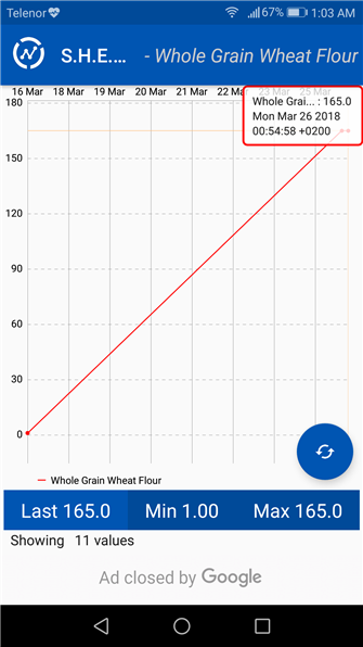

Viewing the data online
This was a purely software based problem. There are a lot of different ways to go about doing this, but in the end I went with the simplest of them all, thingspeak. Thingspeak is a great free service which enables people to easily upload data and get data from. This is where the time limit had an effect. The plan was developing my own app, but looking online and considering how much time I had left, I decided to go with an existing app called ThingView for Android. This app proved to be extremely easy to use where the only thing needed for setting it up was the API key that can be found on the created thingspeak channel. On the Raspberry side of things one new library was needed, and a really rather simple code to upload the data online, which could than easily be accessed by any device from anywhere. This method of course being so fast had its limitations. Firstly there was a limit of 8 fields per channel, but this can be avoided by having multiple channels. Also it didn't provide the flexibility I wanted, but it was a made as a general use tool not specifically for this project, but all in all it worked like a charm. Upgrading this part of course would be making a custom Android app which could have indicators when something is going low to a much bigger number of channels to controls for the shelf itself. For the description and code for thingspeak here is the link to my tenth blog (S.H.E.L.F. - The First Working Prototype - Pi Chef Design Challenge - Blog post #10 )
