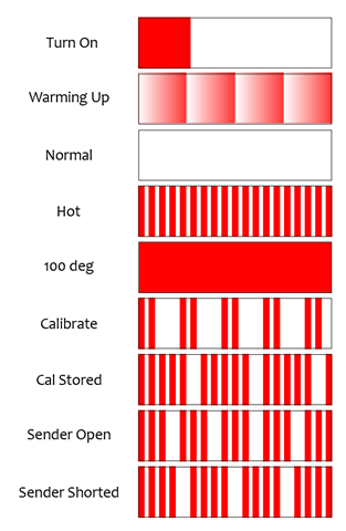

As everyone knows a flashing light means go faster, but it is also the best way to get attention, and thats why they always have a flashing light where there is a sale. image
In modern cars the warning lights come on for a period when you start the vehicle, and surprise surprise this is so you can tell the ones that aren't working.
I bet there are some people right now going    "oh that's why they light up"    image
So we have the idea.
Comes on when it starts for confidence, Flashes to warn it's getting HOT, and On when it is really hot,  .... easy.
I decided to add one more stage and that was Fade while the engine temperature was cold and it was still warming up.
Just to ensure the driver has every warning possible, there are some error codes as well.

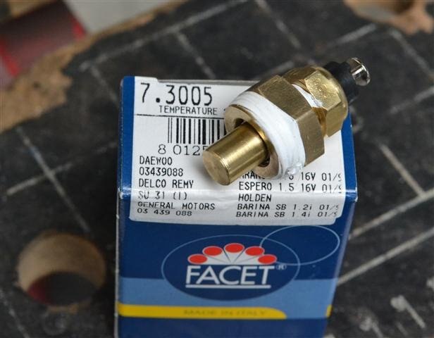

I'd been dealing with DS18B20's and use them whenever I can, but no-one makes one that can be screwed in and seals (not for 15psi).
I could have pulled apart another sender or made something, but it was easier to buy an automotive analogue sender that was readily available.
I chose a Facet (7.3005) from a local supplier.
It needed an adaptor for the chosen hole, but these are a readily available part.

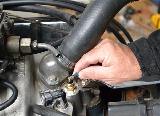

I removed some of the adaptor thread, to ensure more of the sender was in the water flow, for quicker response.
it was duly fitted and the original wire connected back to it.

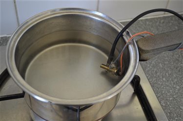

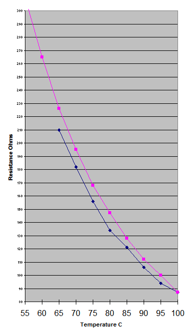

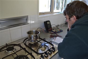

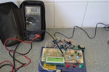

I had to find out what the resistance of the sender was at the various temperatures, so I waited until someone was at work, and 'borrowed' the kitchen.
  The kitchen is not my normal habitat, except for making a drink, so I wasn't sure how things would go, but the recipe was simple.
  • Place in water
  • apply moderate heat
  • note resistance readings at various temperatures until the water boiled.

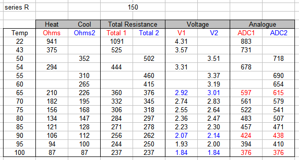

The results went into an Excel spreadsheet and I noted the reading as it was heating up, and cooling down.
From those the voltage and analogRead values were worked out by substituting the resistance.

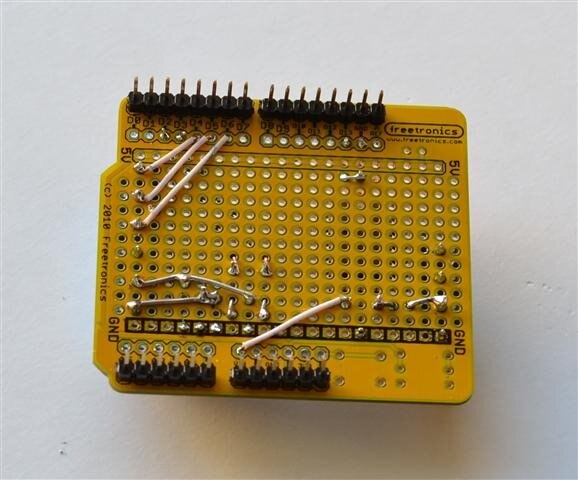

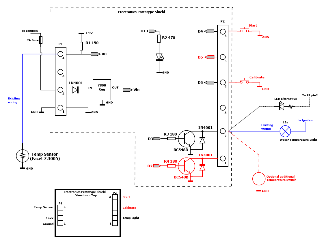

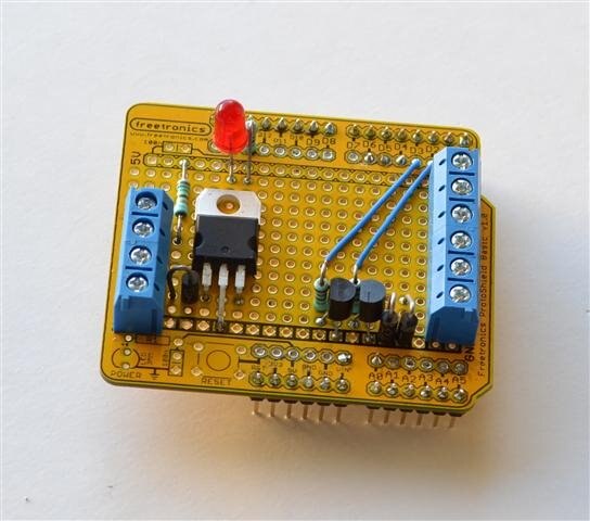

The controller chosen was an Arduino but since I was going to do more with this, I added a shield for connections and interface components.
The regulator is a 7808 since vehicle charging can go as high as 15v, and many of the Arduino board regulators that aren't rated that high.
I call it insurance from spikes or other nasties in a vehicle.
One of the transistors drives the existing light, and the onboard LEd gets covered, so I added one on top.
The Calibrate button allows the user to adjust the normal temperature point (ie when it stops fading). The default was 65 degC.

       The Temp Sender is fed via a 150 ohm resistor from the 5v line. This results in a voltage between 1.7 and 3.6 v.
       If the voltage is 4v or 1v, then an error is displayed.
       A power off is required to reset an error condition.
       Default values are used if the EEprom hasn't been written to with Calibrated/Altered values.

         Default values are based on a Facet 7.3005 sender (Auto Agencies, Rangiora see http://www.autoagencies.co.nz/)

       The Temp Light continually fades up until the NORMAL value is reached, when it goes Off.
       When the Temp reaches 90 deg it flashes.
       If the Temp reaches 100 deg it stays ON.
