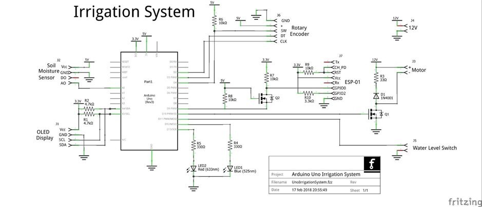

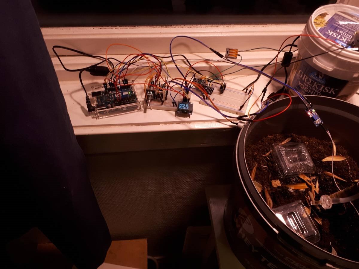

General description
The purpose of this project is to create an automated irrigation system based on an Arduino Uno and ESP-01. It will need to automatically detect when irrigation is required and if there is water in the reservoir so that irrigation can initiated. If the reservoir is empty, then an e-mail must be sent to inform of this so that the situation can be remedied. If irrigation is required and water is available (and all the safety requirements are met), then irrigation should be initiated.
The system includes a soil hygrometer sensor for detecting the dryness of the soil, a water reservoir (a bucket of water), a water level switch for detecting if the water reservoir is empty, a peristaltic water pump used to irrigate the soil, and an OLED graphical display and a rotary encoder which are used to adjust humidity thresholds at which irrigation should be started and stopped.
As mentioned earlier, the system also includes a set of safety requirements which have to be met.
Project specification:
The main components of the system are:
  • An Arduino Uno (hereafter referred to as “Uno”) which controls everything
  • A 9V DC 1A power adapter for the Uno
  • An ESP-01 WiFi module which is used to facilitate messaging
  • A FC-28 soil hygrometer (moisture sensor) for detecting humidity in soil
  • A water level switch NC mounted on a float for detecting when the water reservoir is empty
  • A Keyes KY-040 rotary encoder is used to adjust threshold values used by the sketch
  • A 0.96" 128 x 64 pixel OLED graphical display used to display status information
  • A peristaltic water pump to pump water from the water reservoir to the soil
  • A 12V DC 1A power adapter for the water pump
  • A 10 gallon bucket of water (water reservoir)
  • A potted plant to water
Operation:

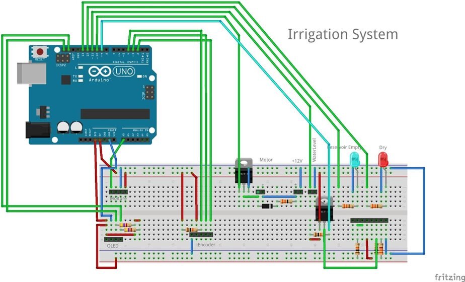

The two sensors (soil hygrometer and water level switch) are connected to inputs of the Uno (A0 and D11 respectively) and the water pump is controlled by an output signal (D10) from  the Uno. Two LED’s are controlled by output signals from the Uno and are used as status indicators:
  • Red  : (D13) Lit to indicate that the soil is dry enough to warrant watering
  • Blue : (D12) Lit to indicate that the water reservoir is empty (requires a refill of water)
A 0.96" 128 x 64 piksel OLED graphical display is also used to display status information and to adjust threshold levels for turning the water pump on and off. It uses the Uno's I2C interface (A5(SCL) and A4(SDA)).
A Keyes KY-040 rotary encoder is used together with the OLED display to adjust the threshold values used by the script. It uses the D2 through D5 pins as input. The system goes into adjustment modus when the knob is depressed. The user can then scroll through the items which can be adjusted. The item to calibrate is choosen by depressing the switch once more when it displayed. This causes the system to display the current value being used for that item. The user can then increase the value by turning the knob clockwise (whereupon the displayed value increases) or counter clockwise (whereupon the displayed value decreases). To choose the displayed value the user must depress the knob - whereupon the system also exits adjustment mode and commenses to use the new values.
There are three criteria which all have to be met in order to turn on the pump (and water the plant):
  1. There must be water in the reservoir
  2. The soil moisture reading in the soil must be greater than a specified high threshold value (indicating the soil is too dry)
  3. A specified minimum amount of time must have elapsed since the pump was last turned off while watering (but not if this was due to entering adjustment modus).
Any one of the following criteria will cause the pump to be turned off:
  • No water left in the water reservoir
  • The moisture reading of the soil is lower than a specified low threshold value (indicating the soil has been irrigated sufficiently. This criteria also triggers the timer which keeps track of the amount of time that has elapsed since the pump was turned off).
  • the pump has been on continually for at least MAX_PUMP_ON_TIME milliseconds.
  • (only temporarily) entering adjustment mode
Basically, the Uno just goes in a loop checking the criteria above and taking action when necessary. Each loop iteration takes approximately 20-30 seconds to complete. If, however the knob of the rotary encoder is depressed and this is detected, the function for adjustment modus is called and normal operation is not resumed until after returning from the function. Before the adjustment function is called the water pump and on time timer are both stopped if the pump is on. Both are then resumed upon returning from the adjustment function.
Notes:
GPIO ESP_WATER_EMPTY is used to signal to the ESP-01 that the water reservoir is empty (via the GP0 pin of the ESP-01). The ESP-01 is configured to use its GPIO0 as an input. A LOW signal on this pin will trigger the sendMessage(FILL_RESERVOIR_URL) function on the ESP-01. This function invokes a PHP script on my Raspberry Pi server via a HTTP GET request. The parameter it uses indicates which script to invoke. This one (FILL_RESERVOIR_URL) results in an e-mail being sent to me informing me that the water reservoir is empty. The ESP-01 also calls this function with CONNECT_SUCCESS_URL as the parameter from its setup() function. The resulting e-mail informs me that the the ESP-01 has successfully connected to the WiFi and it also reminds me that any custom thresholds need to be re-entered (since this e-mail will only be sent whenever the ESP-01 restarts => the Uno has also been restarted.
Future features to implement:
  • replace Uno with custom design (with ability to reprogram by attaching adequate IO interface)

Arduino Uno IO Pin Use:
D0: -
D1: -
D2:In ENCODER_CLK
D3:In ENCODER_DT
D4:In ENCODER_SW
D5: -
D6: -
D7: -
D8: -
D9:Out ESP_WATER_EMPTY LOW: Send e-mail informing that water reservoir is empty
D10:Out PUMP HIGH: ON - Turn water pump on
D11:In WATER_LEVEL HIGH: Water reservoir has water (this pin is also connected to GP0 of the ESP-01)
D12:Out WATER_EMPTY_LED HIGH: ON  - Signal water reservoir is empty (Blue LED)
D13:Out DRY_LED HIGH: Lit - Signal pump should be on (Red LED)
A0:Analog In Soil hygrometer reading
A1: -
A2: -
A3: -
A4:SDA I2C (OLED display)
A5:SCL I2C (OLED display)
