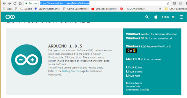

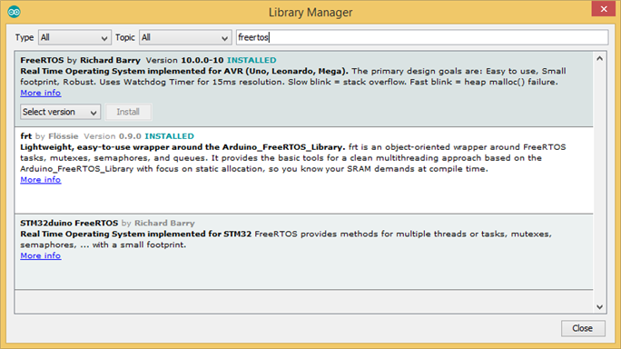

To get started, it is best to download the latest Arduino IDE from the Arduino site:
https://www.arduino.cc/en/Main/Software

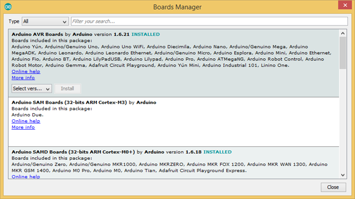

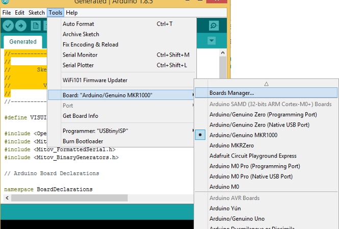

Once the Arduino IDE is installed, it is wise to update the Board packages as well as the Libraries in the IDE.
To update the Board code in the IDE, click on Tools -> Board: "Arduino/.."->Boards Manager.
Then, in the Boards Manager window, select the Board or Board grouping for the board being used and either Install it or Update it it it already installed.

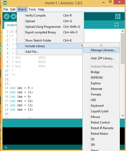

To update the Arduino IDE Libraries, Click on Sketch->Include Library->Manage Libraries. This will present a screen where the various supported libraries are listed and can be installed.

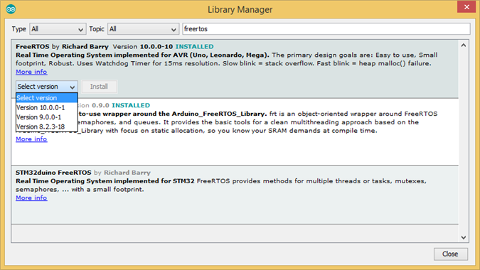

The Library Manager window should appear.  To locate the FreeRTOS listing, type in freertos in the find textbox at the top of the window.
The version of FreeRTOS should be seen in the listing for FreeRTOS as:
     Version: 10.0.0-10 INSTALLED
If the version is not 10.0.0-10 or newer, click on the Select Version drop down list box and select the 10.0.0-10 version and then the 'Install' button.
I also installed 'frt' as well for S&Gs.
Once FreeRTOS is updated, shutdown the IDE and reopen it to ensure the libraries are update properly.

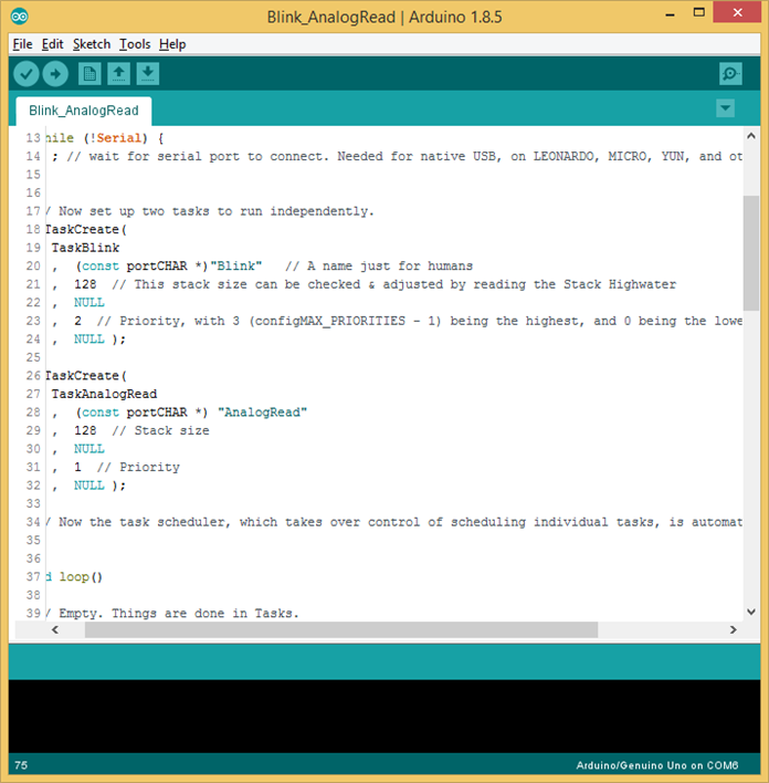

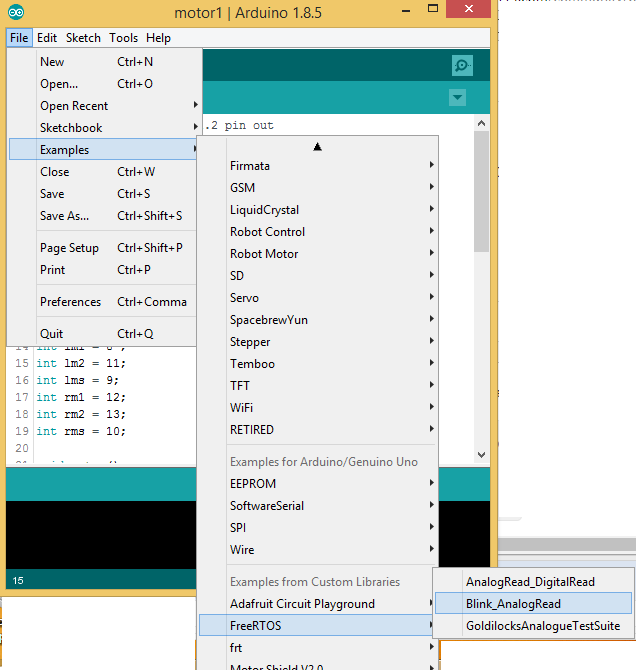

When the IDE is up again, click on File->Examples->FreeRTOS->Blink_AnalogRead as a test.
NOTE: This requires a switch connected to pin A0 and the use of the BuiltIn LED.
This will bring up a 2 Task example using FreeRTOS that takes input from a switch connected to A0 to control the Blink of the LED connected to Pin13.
This FreeRTOS Sketch will blink the on board LED (PIN 13) and pint the Switch (A0) value to the console output seemingly not interrupting either task.  That is, the LED should continue to blink when the switch is pressed.
This example was used to create my Ping Sensor and Motor Control code.
