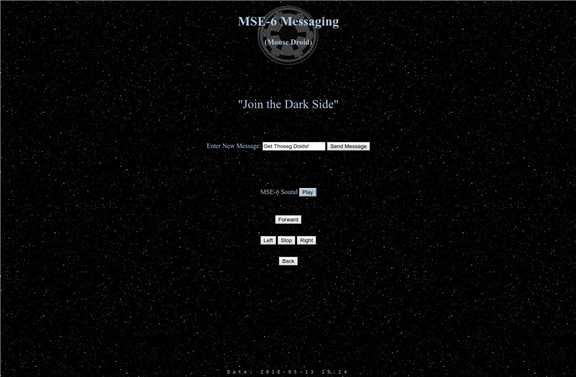

So, from my Mouse Droid webpage that is hosted on the Arduino Yun, I was able to send a message to the Yun TFT screen, play the Mouse Droid sounds as well as control the droid by moving it Forward, Backward, Left, Right and Stop.   I added the ping sensor to the front but am not using the sweep servo for now due to the space in from of the chassis.

The new web page with the Mouse Droid controls looks like the following.

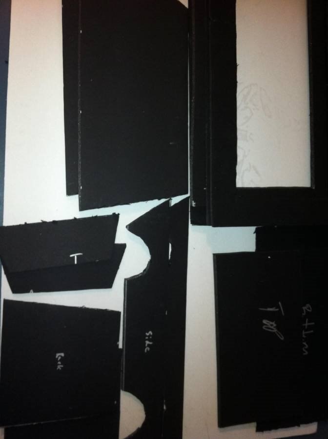

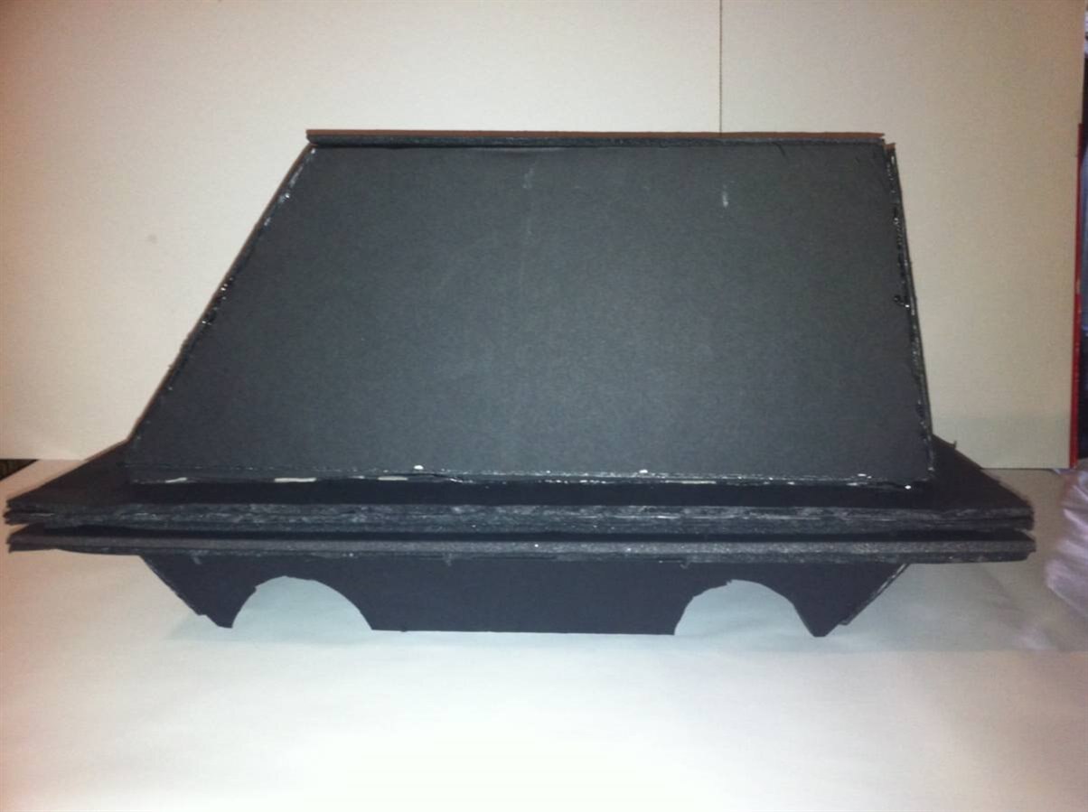

To create the bod of the Mouse droid I used black foam board.  This was cheap and easy to work with, although did some work to get the shape I was looking for. I took a few sheets and cut the individual pieces I needed.
After hot cluing the pieces together, the Mouse Droid shape started to take form.

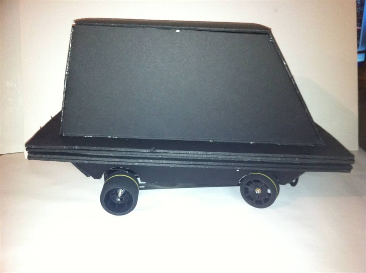

With the RJ Speed Legend chassis assembled, it really started to look like an MSE-6

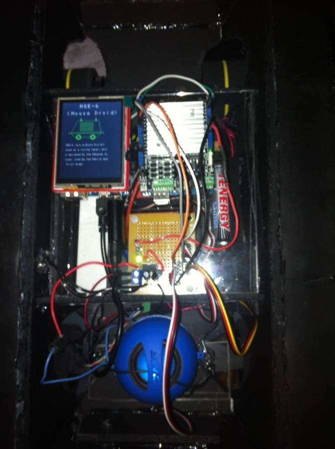

With the chassis and the body together, it was time to put the guts (electronics) in the Droid.
This includes the Arduino Yun (LEFT), Ardiuno UNO (RIGHT), Seeed TFT Screen, Speaker, 7.2 to 5 volt regulator, Steering servo, Photon Speed 2 Motor, and ESC.
