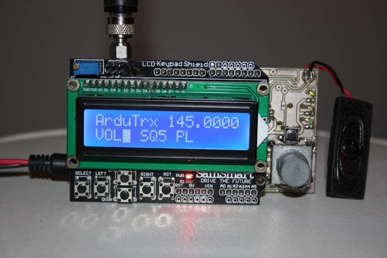

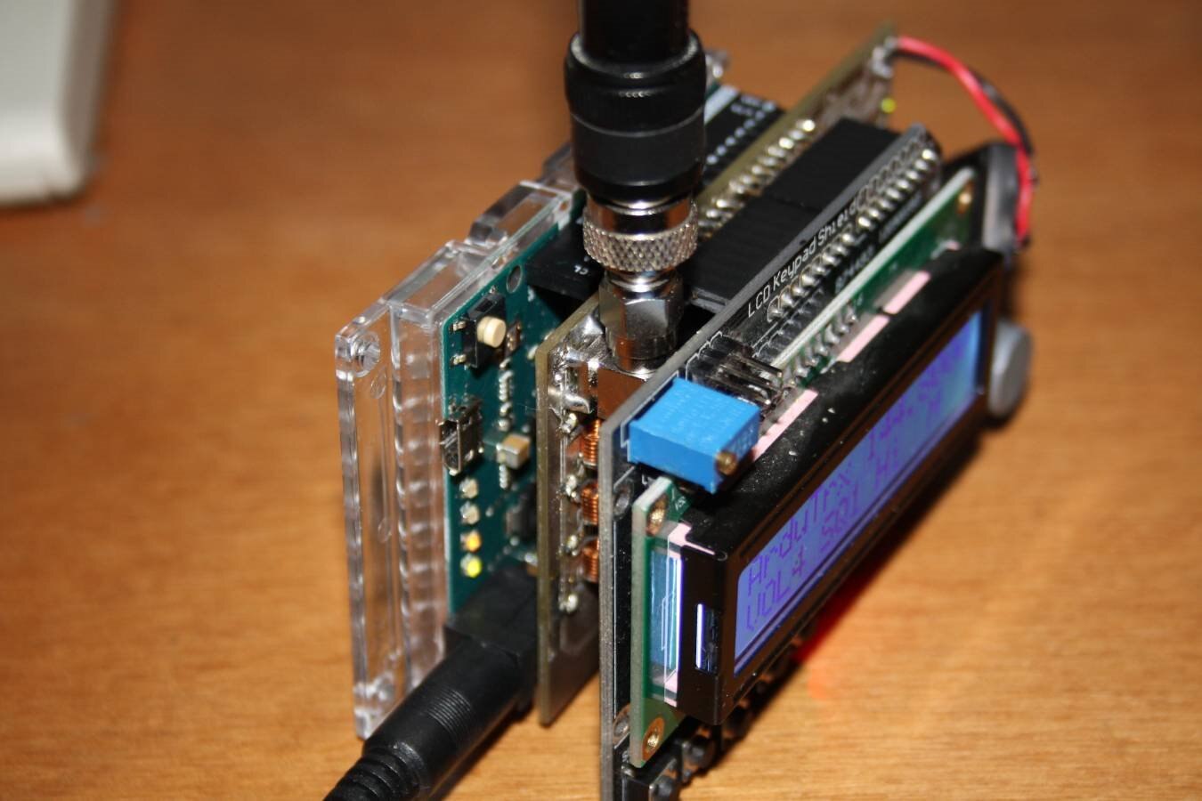

ArduTrx is a 2-meter-band ham radio transceiver which uses an Arduino as precessor board. I made a Arduino shield with the Dorji DRA818V transceiver module (http://www.dorji.com/docs/data/DRA818V.pdf). Together with an Arduino board and a SainSmart LCD Keypad Shield (https://www.sainsmart.com/products/lcd-keypad-shield-for-arduino-duemilanove-uno-mega2560-mega1280 ) you can build a complete ham radio transceiver and start communicating. This project does not only give some basic functions to communicate with the DRA818V, it moreover has all the fuctions for a completly usable transceiver.
Features
  • Frequency Range: 134 MHz - 174 Mhz (maybe limited to ham radio bands by software)
  • frequency selection with encoder
  • 1750 Hz tone for repeater operation
  • split rx and tx frequency for repeater operation
  • CTCSS via menu
  • Squelch and volume can be set via display keys
  • Transmit power swtchable from 0.5W to 1W

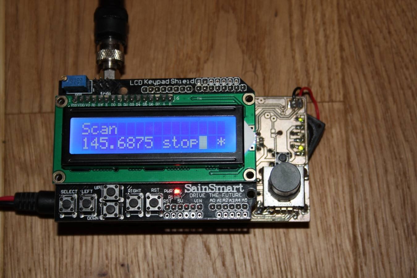

  • frequency scan
  • all settings are stored in eeprom and recalled after reset

The ArduTrx shield should be compatible with all 5V Arduinos. Compatibility was explicitly tested with Arduino Uno and Arduino Leonardo.

    bernhardmayer over 8 years ago in reply to jc2048 +6
    Hi Jon, the DRA818 modules have some problems with the harmonics. So I decided to implement a low pass filter to get rid of them. The filter is a chebyshev low pass with the following parameters: cutoff…

    There are different hf modules available. DRA818V and SA818-V are for VHF, DRA818U and SA818-U are for UHF. So different hardware for UHF and VHF. Unfortunatelly there is no module available which covers both bands.
    Bernhard
