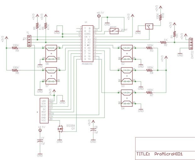

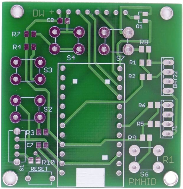

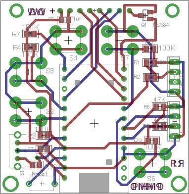

I have designed a PCB that I call the HID Conglomerate that can perform all the above functions.
I have been holding off publishing this blog for over a month while waiting for the PCB to arrive.
Unfortunately it has not arrived yet, so I am publishing anyway. The PCB was fabricated over a month ago and I paid extra to have it air mailed here. Apparently it has been in the air for over a month. Canada Post has decided to no longer honor the tracking number systems of other countries, so I can only tell that it left the other country. It is taking longer than if I did not pay for faster delivery. (regular mail) This is the second project in a row that is all messed up by slow PCB mail.
This card can perform any HID function and it has an LCD to display useful information. I can describe a couple of functions I was(am) planning to implement in addition to the examples above:

The PCBs finally arrived after spending over 6 weeks in air mail limbo, so I got to finish off the project. The finished project photo is added at the top of the blog.

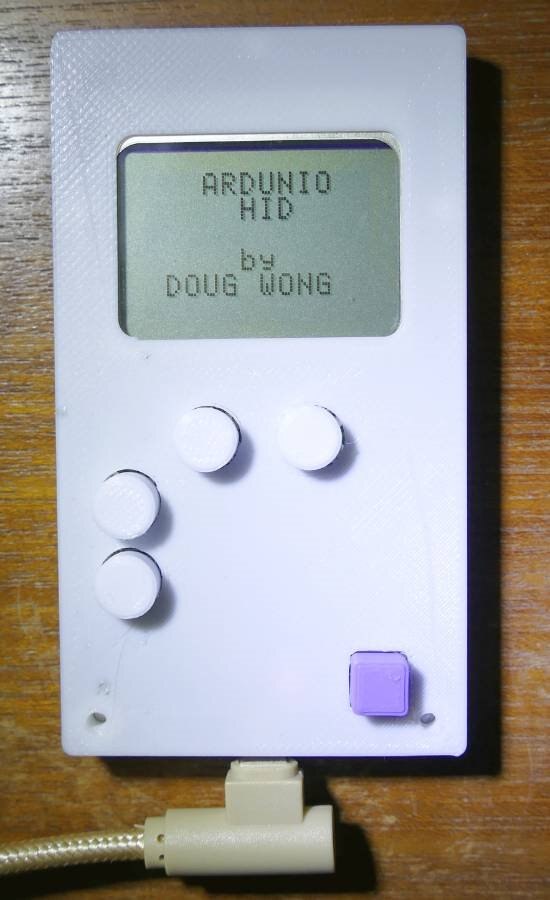

The images below show what is in the module. Note that there are unused connectors that may be used for other projects and applications - because I ordered 10 of these cards (about $1 each).
imageimageHere is a little video of the result:

The project involved 3D printing 2 small cases and designing a custom PCB.
I actually use these HID devices every day, so it has been a very worthwhile project.
The single pixel mouse moves are very handy and I get a surprising amount of use out of the "element14" button.
