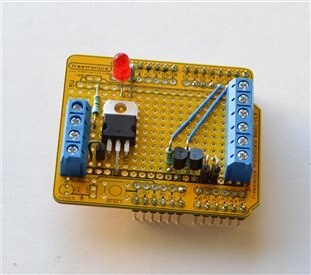

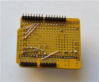

Hardware
I was connecting other stuff (see A more Intelligent Idiot Light  )
The controller chosen was an Arduino but since I was going to do more with this, I added a shield for connections and interface components.
The regulator is a 7808 since vehicle charging can go as high as 15v, and many of the Arduino board regulators that aren't rated that high.
I call it insurance from spikes or other nasties in a vehicle.

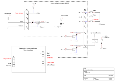

One of the transistors drives a relay, and the onboard LED gets covered, so I added one on top.
As you can see some of the connections are shared with the alternative use for the hardware. A more Intelligent Idiot Light
The relay gets wired across the 'park' contact of the wiper motor.
The wiper switch actually operates in the ground part of the motor, and power remains on the motor.
Whenever you switch the wipers off, the park contact is still closed until they reach the parking position, and the contact gets opened.
So the relay gets wired across that contact, and the motor thinks it hasn't got home yet.

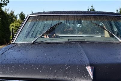

As I indicated in the Intelligent Idiot Light, the car has been sold.
I can reproduce the function of the sketch.
I had to make a switch panel ... and as luck would have it the green pushbutton is a latching ...hence the double press.image
Not sure what the motorboating noise is in the sound, but I did have the GoPro remotely controlled.
Hope you enjoy and gives someone some ideas.
