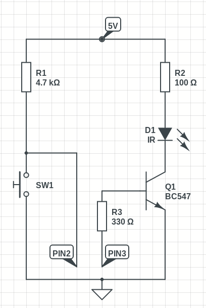

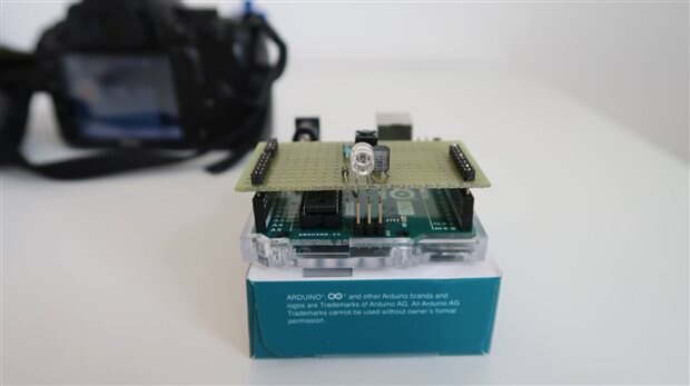

First step was to create a shield for arduino with support for IR LED and one button. IR diode is driven by NPN transistor to achieve 35 mA of current and larger distance for control. Button it pulled-up to 5 volt. Here is schematic:

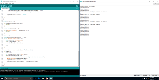

Second step was to create program. Value of current interval for time-lapse is stored in EEPROM and it is possible to update it by USB serial by sending command:
- setInterval:12345 (five digit value of interval in seconds). I have used two libraries:

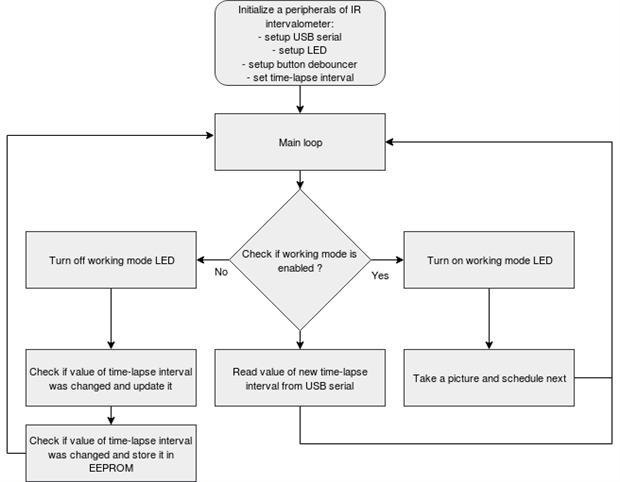

Here is flow diagram for program:
Source code is also available in attachment.

void serialEvent() {
  if (isUpdateTimelapseInterval) {
    return;
  const int dataLength = 18;
  if (Serial.available() < dataLength - 1) {
    return;
  int i = 0;
  char receivedData[dataLength] = { 0 };
  while (Serial.available() > 0) {
    char character = Serial.read();
    if (i < dataLength - 1) {
      receivedData[i] = character;
    i++;
  char *data = strstr(receivedData, "setInterval:");
  if (data) {
    data += 12;
    int timelapseIntervalVal = atoi(data);
    if (timelapseIntervalVal > 0) {
      Serial.println("Got new value of time-lapse interval in seconds:");
      Serial.println(timelapseIntervalVal);
      isUpdateTimelapseInterval = true;
      timelapseIntervalValueToUpdate = timelapseIntervalVal;
