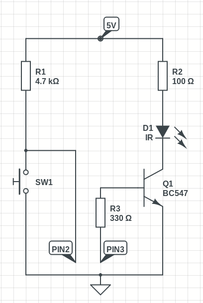

The basic idea was to create IR intervalometer for my Nikon DSLR. I have found in network information about captured raw signal from existing Nikon ML-L3 remote control. So, I have decided to use this information and Arduino Uno to create IR time-lapse intervalometer device for Nikon DSLR. Original RAW IR signal is modulated with 38kHz frequency and have following timings:
- 2.0 ms - on
- 28.0  ms - off
- 0.5 ms - on
- 1.5 ms - off
- 0.5 ms - on
- 3.5 ms - off
- 0.5 ms - on
- 63.5 ms - off
First step was to create a shield for arduino with support for IR LED and one button. IR diode is driven by NPN transistor to achieve 35 mA of current and larger distance for control. Button it pulled-up to 5 volt. Here is schematic:
