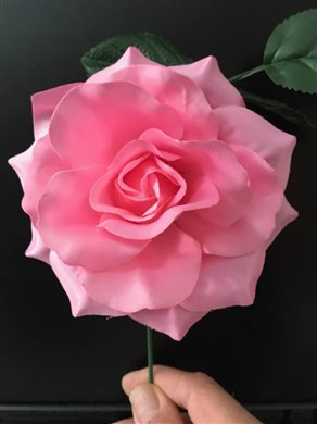

Assimilating the Rose
A rose is a rose is a rose...
I should admit that this was the easiest component to hack. As a matter of fact, Earth plants are in the lower positions of the evolution rating and their assimilation only required a couple of hours. The cost of the rose (at the Chinese bazaar) was 1 Euro.
The flower rotation required the use of another micro-motor. No problem, these are super cheap and I have plenty at home! The original, flexible and thick support of the rose has been replaced by a BBQ wooden stick: 100 pieces, 0.50 Euro; I guess you know where I bought them. The making of the rotating mechanism required another small 3D design of a couple of components shown below.
The images below are self-explaining on how I have assembled it.
Then the rose has been hot-glued inside a cylindric glass to keep it firmly in place.
