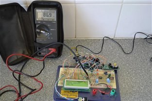

I did some calibration using a previous Arduino sketch that I did when I replaced the thermostat in the fridge.
The new thermostat needed adjusting so I had it display on an LCD. (it later formed part of the code for this Arduino, Temperature, LCD and more )

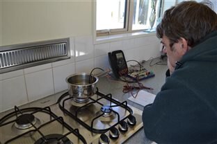

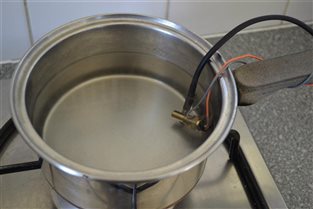

The kitchen is not my normal habitat, except for making a drink, so I wasn't sure how things would go, but the recipe was simple.
  • Place in water
  • apply moderate heat
  • note resistance readings at various temperatures until the water boiled.
You can do some math and work out the voltage based on 5v, 150 ohm and the sensor resistance reading, or simply use a resistance substitute to get a figure from the AnalogRead of the pin.
In the end my figures were
90 degs C = 2.07v and AnalogRead = 424
100 degs C = 1.84v and AnalogRead = 377.

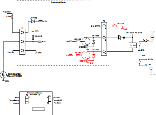

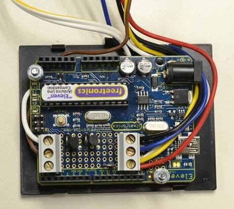

The Arduino cannot drive a 30A relay on it's own, so a transistor was needed.

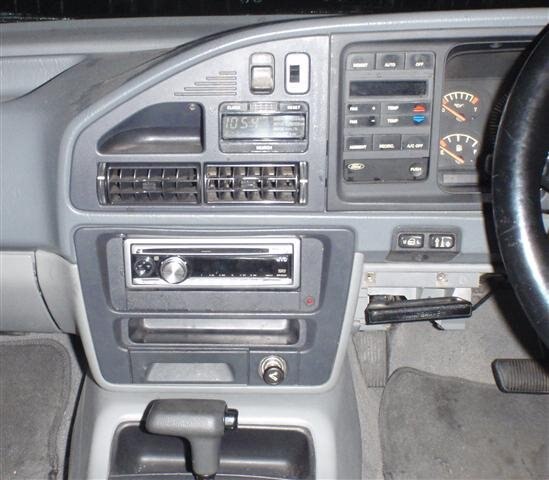

We also decided that a dash mounted LED would give feedback about what was happening.
It also required connections that my friend could easily connect the various wires to, rather than soldering.
Rather than use a shield, I decided to use a Freetronics Eleven. https://www.freetronics.com.au/products/eleven#.Wsa20H_YWUk
This includes a protyping area to house the components shown in the schematic below.
I do like these boards but it would be nice if more 3rd party suppliers copied it as the price here is a little high.
The removable chip was an advantage, as I could send him another with new code if there was a change needed.

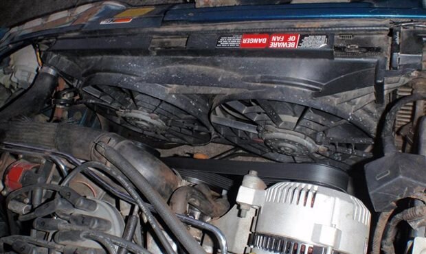

Installation

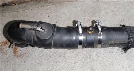

For this vehicle there is no spare holes to fit the sensor, but luckily he had spotted an adaptor.
So after some cutting and no doubt some swearing, the sensor was attached.
Some people may have spotted that the photos show nothing for the body of the sensor to connect to the chassis or ground.
This was a mistake which got picked up in the software and responded exactly as planned.

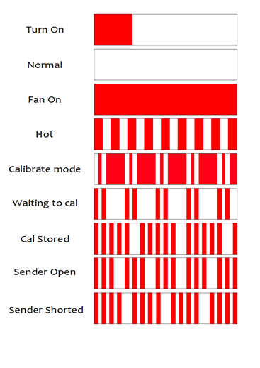

We weren't exactly sure what temperature to switch the fans on, so I allowed for a calibration mode that would write the value into the EEPROM for future.
The LED is used to signal to the driver what is happening, and it changes depending on the mode it's in.
I decided to give the driver some confidence by operating the fans and LED for 5 secs when the vehicle starts, but otherwise it is off until it get warm and it operates the fan and the LED is on.
If it continues to get hotter the LED flashes.
The picture below shows all the modes and indications.

    void DisplayMODE()
      Flashes the Temp Light to show an error.
      Turns ON the fan because we can't tell what the Temperature is.
      It should stay in this mode, until reset by power on/off.

Safety systems

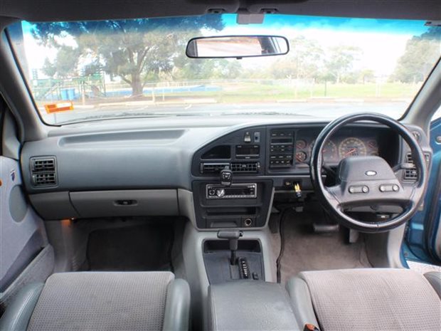

The final picture shows the LED mounted in the dash to the right of the radio, and the horrible switch neatly shoved back into the hole.
Going back to our earlier picture  .... showing the sensor mounted in a plastic adaptor with no earth ...
I got a call from my friend after a while and he said it wasn't working, the LED keep flashing and the fans were ON all the time
He wasn't particularily worried as it wasn't overheating and he was driving it everyday.
What got missed in the conversation was that it was flashing the error code for the "Sender Open", and I thought it was the "Hot" flash mode.
I looked back at his photos and then asked about the earth wire ....
So it's nice to know that the protections you put in place work.
