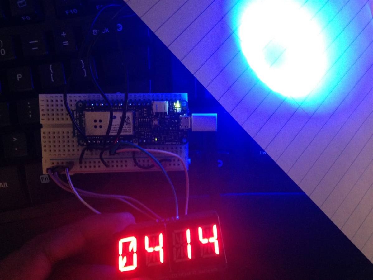

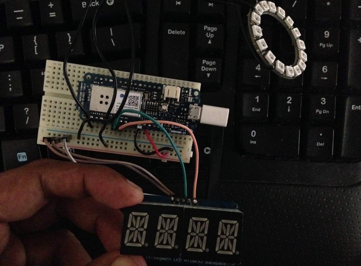

Here is a picture of the circuit diagram on the breadboard
  • Neopixel is connected to pin#6 (PWM) on the Arduino, for the test I am using a NeoPixel ring
  • The data and clock pin on the Quad Alphanumeric Display with a I2C Backpack is connected to Arduino MKR1000 SDA (pin#11) and SCL (pin#12)

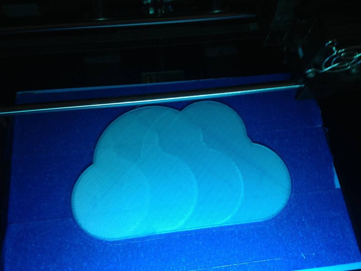

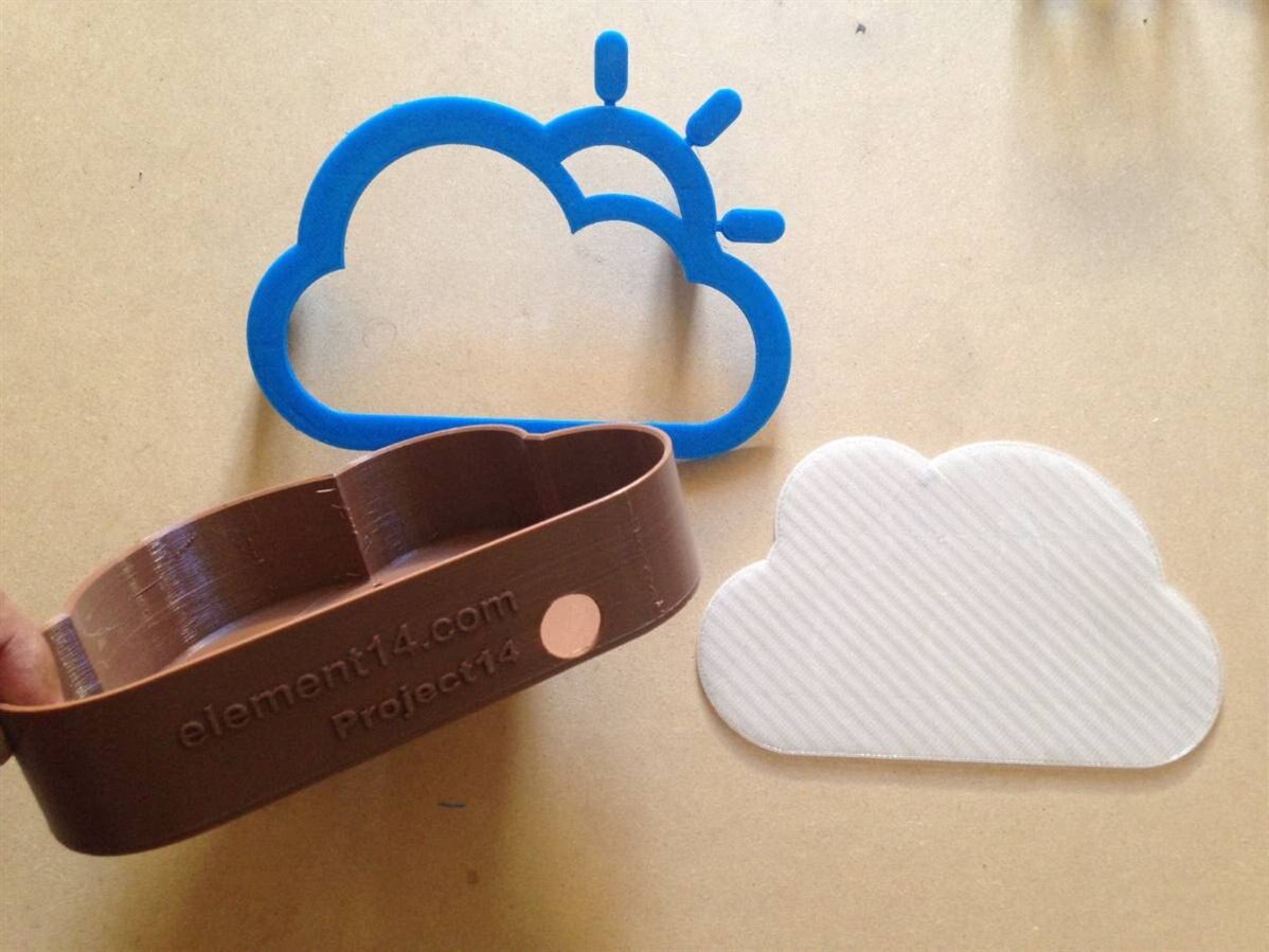

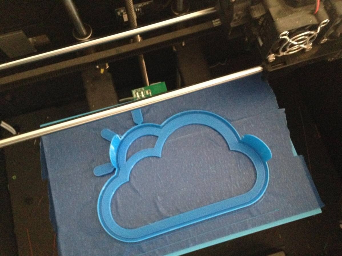

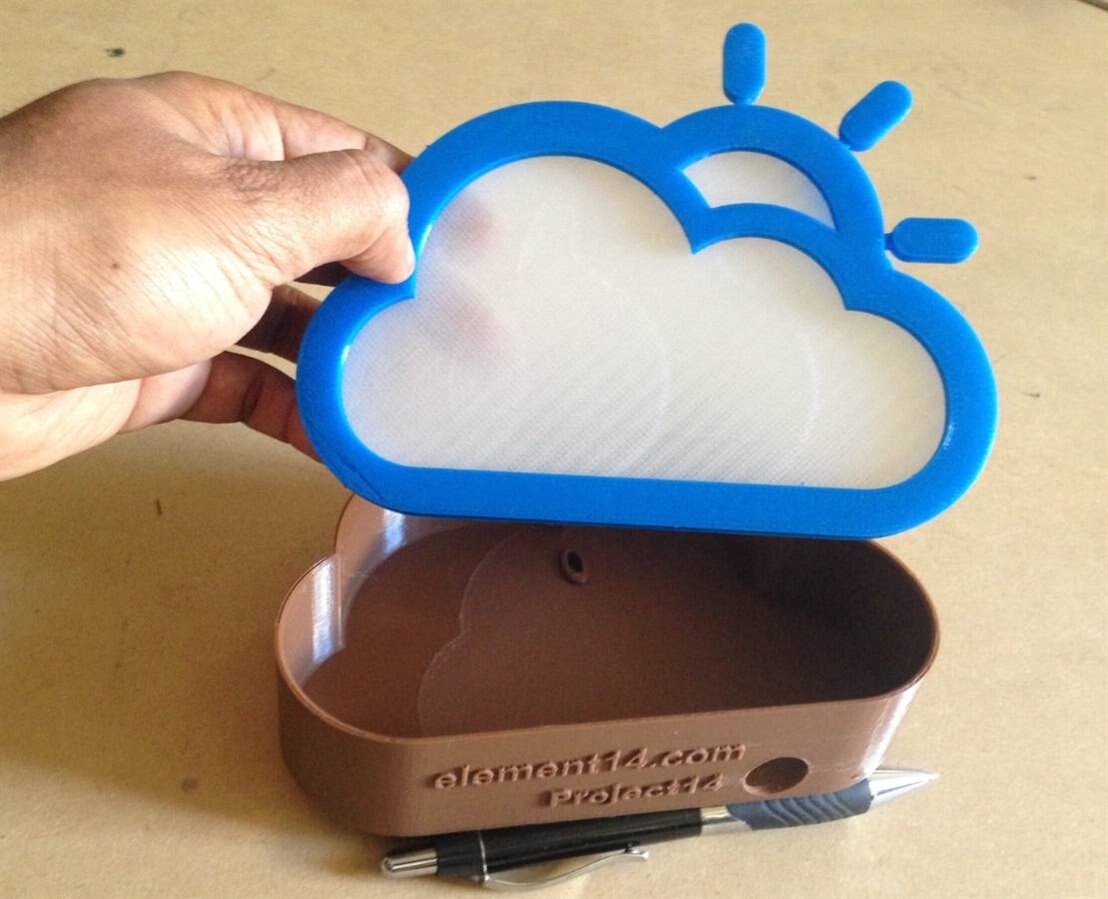

Here are some pictures of the 3D printed parts
{gallery} 3D printed parts
Quick test using the Arduino MKR1000, Neopixel ring and  Quad Alphanumeric Display with a I2C Backpack
Update on May 12 2018 ..
So.. today is Arduino day 2018, which meant I had to post an update to the project before heading out.

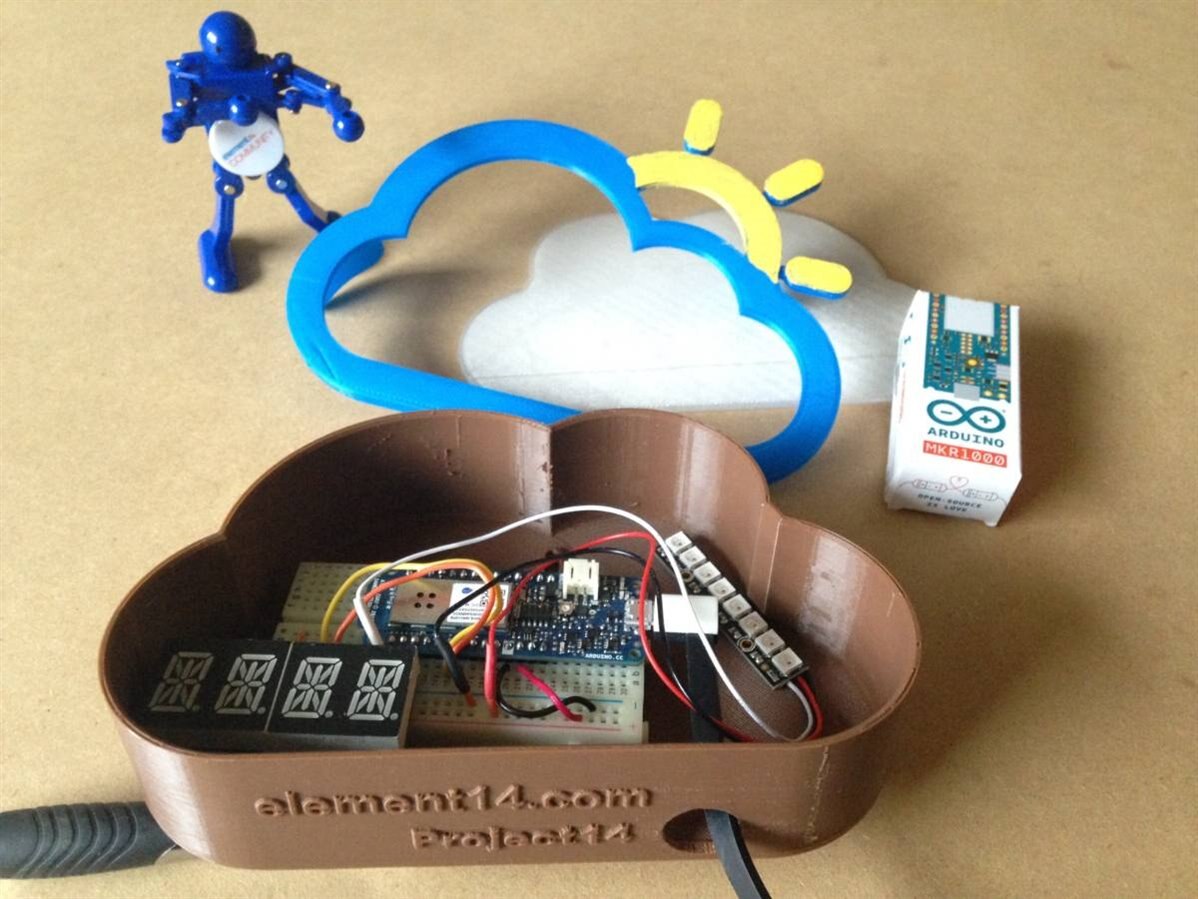

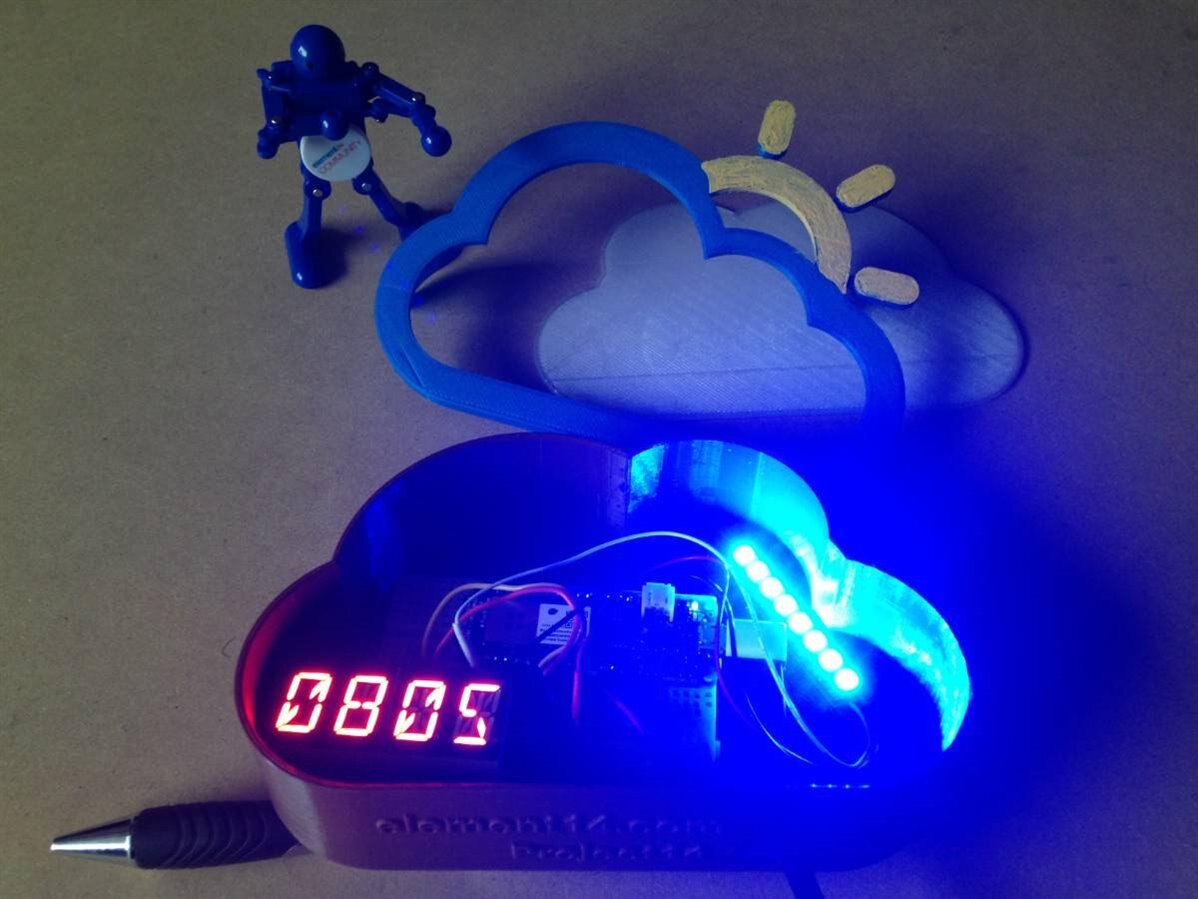

To get the components in the 3D printed enclosure I had to move from a neo-pixel ring to a neo-pixel strip and also move my wiring on the bread boarding wire.And I also painted the 'sun' area on the 3D printed part yellow with a paint pen.
And then uploaded code to the Arduino MKR1000, and also used hot glue to secure the components.Finally punched a nail in the wall to hang the Weather Cloud clock image..
{gallery} Adding the electronics to 3D printed parts
Added electronic components to the 3D printed part

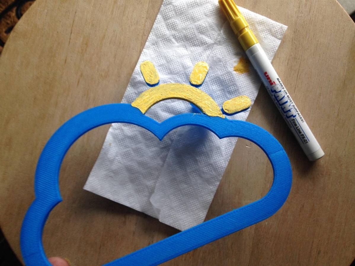

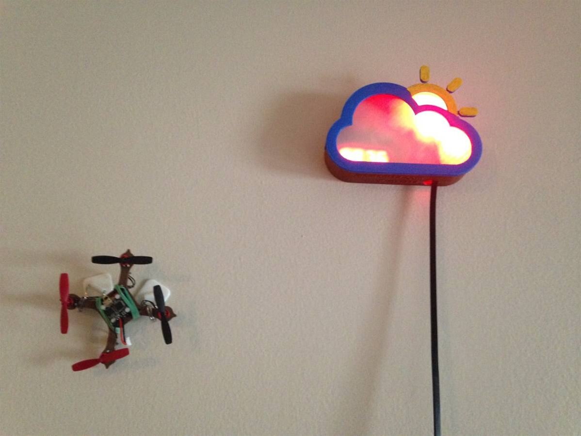

Panting the Sun...

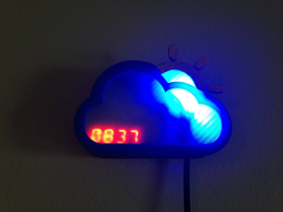

Testing the code - it is raining outside..

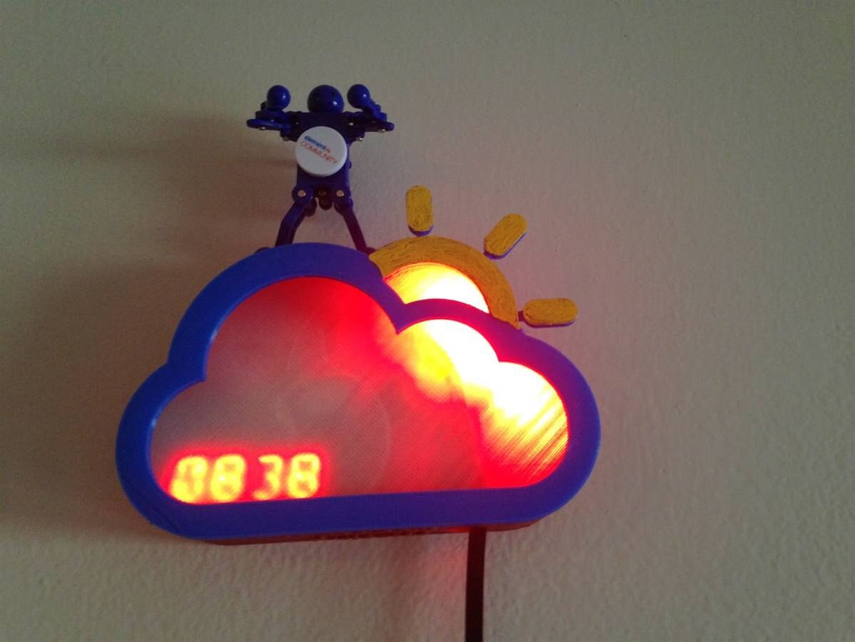

Weather Cloud clock Nailed to the wall
Weather clock cloud - a better picture,was struggling to get a picture with the blue color, manually updated code to set Neo-Pixels to red.

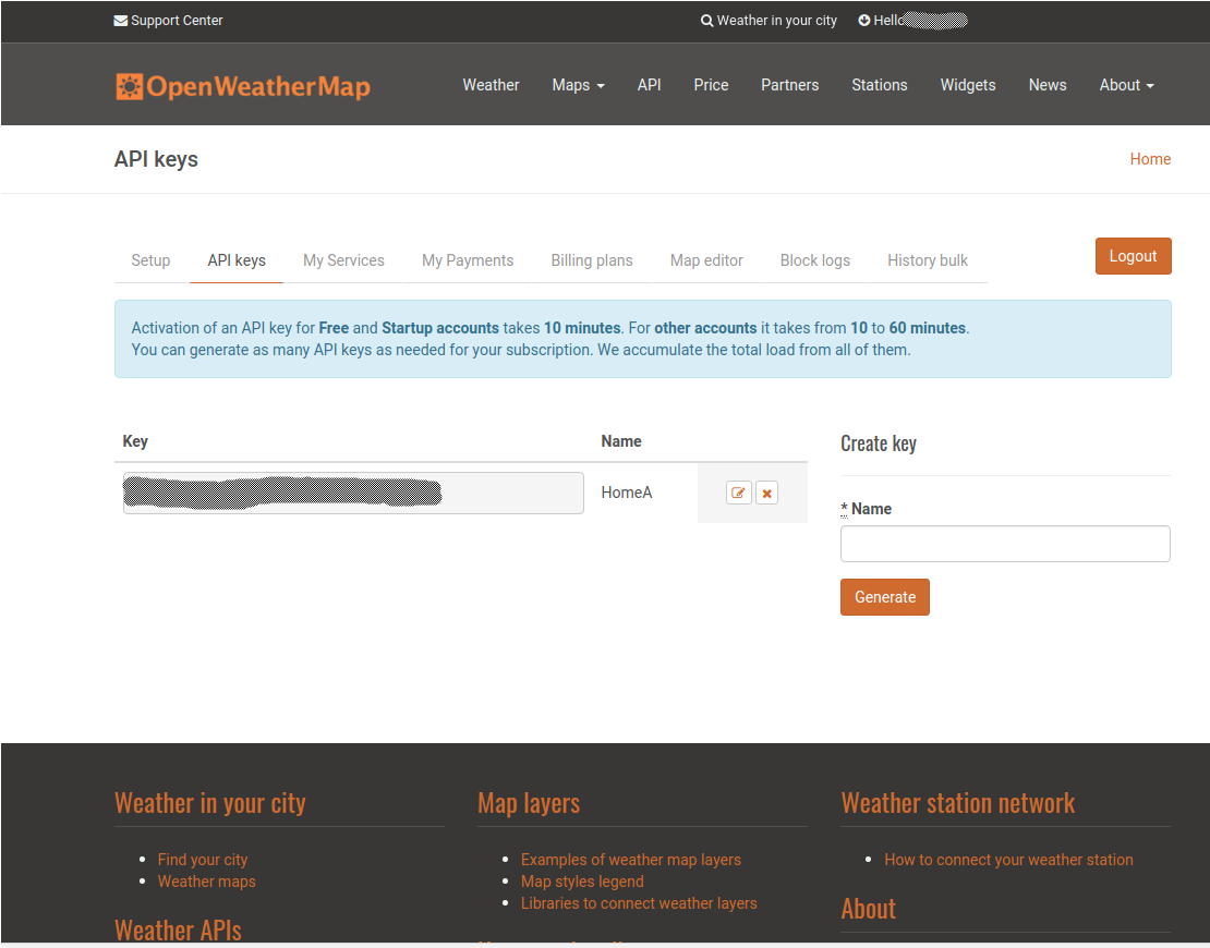

Before uploading the code to the Arduino MKR1000, create an account on https://openweathermap.org/  and then generate and make a note of the API key.
In addition, you will also have to update the following variables in the Arduino code below
  • WiFi Router SSID
  • WiFi Router password
  • APIKEY from the screenshot above from openweathermap
  • CityID for the place you live in
  • Time Zone offset from GMT
