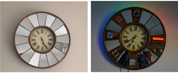

The last couple of months have been a lot of fun taking part in the challenge, and here is a quick summary of all the features I was able to implement as part of the challenge. I have managed to achieve most of the features I initially  planned as part of the proposal, with a couple of deviations. And, with the build of the clock and circuit completed, this put me in a good position to add more software features to the clock in the future. Here is an before and after picture side by side

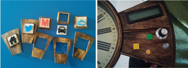

  • Visual indicator using diffusion panels - as part of the build five glass panels were switched out for 3D printed LED diffusion panel, which are meant to give an visual indicator when I wake up in the morning. Here is a brief description of the panels -
    • Weather - this lights up based on the weather conditions from openweathermap.org. Yellow for sunny, blue for rainy and white for cloudy.
    • Traffic – based on the Google Maps Distance Matrix API, gives me an indicator if I need to leave early because of heavy traffic.
    • Twitter - this will be set to blue , if the hashtag that I am tracking has been used more that 5 times  in a tweets today on the twittersphere.
    • Gmail - this panel will light up red, if I have more than 10 unread messages, and green if less than 10.
    • Home - this panel is to monitor values from the Air quality and Temperature sensors connected to the back of the clock.
  • Getting more info from the LCD panel -  there are two more glass panels that were replaced on the clock to house an Grove LCD and two buttons and a potentiometer, which are used to set alarms, show the weather condition, temperature and humidity outside, and also show temperature and air quality sensor values. In addition, you can also get the IP address assigned to the Intel Edison just in case you have to ssh in for maintenance,  and also switch off/on you phillips-hue smart bulbs at home.

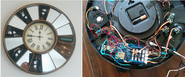

Electronics and Upcycling the clock
Here are the list of sensors used as part of the build, connected to the Intel Edison Arduino board
Pin#
Sensor connected
A0 Potentiometer which is used to control features on the clock and display things like weather condition, Temperature etc.
D2 Top green button
D3 Yellow button at the bottom
D5 Grove buzzer sensor for sounding the Alarms
D11 Data line of the LED strip (APA102)
D13 Clock line of the LED strip
A1 Grove Air quality sensor v1.3
A2 Grove temperature sensor
A3 Grove Light sensor
I2C
A4, A5
Grove RGB LCD display connected to the I2C connector on the Grove shield
In addition, I am using Adafruit’s Stereo 3.7W Class D Audio Amplifier - MAX98306 with a 4 ohms 3 watt speaker connected to the USB sound card, which you see on the left of the picture above. But I should have ideally gone with Adafruit Mono 2.5W Class D Audio Amplifier - PAM8302, since I am using only one speaker,which means I will have to order one later.
To power the Intel Edison, I am using the power adapter that came in as part of the kit that is Triad Magnetic Power Supply 1 Output 24 W 12 V,2 A .And to power the LED strip I am currently using another power adapter 5V and 2.5 A.
As part of the build,I had to remove the glass panels and replace them with something that would not impact the rustic look and aesthetic of the old clock. So, I set-out and designed the panels in Autodesk Fusion 360 and 3D printed them in Sunlu wood filament , which I then sanded and stained using Mirmax Wood finish. And for the LED diffusion parts of the panel were dual 3D printed using Hatchbox transparent PLA, in combination with another matching color PLA.
