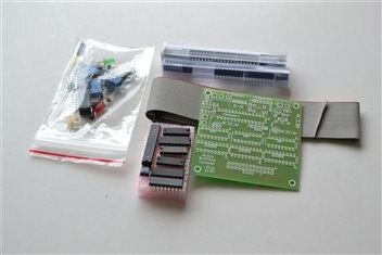

Hardware
The electronics is based on an Arduino, some latches, RTC and LED strip lights.
These are fitted inside a housing to illuminate the various words that spell out the time.

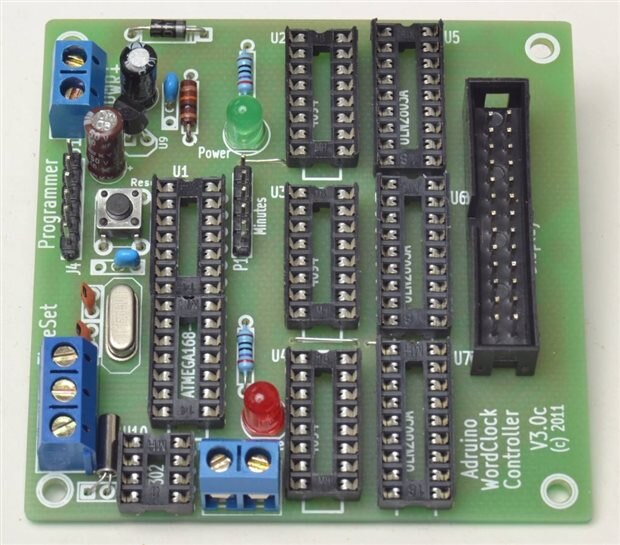

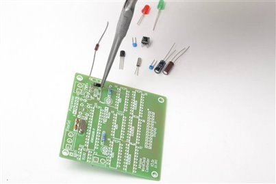

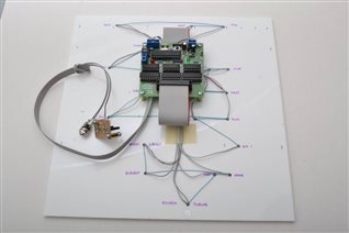

I started with the electronics first.
I'm not going to bore you with all the details but here are some of the pictures.
It's important when bending diodes to not put any pressure on the body. Use pliers to hold the diode lead and bend against the pliers.
When soldering ensure you heat the pcb pad and the wire, and then apply solder to the pcb pad/wire junction.
Eventually you end up with a completed item.

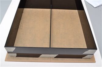

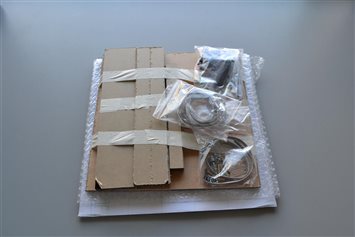

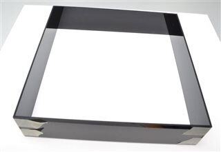

The enclosure is next.
Assemble all 4 sides and tape together so they stay put.
I used the LED mounting panel to make sure it was square.
I found using Acrylic solvent and applying with a needle and syringe was far more controllable and easier to get in the right place.
This is a near instant stick, unlike the other glues, so use with caution.

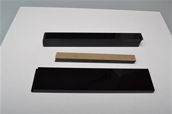

There are 7 baffles, which stop the light spilling into the next row.
The middle is first and then the others.
Use tape to hold them in place, and make sure they are square before gluing.

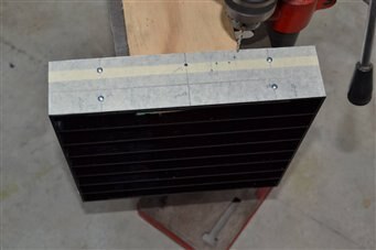

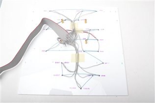

There are inner baffles between the words, and you need to add the LED strips behing each word, so I marked these by illuminating the front panel.
The LEDs get laid out, stuck down and then soldered.
Eventually the rear looks something like this

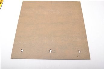

Some screw holes to hold the front and rear panels in place, pushbuttons and power, and a means of mounting it on the wall and the enclosure is assembled

He has also provided the schematic and pcb layout.

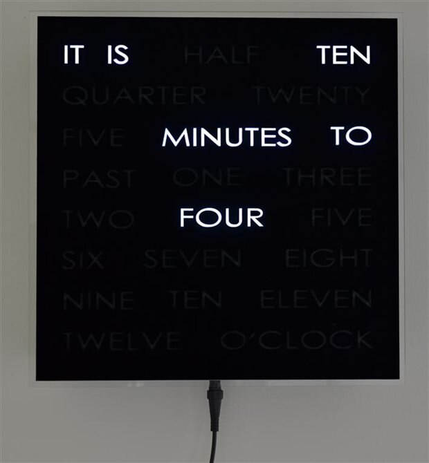

Video

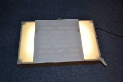

It's hard to imgine the clock without seeing it in action.
For the video I found a 9v power pack, so that the camera didn't flare out.
I'm adjusting the time setting to show a time sequence ... otherwise it would be a very long or highly sped up video.
