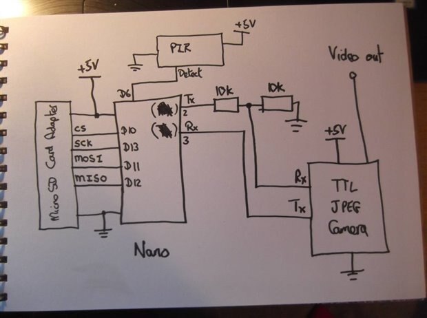

Having satisfied myself that my serial JPEG camera was working I have now implemented a fully working system that will detect cats (or any other warm blooded object), take a snapshot using the serial JPEG camera and save the image to a microSD card for later analysis.
The circuit diagram is show below and consist of a Nano connected to a microSD card adapter using the SPI bus, a PIR detector connected to D6 of the Nano and the serial JPEG camera connected  via a software serial link using D2 and D3. There is also a 12V lead acid battery for all night operation with a 12V to 5V convertor (not shown) on the circuit diagram.

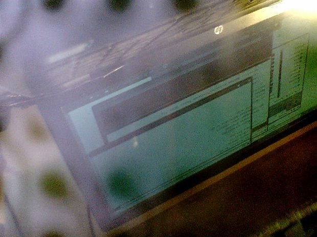

So the only pictures I have are test ones of me waving my hand in front of the PIR detector and the subsequent snapshot saved to microSD. The picture is just of my laptop screen which was just what the camera happened to be pointing at. There is blurring because as I explained in my previous Blog when I was first testing the camera, I seem to somehow have embedded a previous image as some sort of 'watermark' into all subsequent images. One day I'll spend some time trying to get rid of this.  Still it shows that it all works. I think the pictures will be quite good once the camera is setup properly, altohugh I'm not sure how well it will work at night.
Getting the serial JPEG camera to talk to the Nano proved to be troublesome for me. The documentation advises the use of a hardware serial communication port if one is available. As the Nano does have hardware serial (for connecting to the IDE and programming) I just somehow assumed it could also connect to the camera as well. But it cannot which I only realised in bed one day as I as despairing of ever getting it to all work together. As soon as I implemented a software serial port it worked fine.
