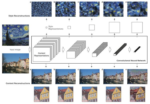

Among the many applications a neural network can be applied to, there is an interesting field called Neural style transfer. This term refers to an algorithm that takes as input a content-image (e.g. a tortle), a style-image (e.g. artistic waves) and return the content of the content-image as if it was ‘painted’ using the artistic style of the style-image. This technique was initially proposed by Gatys et al in 2105 and the good things is that it does not require any new foundation: it just uses well-known loss functions. In short we define two loss functions, one for the content (DC) and one for the style (DS). DC measures how different the content is between two images, while DS measures how different the style is between two images. Then, we take a third image, the input, (e.g. a with noise), and we transform it in order to both minimize its content-distance with the content-image and its style-distance with the style-image.
Johnson et al. (2016) built on the work of Gatys et al., proposing a neural style transfer algorithm that is up to three orders of magnitude faster. The Johnson et al. method frames neural style transfer as a super-resolution-like problem based on perceptual loss functions. While the Johnson et al. method is certainly fast, the biggest downside is that you cannot arbitrarily select your style images like you could in the Gatys et al. method. Instead, you first need to explicitly train a network to reproduce the style of your desired image. Once the network is trained, you can then apply it to any content image you wish. You should see the Johnson et al. method as a more of an “investment” in your style image — you better like your style image as you’ll be training your own network to reproduce its style on content images.
Johnson et al. provide documentation on how to train your own neural style transfer models on their official GitHub page.
Finally, it’s also worth noting that that in Ulyanov et al.’s 2017 publication, Instance Normalization: The Missing Ingredient for Fast Stylization, it was found that swapping batch normalization for instance normalization (and applying instance normalization at both training and testing), leads to even faster real-time performance and arguably more aesthetically pleasing results as well.

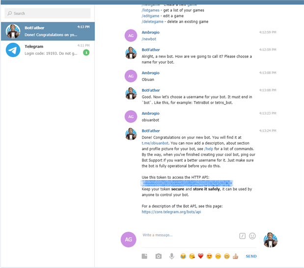

My initial plan was to install either a PiMoroni Enviro or a PiMoroni Automation hat to get some feedback from the environment that could have been "merged" into the picture, but there was some mechanical issues with the supports of the plexyglass case. So for the moment I put this feature in standby and I implemented instead the ability to send picture to your Telegram account. To make your Emoticam talk with you Telegram account, follow these steps
  • Search for a Telegram contact named "botfather"
  • Type "/start" to start chatting with the bot
  • Type "/newbot" to create a new bot. You will be asked to enter a name and a username for the new bot. Botfather will reply with the token you need to insert in your python script
  • Because we need to send notifications to the Telegram account, we need the unique identifier of the user. There is no easy way to find the user id but invoke a specific API to get the latest messages from the destination account and read the user id there. So in your Telegram account search the account of the newlt-created bot and send a message. Then, in your browser, open the URL https://api.telegram.org/bot<YOUR_BOT_TOKEN>/getUpdates. This will show the list of pending messages. The id we are looking for is the value of the filed "chat_id"

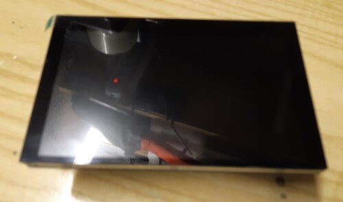

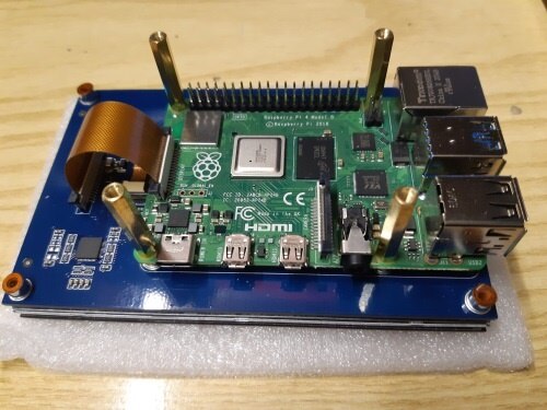

The components of the Emoticam are
  • a Raspberyy Pi 4
  • A 5" 800x480 DSI display
  • A Raspberry Pi HW camera
  • 2 mm Plexiglass

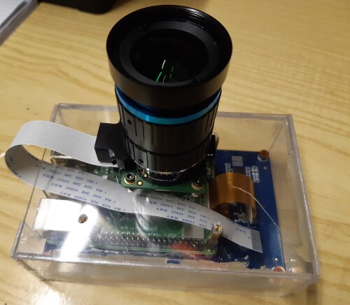

Assembly the Raspberry Pi and the display by means of four bolts as shown in picture below

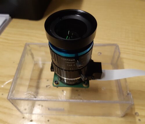

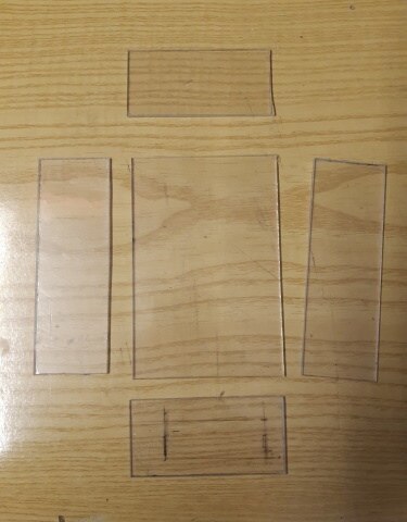

Then, you need 5 pieces of Plexyglass:
  • 12.5 x 8.6 cm
  • 12.1 x 4 cm (2 pieces)
  • 8.6 x 4 cm (2 pieces)
Glue the pieces to make a box, the drill 4 holes to fix the box to the Raspberry Pi and display assembly and other 4 holes to fix the Raspberry Pi HW camera
Use screws and bolts to keep everything in place

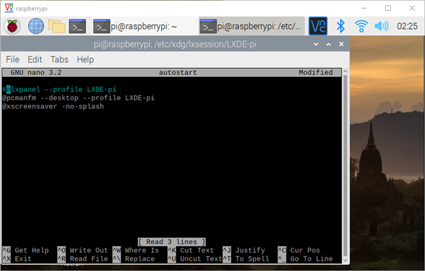

Hide desktop taskbar
The procedure to hide the desktop taskbar is quite simple
  • Open an SSH terminal
  • Go to /etc/xdg/lxsession/LXDE-pi folder
          cd /etc/xdg/lxsession/LXDE-pi
  • Edit file autostart
          sudo nano autostart
  • Comment out the line "@lxpanel --profile LXDE-pi" by inserting a "#" character at the start of the line
  • Press CTRL-X to save changes and exit the editor

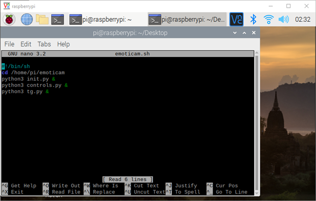

Create the script
To run the three Python scripts that makes up  the Emoticam, I created a small script and saved it into the folder /etc/init.d, where all the initialization scripts are stored
The script invokes the three Python applications and makes them run in background (see the "&" at the end of each line)
#!/bin/sh
cd /home/pi/emoticam
python3 init.py &
python3 controls.py &
python3 tg.py &
Be sure to give the file you just created execution permission
     sudo chmod +x /etc/init.d/emoticam.sh
