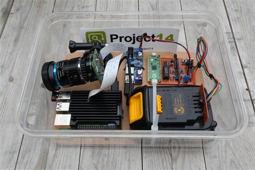

  • Development of the Nemo Discovery Apparatus
    • RPI 4B and HQ Camera Kit - Finding Nemo - Camera
    • Waterproof and submersible - Link(Finding Nemo - Vessel)
    • Battery operated - Finding Nemo - Power

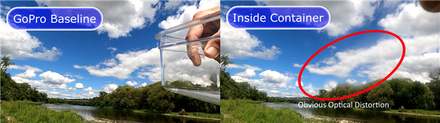

A few weeks prior to receiving my lovely new camera HQ kit, I took my GoPro and a waterproof food container down to the river as trial run. This trial was simply just a camera in a food sealed food container. Surprisingly, the image quality was better than I had expected. The image below shows a photo from the camera before and after being placed inside a plastic container:
There is some optical distortion but for a quick and dirty lash-up, I believe the results to be quite good.

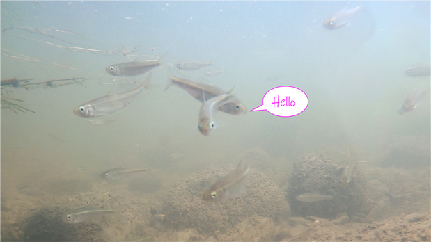

Here is a short clip of some small minnows that were stopping by to say hello:

Did we find Nemo?
Here is a sample I took with my gopro from the same location:
