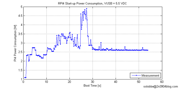

To start things off, I just wanted to get an approximate idea of what the power consumption for the RPI4 and camera would be. I connected my bench power supply to the PI4 on the GPIO header and switched on the power and logged the resulting power consumption.
The RPI4 boots in about 30 s and has an idle power consumption of 2.6 W. Minimizing power consumption wasn’t a design goal for the RPI, so it is what it is. I am just happy I am not seeing power consumption figures in the 10 – 15 W range (that is quite high).

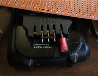

Power Tool Battery
I have only used tool battery briefly for a few minutes at time by inserting a wire or spade terminal into the packs positive and negative terminal. The ‘yellow brand’ tool manufacture does not include any protection circuitry into the battery pack, it is essentially just 5 raw 18650 cells in series to achieve their 20V Max output voltage rating. Overvoltage protection and cell balancing is the responsibility of the wall charger. Cell under-voltage protection is left to the consuming appliance, for example a cordless drill/driver. Fortunately, all of the cells are pined out on the battery connector.

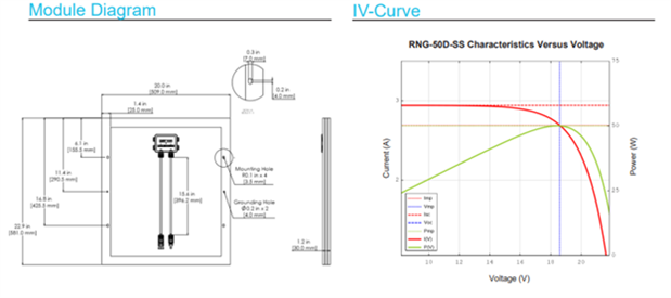

Solar Panel
This solar panel is no where near state of the art, but I believe it should certainly perform as advertised. It was priced at $70 CAD including shipping. If you were to subtract the included shipping cost, the panel would be priced at a little over a $1/W, I think that’s fair.
The dimensions of the panel should be similar to say a large backpack.
https://www.renogy.com/content/RNG-50D-SS/50D-SS-Datasheet.pdf
The panel may appear to be overkill for the application, but in reality, on a dark cloudy day this panel might output a mere 5 W or less. Assuming the PI runs under 5W this panel should be large enough to run the PI4 irrespective of weather conditions.
Even a few hours before solar noon with non-ideal mounting geometry the panel was capable of upwards of 40W. I haven't yet traced the actual IV curve. Regardless this is ample power to operate the PI and simultaneously charge a battery bank.

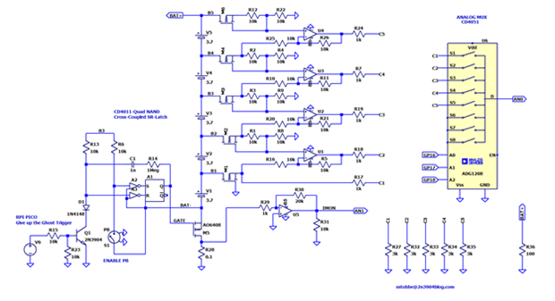

One of the downsides of using Li-Ion batteries is having to ensure the cells are operated within their safe operating parameters (voltage, current, temperature, etc.). Conversely, it’s also an opportunity to have some analog fun. The design presented here is somewhat atypical in that most of the telemetry and control circuitry is referenced to the system ground versus the battery negative terminal. This is done to reduce the quiescent current to essentially nanoamps when the system load is switched off. The only circuitry continually powered by the battery is a CMOS SR-Latch driving a low-side NFET for discharge control. A simplified schematic of the analog portions of the circuit are shown in the schematic below:

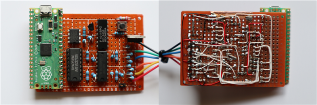

With over 40 resistors and 50 nets on a small little perfboard, the final build looks more like a rats-nest than a work of art.
Once I decide on a final sample rate for the PICO, I can add some filter capacitors to the frontend amplifiers.
The SR-Latch is realized with a pair of 2-input CMOS NAND gates from a CD4011. A cross-coupled NAND SR-Latch has inverting inputs which is a great benefit to this circuit, as when the RPI Pico decides its time to give up the ghost it only needs to signal an output-low with an open-collector driver Q1. A momentary push-button signals the latch to SET, thereby enabling the discharge NFET M5.

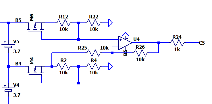

Differential Amplifier
The differential amplifier is textbook unity-gain difference amplifier. The positive and negative inputs sample across one desired cell from the battery.
The natural choice for a quad-opamp with a 20+ V supply rating is the LM324.
All the inputs have ideal diodes to prevent any leakage or cross-cell conduction when the telemetry circuitry is powered down.

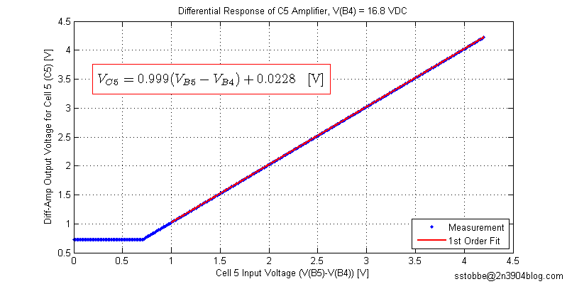

Testing the difference amplifier for cell-5 involved biasing the the negative input to 16.8 VDC. Then proceeding to sweep positive input terminal from 0 V to 4.2V, simulating a cell under test.
Almost unity-gain! The offset voltage of 22.8 mV is actually mostly due to the effective CMRR of the circuit (which should mostly be due to resistor mismatch).

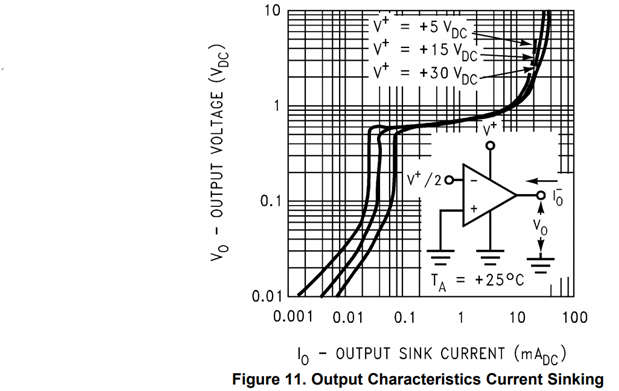

The first 800 mV plateau is due to the output stage of the LM324 clipping against the ground rail. The LM324 will only swing to 1Vbe + 1Vce sat to the negative supply while sinking any appreciable load, roughly 800 uA in this case from R25 & R26.

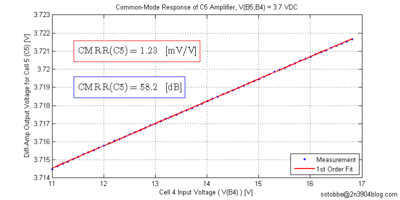

To test the common-mode response of the amplifier, I biased the differential input to a constant 3.7 V and swept the negative input potential from 11 V to 16.8V.
Sometimes you just get lucky. Getting a DC CMRR of 58 dB with 1% rated resistors and an LM324 made my day :).

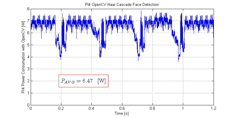

I was able to get this OpenCV tutorial https://docs.opencv.org/3.4/db/d28/tutorial_cascade_classifier.html  running on the PI4. The program executed at approximately 4 FPS. I then logged the output of the current sense amplifier with my oscilloscope. The figure below shows the power consumption of the entire system including DCDC converter losses while running an OpenCV application:
As long as the sun is shining, the 50W solar panel could easily power the PI. On battery power alone, the current battery pack would have a runtime of approximately 4.5 hours.
