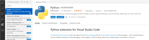

First, we will need to set up the development environment for the Raspberry Pi. While the Pi comes with Thonny, Thonny is vastly inferior to Visual Studio Code, which has a powerful PyLance extension.
You will need to go to VScode>Marketplace, search Python, and install the extension from Microsoft.

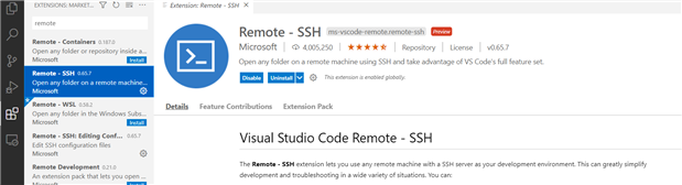

You will also need Remote - SSH, also from Microsoft.
Once this is done, connect to your Raspberry Pi! Make sure it's connected to your network + has SSH enabled(adafruit has a great guide on this Overview | Raspberry Pi Zero Headless Quick Start | Adafruit Learning System)
