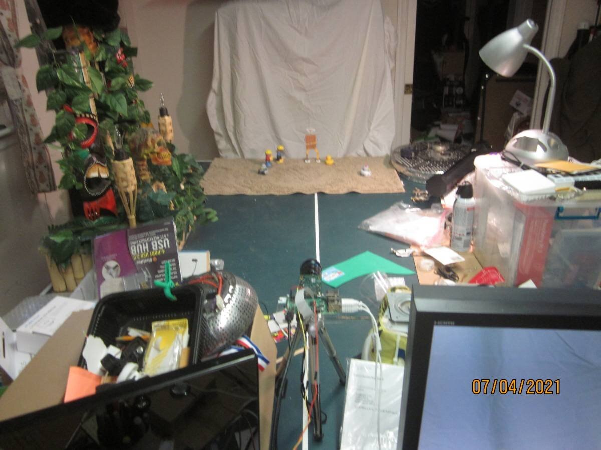

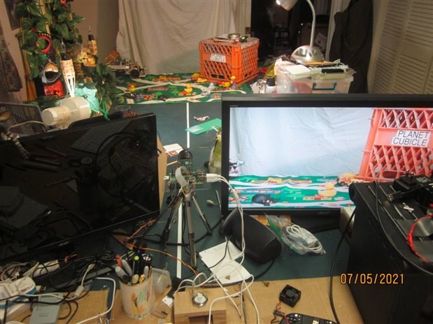

Before shooting, I came up with a storyboard, and then had to setup the stage for each scene.
As the scenes were videoed, new ideas came up, some challenges required scene changes, and of course some concurrent engineering :-)

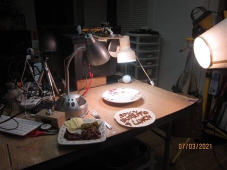

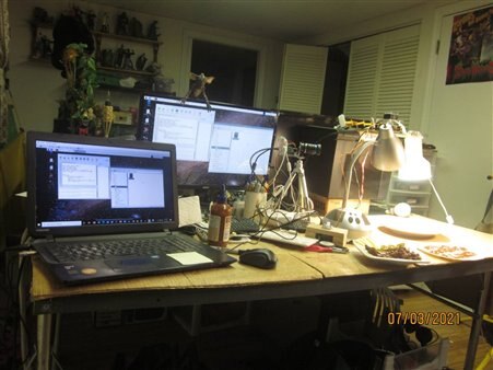

Photo sessions and editing were very time consuming. I used the RPi as the photo taker and real time video monitor.
At the end of each photography session, I'd WinSCP into the RPi from my W10 PC , fetch the frames taken, backup and create a quick mp4 for checking for bad frames, inconsistent frames, and video flow.  After the video was all stitched together, then soundtracks added.

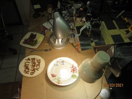

The burrito scene setup:
The set for the Star Trek scene.
The set for the fiery butt launch scene
