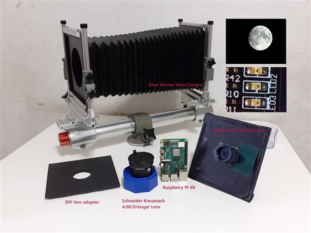

Close-up photography with the Raspberry Pi HQ Camera
In the previous blog I ended up photographing the Moon with the adaptation of the view camera with a large telephoto using a Raspberry Pi HQ CameraRaspberry Pi HQ Camera and a Raspberry Pi 4BRaspberry Pi 4B.
Now we are going to try macro photography using a lens used to print 6x6 cm medium format negatives.

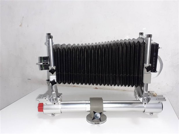

Normal-type view camera lenses like the ones used in the previous blog, Raspberry Pi HQ View Camera - From the roof to the moon, can be used at moderately short object distances before objectionable degradation of the image occurs.
In the past other types of lenses have been used on view cameras for close-up photography of small objects: process lenses, enlarger lenses and magnifying lenses like focussing magnifiers.

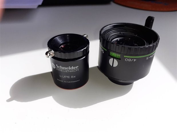

Schneider Kreuznach Componon-S 4,0/80 mm and Schneider Kreuznach Lupe 8x
We will use a high quality Schneider Kreuznach Componon-S 4,0/80 mm. The Schneider 80mm Componon-S is one of the top professional enlarging lenses. It is a 6-element, 4-group lens that is corrected for flat field, high contrast transfer, and excellent definition over the whole field.
The 80mm lens provides coverage up to a 6 x 6 cm format negative.The high performance of the Componon-S is maintained even at high magnifications. This Componon-S lens has a M39 rear mount thread, and is fitted in to a barrel with a lighted click stop aperture scale. With this system the iris can be opened after stopping down to the desired aperture for final cropping adjustment or fine focusing. A lever then returns the iris to the previously selected working aperture shown on the luminous scale.
For macro photography, the enlarger lenses are mounted in reverse. An enlarger lens is specifically designed to project light through a flat negative onto a sheet of printing paper.
So if used in reverse, the enlarger lens is perfectly designed to project an image onto a flat digital sensor. We have tested it in both ways and for 80mm and the size of the small sensor of the Raspberry Pi HQ Camera there is hardly any difference to put the lens in reverse or not.
All the photos below are taken with the lens mounted in the normal position, without inversion. This has made it easier for me to focus with maximum aperture and to be able to close a couple of f-stops in the final shot.

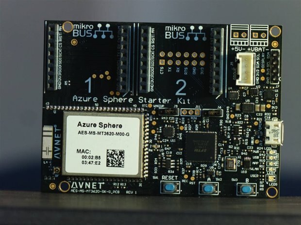

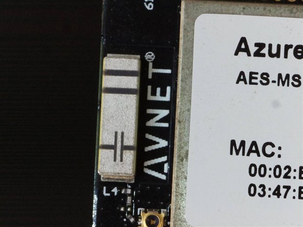

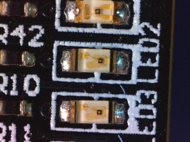

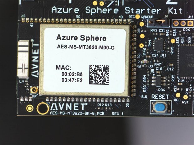

Azure Sphere Starter Kit close-ups
We tested the lens in normal position without reverse mounting.
We started by taking a series of close-up photos of an Azure Sphere Starter KitAzure Sphere Starter Kit board

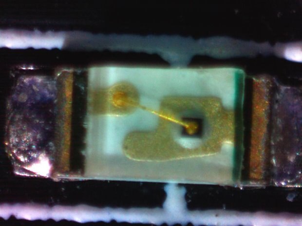

We get a little closer.
and closer
and much closer
and we're already starting to have trouble keeping focus

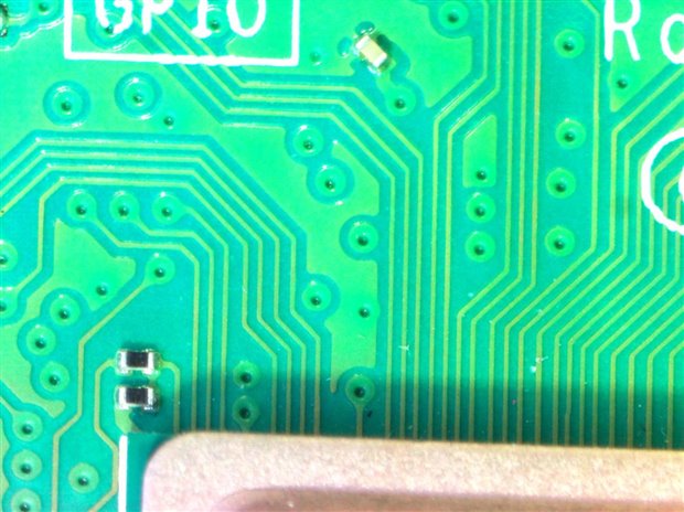

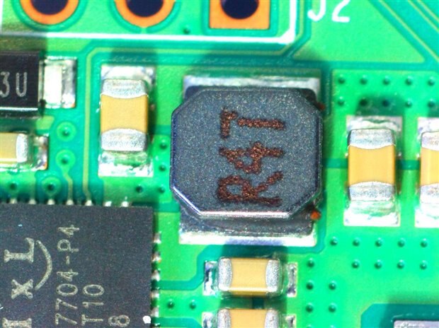

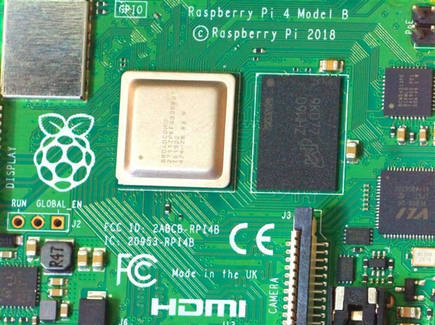

Raspberry Pi 4B close-ups
Some more photos of the Raspberry Pi 4B boardRaspberry Pi 4B board

Conclusions
We have been able to verify the use of the Raspberry Pi HQ Camera module for both telephotography and macro photography with lenses that were not designed for this camera with very satisfactory results for personal use.
The Raspberry Pi HQ Camera module is a very versatile module. Although it is not enough for professional photography, it gives very good results for web illustration.
