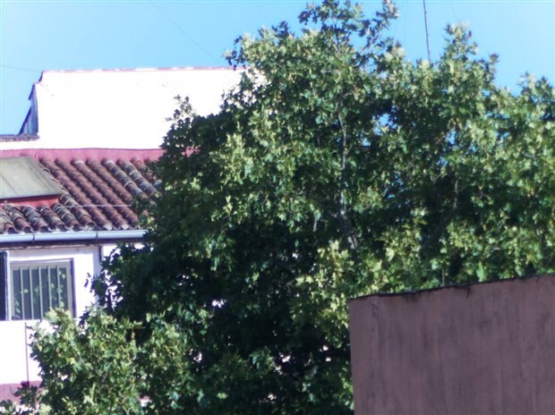

I try with the most angular lens that I have a 65 mm focal length lens that for 9x12 is a wide angle lens but for the small 6 x 4 mm sensor of the Raspberry Pi HQ Camera it becomes a powerful lens telephoto. I take a photo of a very distant object.
It was windy and the sycamore's leaves were constantly moving. The effect on the camera sensor is curious.
And with the same settings I take a photo of a closer object. And with the same settings I take a photo of a closer object. I still do not know the options of the raspberry pi hq camera well. I hope to improve the next shots.
It is grainy but the result is surprising because the photo is taken in the shade without additional lighting.
