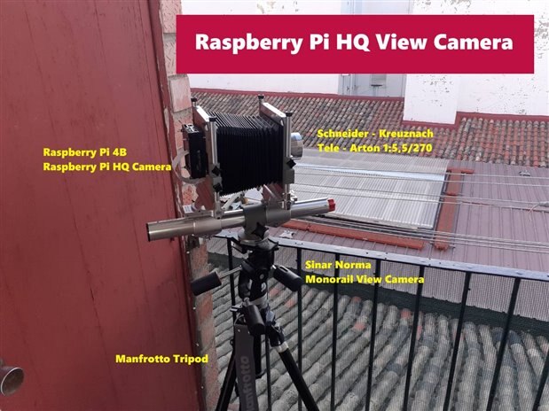

The Raspberry Pi HQ View Camera is a camera with a Raspberry High Quality CameraRaspberry High Quality Camera module and a Raspberry Pi 4BRaspberry Pi 4B attached to an old large-format mono-rail view camera. For now powered by a Raspberry Pi power supplyRaspberry Pi power supply until I find a suitable powerbank to power both the raspberry and the raspberry HQ camera module

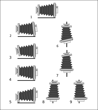

Basic view camera adjustments
1. Focusing. Changing  the distance between lens and ground glass.
2. Back Tilt. Rotation of the camera back around a horizontal axis. To control the convergence of parallel vertical lines.
3. Front Tilt. Rotation of the lens board around a horizontal axis. To control the angle of the plane of sharp focus from top to bottom.
4. Front Vertical Shift. Moves the image the same distance in the same direction on the ground glass.
5. Back Vertical Shift. Moves he image in the opposite direction the same distance on the ground glass.
6. Back Swing. Rotation of the camera back around a vertical axis. To control the convergence of parallel horizontal lines.
7. Front Swing. Rotation of the lens board and lens around a vertical axis.To control the side to side angle of the plane of sharp focus.
8. Front Horizontal Shift. Moves the image the same distance in the same direction on the ground glass.
9. Back Horizontal Shift. Moves the image the same distance in the opposite direction on the ground glass.
Additionally:
10 . Pan-and-Tilt Head: Allows the entire camera to be tilted up and down, rotated clockwise and counterclockwise ad panned 360º circle around a vertical axis using the tripod.
11. Reversible and revolving back: The ground glass and the back can be placed in either a vertical or horizontal format position.

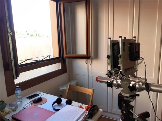

Attaching the Raspberry Pi High Quality Camera
Adaptation for attaching the Raspberry Pi 4 B and the Raspberry Pi High Quality Camera
All glossy parts should be covered with a matte black color to prevent glare from reflecting off the lens system. The flare noticeably decreases the quality of the image.
Attaching the Raspberry Pi 4B board
Front View: The module stands upright on the case of the raspberry pi 4B
Back View: The box has a fan to prevent the module from heating up.
Lateral view:
Camera attached taking the first shot with a Schneider -Kreuznach Angulon 1:6,8/65 f/6,8
