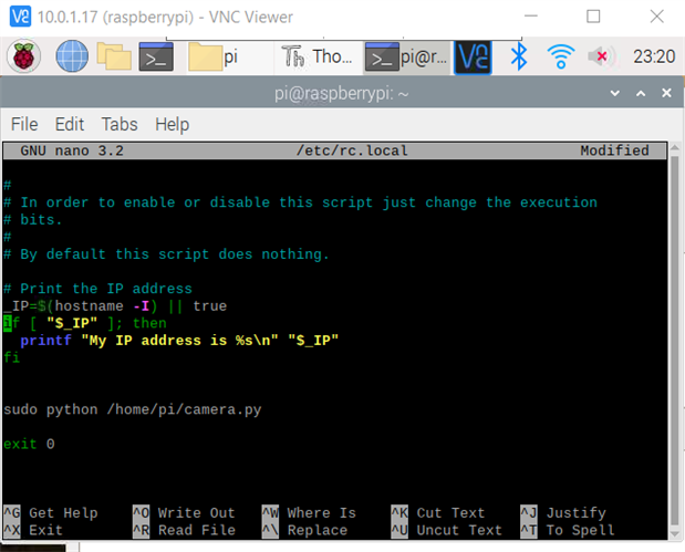

We will probably want the program to run upon boot.
One such way is rc.local.
First, we save the file(I saved as camera.py in ~/Home/Pi/)
Open up a terminal, type in
sudo nano /etc/rc.local
Now, we type in, just before "exit 0",
sudo python /home/pi/camera.py
Of course, this is assuming if you are using Python and your path to your file is /home/pi/camera.py. It may be different for you.
Now, we restart, and the program is working perfectly on boot!
