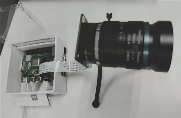

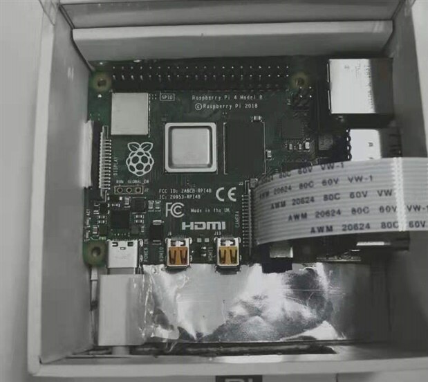

Thanks for Element14 for the Raspberry Pi HQ camera Kits. With everything needed.
The raspberry Pi 4B, one HQ camera and HQ lens.
I would like to build the codes on RaspberryPi with VIM only.
That is good enough with latest Raspbian OS buster.
3  First Demo

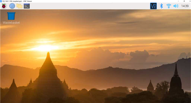

Connect the Camera and Enable the camera in raspi-config,
SSH and VNC is enable as well for me to build with SSH without the keyboard and screen. In the end, there would be not screen for the door bell.

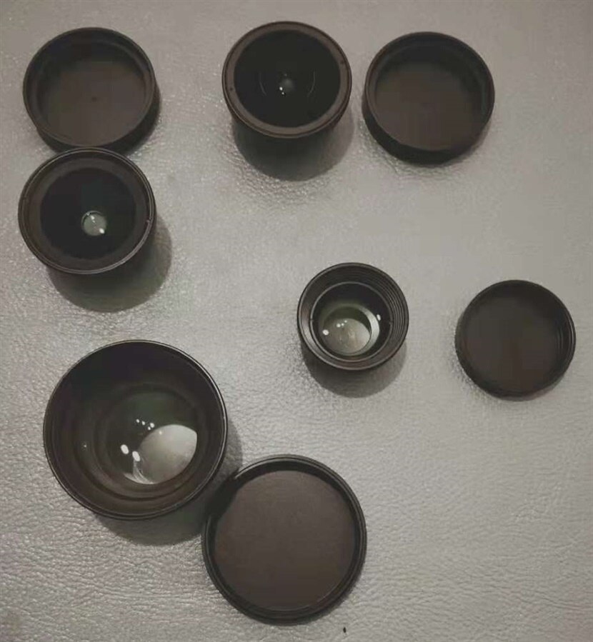

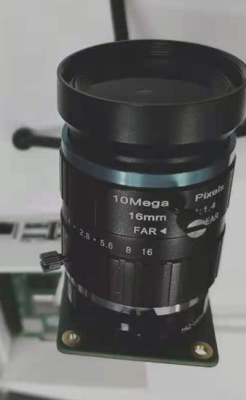

4  Lens Sets
Here is the lens I have prepared for this project. I need adapter to fit for C-socket. It takes some time to find right adapter, I think it work from Aliexpress.
I shall try Paddlelite from Baidu, enclosed all AI function with API open to dummy like me.
But it takes more time in build the lib

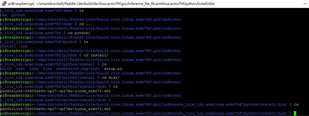

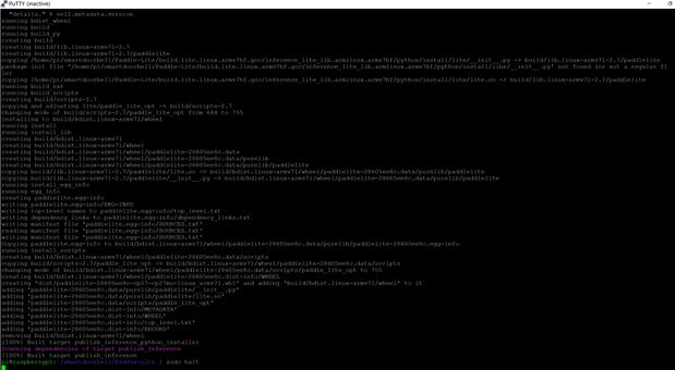

git clone https://gitee.com/paddlepaddle/paddle-lite.git
cd paddle-lite
git checkout release/v2.8
sudo ./lite/tools/build_linux.sh --arch=armv7hf --with_python=ON --python_version=3.7 --with_cv=ON
It there are erros, mke build thread into 1 take longer time, but it works
export LITE_BUILD_THREADS=1
Then install  with pip
pip install paddlelite-28605ee8c-cp27-cp27mu-linux_armv7l.whl

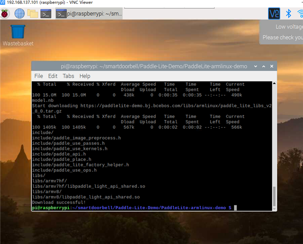

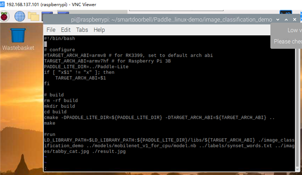

5.2 Run paddlelite-demo
git clone https://github.com/PaddlePaddle/Paddle-Lite-Demo
cd Paddle-Lite-Demo/PaddleLite-armlinux-demo
./download_models_and_libs.sh
cd Paddle-Lite-Demo/PaddleLite-armlinux-demo/image_classification_demo
Use armv7hr instead of TARGET_ARCH_ABI=armv8, since the Raspbian OS is not for armv8 now. then test the demo.
sudo ./run.sh
