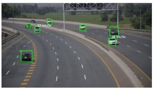

This is a small image of the solution which I have performed using a pre-recorded video and have used only Open Cv for it without a pi camera.
Vehicle-x  have a look at this gif
