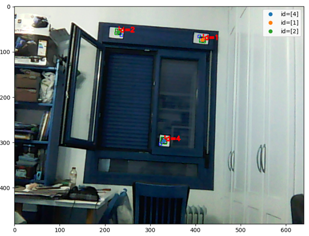

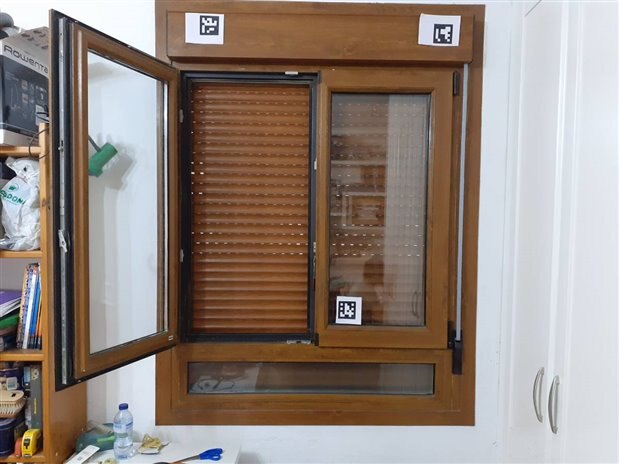

We plan to make a detector of the aperture of sliding windows for our VenTTracker Project that monitors Natural Ventilation Habits in Classrooms.
There we implemented two different methods to know the aperture of the window, one using an accelerometer module and another with a quadrature encoder made with reed magnetic switches.
The problem for both approaches is that you need a device attached to the window.
In this project we plan to use the Raspberry Pi 4 Model BRaspberry Pi 4 Model B and a camera to monitor the aperture using OpenCV and ArUco Markers positioned on the fixed and moving parts of the window.
This will allow us to monitor the aperture of several windows at the same time using only a Raspberry and a camera.

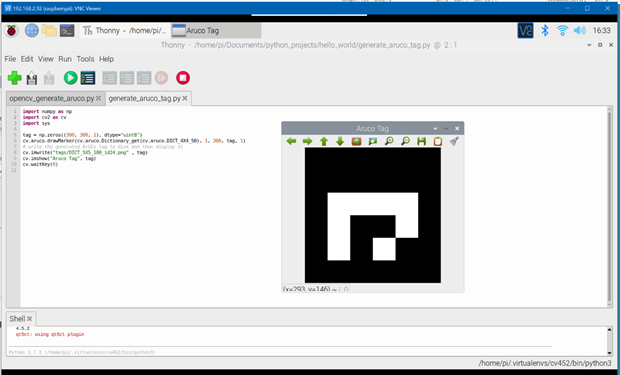

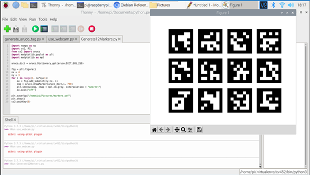

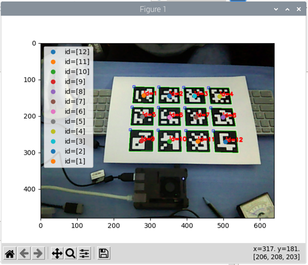

ArUco codes
AugmentedReality uco Codes These are the special augmented reality markers which have a unique identification number inside them.
These markers are decoded in binary serialization and can be decoded manually as well as by computer also.
ArUco marker is a 5×5 grid that is black and white in color.
Reference : https://docs.opencv.org/3.4/d5/dae/tutorial_aruco_detection.html

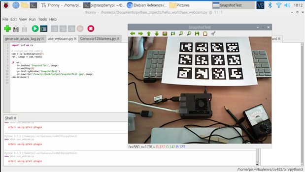

Testing with a casement window to determine the distance at which the codes are detectable with a small webcam and the Rapberry Pi 4 model B
ArUco codes from id 1 to id 4 using dictionary DICT_6X6_250

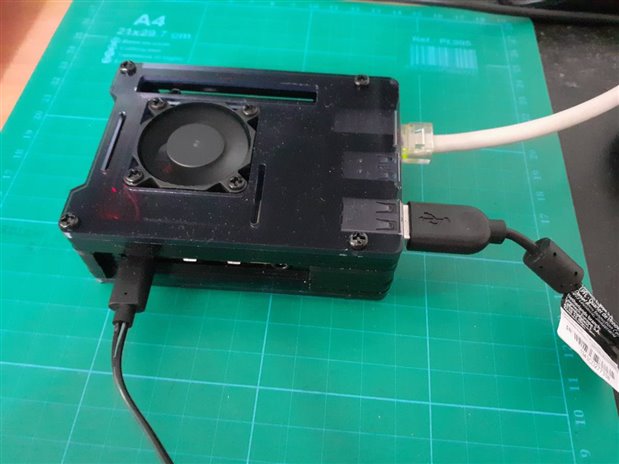

Our environment
Our configuration is as headless server. Headless server is a computer without a monitor, keyboard or mouse. They're managed by a console that has access through either SSH or telnet.
  • Raspberry Pi 4 Model BRaspberry Pi 4 Model B
  • Plastic enclosure with Four passive heat sinks and a fan
  • microSD card 16 GBmicroSD card 16 GB
  • USB Power adapterUSB Power adapter

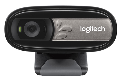

  • USB webcam Logitech c170

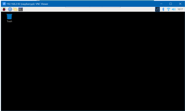

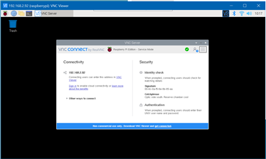

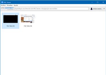

VNC Server and Viewer
We are using VNC with a HDMI virtual monitor.
Setup Real VNC Server in Raspberry PI
Setup Real VNC Viewer in Microsoft Surface

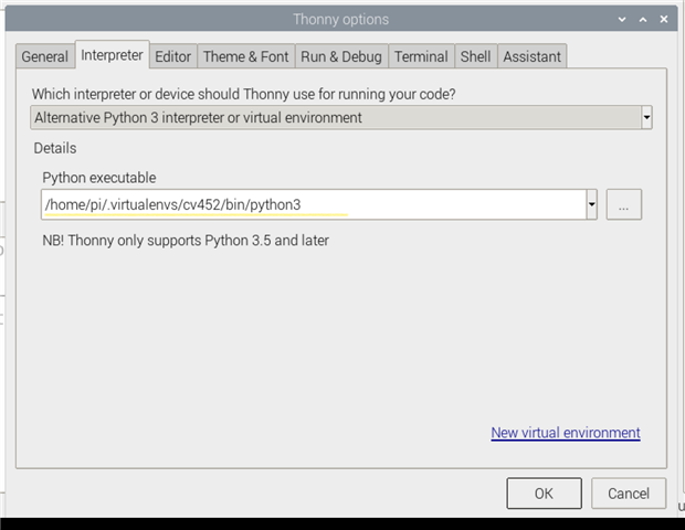

Create virtual environment

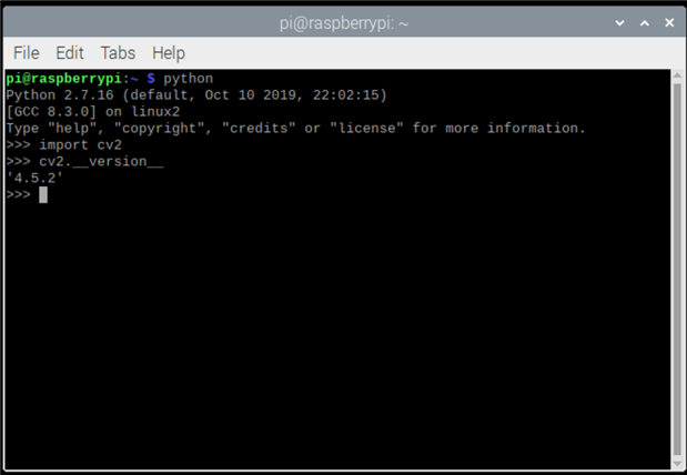

Check python version
pi@raspberrypi:~ $ python3 --version
Python 3.7.3
Get location
pi@raspberrypi:~ $ which python 3.7
/usr/bin/python
Merge VIRTUALENVWRAPPER_PYTHON=location/version
pi@raspberrypi:~ $ echo "export VIRTUALENVWRAPPER_PYTHON=/usr/bin/python3.7" >> ~/.bashrc
and then reload profile
pi@raspberrypi:~ $ source ~/.bashrc
Install the virtual environment software
pi@raspberrypi:~ $ sudo pip3 install virtualenv
pi@raspberrypi:~ $ sudo pip3 install virtualenvwrapper
Then edit bashrc
pi@raspberrypi:~ $ echo "export WORKON_HOME=$HOME/.virtualenvs" >> ~/.bashrc
pi@raspberrypi:~ $ echo "source /usr/local/bin/virtualenvwrapper.sh" >> ~/.bashrc
With the command mkvirtualenv, a virtual environment is set up for the OpenCV installation.
pi@raspberrypi:~ $ mkvirtualenv cv452
created virtual environment CPython3.7.3.final.0-32 in 1281ms
  creator CPython3Posix(dest=/home/pi/.virtualenvs/cv452, clear=False, no_vcs_ignore=False, global=False)
  seeder FromAppData(download=False, pip=bundle, setuptools=bundle, wheel=bundle, via=copy, app_data_dir=/home/pi/.local/share/virtualenv)
    added seed packages: pip==21.1.2, setuptools==57.0.0, wheel==0.36.2
  activators BashActivator,CShellActivator,FishActivator,PowerShellActivator,PythonActivator,XonshActivator
virtualenvwrapper.user_scripts creating /home/pi/.virtualenvs/cv452/bin/predeactivate
virtualenvwrapper.user_scripts creating /home/pi/.virtualenvs/cv452/bin/postdeactivate
virtualenvwrapper.user_scripts creating /home/pi/.virtualenvs/cv452/bin/preactivate
virtualenvwrapper.user_scripts creating /home/pi/.virtualenvs/cv452/bin/postactivate
virtualenvwrapper.user_scripts creating /home/pi/.virtualenvs/cv452/bin/get_env_details
(cv452) pi@raspberrypi:~ $

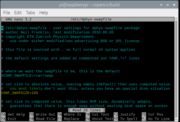

Enlarge memory swap space temporally
Enlarge memory swap space to 2048 MByte. We need that fo the build process. After the make we'll have to reset the swap space back to its original 100 Mbyte. Flash memory can only write a limited number of cycles. In the end, it will wear your SD card out. It is therefore wise to keep memory swapping to a minimum.
Edit /etc/dphys-swapfile with nano:
(cv452) pi@raspberrypi:~/opencv/build $ sudo nano /etc/dphys-swapfile
And change CONF_SWAPSIZE to 2048. <Ctrl-X>, then Y and ENTER

Resetting the swap space back to its original 100 Mbyte
<CTRL-X> [Y] [Enter]

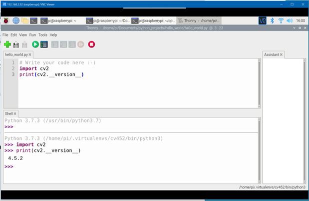

Check the installation
Lets check from python3
More cleaning

Get Build Information
Python 2.7.16 (default, Oct 10 2019, 22:02:15)
[GCC 8.3.0] on linux2
Type "help", "copyright", "credits" or "license" for more information.
>>> import cv2
>>> cv2.__version__
'4.5.2'
>>> print(cv2.getBuildInformation())

Set Thonny
Interpreter:                 /home/pi/.virtualenvs/cv452/bin/python3 (ver 3.7.3)
Generate Aruco Tag
import numpy as np
import cv2 as cv
import sys
tag = np.zeros((300, 300, 1), dtype="uint8")
cv.aruco.drawMarker(cv.aruco.Dictionary_get(cv.aruco.DICT_4X4_50), 1, 300, tag,$
# write the generated ArUCo tag to disk and then display it
cv.imwrite("tags/DICT_5X5_100_id24.png" , tag)
cv.imshow("Aruco Tag", tag)
cv.waitKey(0)
Generate 12 markers
import numpy as np
import cv2, PIL
from cv2 import aruco
import matplotlib.pyplot as plt
import matplotlib as mpl
aruco_dict = aruco.Dictionary_get(aruco.DICT_6X6_250)
fig = plt.figure()
nx = 4
ny = 3
for i in range(1, nx*ny+1):
    ax = fig.add_subplot(ny,nx, i)
    img = aruco.drawMarker(aruco_dict,i, 700)
    plt.imshow(img, cmap = mpl.cm.gray, interpolation = "nearest")
    ax.axis("off")
plt.savefig("/home/pi/Pictures/markers.pdf")
plt.show()
cv2.waitKey(0)
Capturing image with the webcam
import cv2 as cv
# initialize the camera
cam = cv.VideoCapture(0)
ret, image = cam.read()
if ret:
    cv.imshow('SnapshotTest',image)
    cv.waitKey(0)
    cv.destroyWindow('SnapshotTest')
    cv.imwrite('/home/pi/book/output/SnapshotTest.jpg',image)
cam.release()
Processing the image
import numpy as np
import cv2 as cv, PIL
cam.release()
if ret:
    gray = cv.cvtColor(image, cv.COLOR_BGR2GRAY)
    parameters =  aruco.DetectorParameters_create()
    corners, ids, rejectedImgPoints = aruco.detectMarkers(gray, aruco_dict, parameters=parameters)
    frame_markers = aruco.drawDetectedMarkers(image.copy(), corners, ids)
    plt.figure()
    plt.imshow(frame_markers)
    for i in range(len(ids)):
        c = corners[i][0]
        plt.plot([c[:, 0].mean()], [c[:, 1].mean()], "o", label = "id={0}".format(ids[i]))
    plt.legend()
    plt.show()
Reading the codes remotely with a webcam
