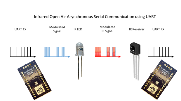

This blog describes how infrared receivers such as the Vishay TSOP38238TSOP38238 work and rather than using a library or built-in hardware it describes an oddball way of wireless communication of my own design. A microcontroller will be used to turn UART transmissions into a modulated signal which can then be read into UART on the receiving microcontroller using the TSOP38328.  While located with the Photonics Project14 Photonics entries, it is not an official entry and it is not my intention to have it eligible for a prize.

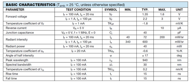

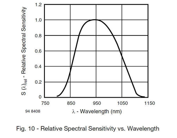

TSAL6200TSAL6200 IR LED
For this design the Vishay TSAL6200TSAL6200, a 5 mm through hole LED is used.  This is the same one used in the datasheet for the receiver.  The basic characteristics taken from the datasheet dated 13 Mar 2014 are as follows:
Note that the peak wavelength is as desired and the spectral bandwidth is quite narrow as desired.  The relative radiant intensity is fairly narrow which could be an issue but in my design I drove a number of LEDs with a MOSFET so there was increased power and no problems were encountered.

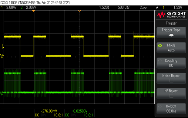

The serial output from the microcontroller is routed to input P1.0 which triggers an interrupt whenever the input signal transitions from high to low or low to high.  If it triggers high, than a PWM timer operating at 38 kHz outputs on pin P2.0 to the IR LED.  If it triggers low, then the PWM timer on pin P2.0 is stopped.  This modulated signal is then picked up on the TSOP 38238 which can be decoded by a microcontroller or in this case displayed on an oscilloscope.

Here is an oscilloscope screenshot that better shows the modulation and decoding.
