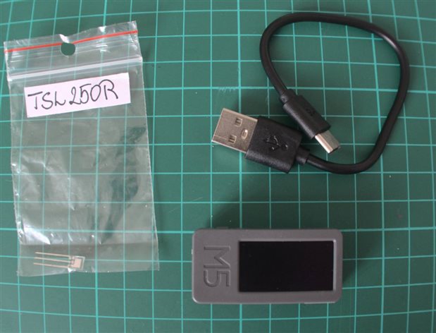

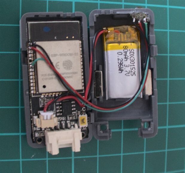

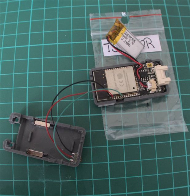

The basic idea was to create a simple device which allow to compare the quality of light sources e.g. LED bulbs. I have used TSL250R IC containing photodiode and operational amplifier with configured feedback loop. This IC is optical sensor which output voltage is proportional to light intensitivity. I have put this sensor inside to M5Stick case and connected directly to ESP32 module. Output from sensor is connected to GPIO with number 35. Below there are images with mounted sensor:

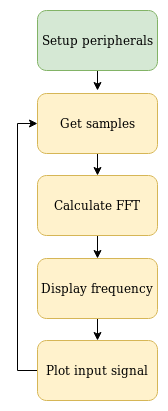

Output data is sampled by ADC which is triggered by hardware timer of ESP32 board.
After sampling there is calculated FFT. After that there is obtained frequency for maximum peak.
Additionally there is displayed a plot with input data, so we could see amplitude of input signal.
All data are presented on OLED display.
Below there is diagram with flow:
