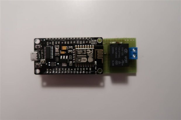

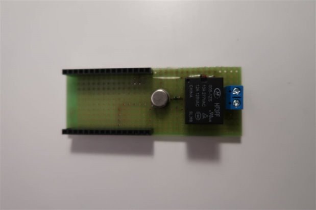

I would like to present simple circuit which allow to control device via relay with usage of web server running on ESP8266 board. The main component is ESP8266 board which allow to run script in LUA language. This ESP8266 board is connected with relay module via pin headers. Here is relay module:

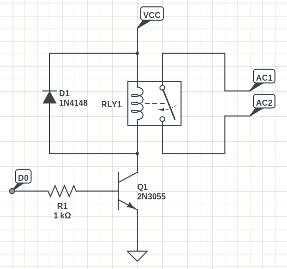

Coil of relay is driven by NPN transistor from GPIO16 pin (PIN0) of ESP8266 board. Here is schematic of relay module:

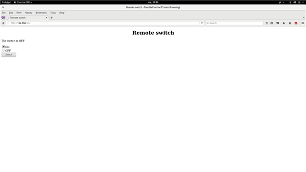

- creates web server with simple HTML page which allow to control relay remotely.
Here code of LUA script:

Here is view of this HTML page:

  • rcaste53
    rcaste53 over 8 years ago +1
    The connection of 1N4148 diode es wrong. Its cathode must be connected to VCC
  • kk99
    kk99 over 8 years ago in reply to rcaste53
    Yes, thank you for information.
