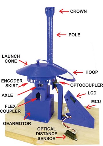

First - here is a picture showing the parts that are visible:
crown, pole, hoop, launch platter, gears and bearings, encoder skirt, optical coupler, motor mount, chassis, electronics case, optical distance sensor, base plate.image

I simply visualized the entire mechanism and every component in the system in full 3D color animation, in my mind's eye, and what each component had to be to make a working system. When people talk about the human brain as being the best computer, it is just a matter of letting it out for a walk once in a while. Anyway, then I just purchased the necessary components, and designed the rest in CAD to be 3D printed. And it all worked..... well not exactly. I ordered a bunch of gears and bearings just as I visualized, but after accepting the orders, several suppliers cancelled due to some virus going around.
So now I had to design both the bearings and gears for 3D printing. So I did all that, but then I decided it would be better to design all the gears and bearings into the other plastic parts.
This all worked out fine except the gears were now going to be plastic, which could wear out quickly. So I decided the gears had to be proper involute spur gears. Involute gears have teeth with curved surfaces such that the meshing teeth roll on each other with essentially no friction to cause wear. The tooth curve is described by the end of a tangent rolling on the surface of a wheel. After researching them, I concluded that whoever invented involute gears was one smart cookie. It turns out the first analysis I could find was done by one of the most amazing intellects of all time. Leonhard Euler. You have the great minds of all time like Einstien, Newton and Maxwell. And then you have minds like Beethoven, Hawking and especially Euler who accomplished spectacular intellectual feats despite incredible handicaps. If you think visualizing this machine was a neat trick, you should explore what Euler could do and did do even after he went blind.
Anyway, back to gears - my CAD system can't do gears and it is pretty tough to design them from scratch. So I loaded up FreeCAD and learned how to use it to make gears - that is the way to go if you need involute gears - really powerful - saved weeks of work.
The gears driving the pole need to allow it to revolve around a main axle without rotating, like keeping your finger vertical while your hand goes in a horizontal circle. This can be done with 3 identical gears, one is fixed to the chassis and it doesn't rotate. One is on the bottom of the pole, and it doesn't rotate. Think of holding a gear in each hand, one hand doesn't move and the other makes its gear go around the first one without touching. Neither gear is rotating, but one is going around the other. If we put a third (idler) gear in between these two non-rotating gears, it will force this relationship to be maintained as the pole revolves.
There are lots of details to design to ensure all parts are strong enough and the axle and pole remain vertical despite all the stresses. When visualizing this, I just made sure they were bigger than needed so no detailed calculations would be needed.
For the hoop I wanted to make it look more like a hoop than a thick doughnut so this meant the conical surface would not be too large, which in turn implied it would need to spin fairly quickly to achieve a decent spiral angle. This allowed the launch platter to have a nice shallow conical angle so the hoop would slide to the pole easily. Because, at high speed, centrifugal force will lift the hoop off even a shallow launch cone.
The Electrics
This is element 14, so the project needs electrics. It has a DC gearmotor driving the main axle via a flexible coupler. Speed of the revolving pole is a critical parameter is dictating the centrifugal force, vertical friction force, aerodynamic tilt (spiral angle) and vertical speed, so it is appropriate to measure and display the main axle rotational speed. This is accomplished using an optical coupler to sense an encoder skirt with 50 slots. The sensitivity of the light sensor was adjusted using a red plastic sleeve so the sensor would work under normal lighting as well as strong video lights.
The processing of sensor data was accomplished using an arduino Pro Micro with a 5110 LCD to display speed and height.
The height was measured by a Sharp optical distance sensor. These sensors are great for many applications but not great for this application. Since it needs to capture the hoop height as it passes by a high speed, it must somehow ignore the edges of the hoop and be fast enough to capture a correct height when the hoop is actually above the sensor. This is difficult for this sensor because it uses 2 light sensors to detect a reflection and the angle of the reflection is deduced from the ratio of light hitting each sensor. As the hoop cuts through the beam it causes large variations in the beam which play havoc with the ratio of light hitting each sensor. The sensor does get the correct height sometimes, but it is not easy to tell which reading is correct. It might be better to use an ultrasonic sensor, but those may have an issue operating at the speed needed for this application.
Another future enhancement would be to drive the DC gearmotor from a PWM speed control. By using feedback from the optical encoder any precise speed profile could be programmed. A second optical distance sensor could be added to detect hand height so the height could be controlled with gestures.
