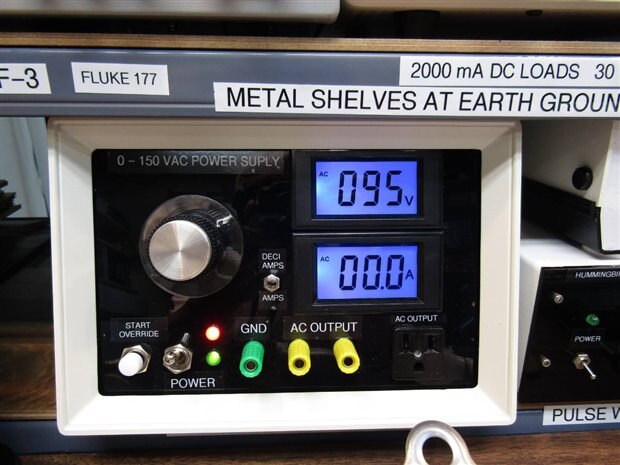

The black wire coming through the toroid will be considered the Primary winding for our experiment and the toroid's original 115 Volt winding will be considered the secondary. The original secondary of the toroid (Red Wires) will be ignored. In addition to the Toroid transformer I will be using an AC power Supply that I built a while back.
and some 115 Volt light bulbs which will serve as loads for the AC power supply. If you happen to try to read the Ammeter on the power supply in any of the following pictures please be aware that it is set to display Deci-Amps. This is a bit strange but it was dictated by Ammeter that I used when I built the power supply. The meter will also display in Amps but the Deci-Amp setting gives me one more digit of precision. In addition to the meters on the power supply I will have a Radio Shack digital multimeter in line to give a more accurate reading of the primary current and a Fluke multimeter to read the millivolt output from the secondary winding of the Toroid transformer. None of my meters or test equipment can be considered of very high quality or precision but they will suffice for this simple general exploration. The AC power supply has a small variac for the output and this makes it difficult to get any precision as the slider on the variac takes steps of a volt or two from one winding to the next.
Here is a picture of the test setup:
In the picture you can see that the Radio Shack meter is reading 0.35 Amps and the power supply is reading 3.4 deci-Amps.
