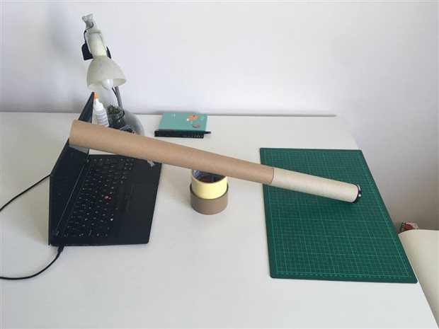

Basic concept is to measure the speed of the sound using echoes and with the microphone build in notebook.
Apparatus and materials:
1. Notebook or device with microphone,
2. Sound editor e.g. Audacity
3. Paper or other material tube with known length (in my case 70 cm length tube)
Procedure:
1. Place the tube is closest to possible to the microphone and start recording with possible highest sampling rate (in my case 19200 samples),
2. Make sound by clapping hands or whistling,
3. With the sound editor find the first sound and its echo then measure time difference between them. The speed of sound could be calculated from below formula: speed = (2 * length of tube) / time. If you use difference in samples you could get time value by dividing this difference by sampling rate e.g. 750 / 192000.
At the of the measurement the speed of sound should be around 350 m/s relative to air temperature.

    dougw over 6 years ago in reply to kk99
    There should be some sort of reflection from the end of the open tube because of the acoustic impedance mismatch at that plane.
  • kk99
    kk99 over 6 years ago in reply to dougw
    I have not tested this case but probably there will be a reflection from nearby wall.
    Interesting experiment. If the tube is open ended, do you still get a good reflection?
