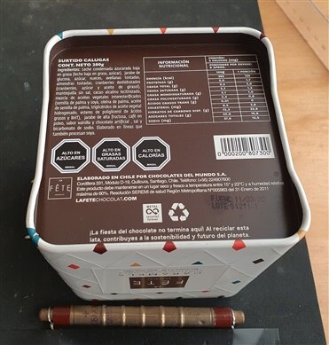

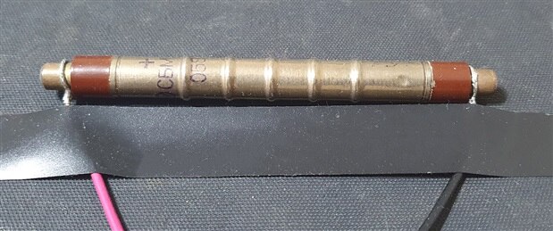

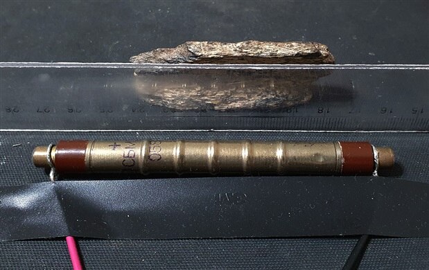

For the Geiger counter I used a SBM-20 (СБМ-20) tube, which I bought for less than 10 USD on ebay long ago. These tubes were produced in the Soviet Union during cold war, they have a length of 108 mm, a diameter of 11 mm, use a gas mixture of Neon, Bromine and Argon and require a voltage between 350 and 475 V, and when they detect an event they turn conductive for ~0.5 ms.

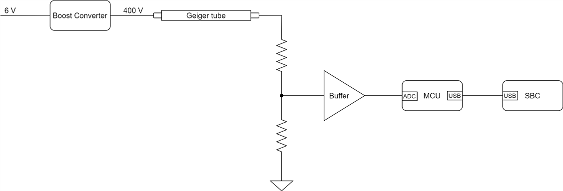

The setup that I build to make the measurements looked like this:
Voltage is boosted from 6 V to  400 V, and supplied to the Geiger tube. When a ionizing radiation event occurs, current flows through a Mega-ohm range voltage divider and feed to  an MCU ADC through a buffer. The MCU samples at ~18 kHz and sends through a virtual serial port the time when the event occurred to the SBC, which stores the data into a file.
To avoid affecting the measurements I taped the tube to the bench:

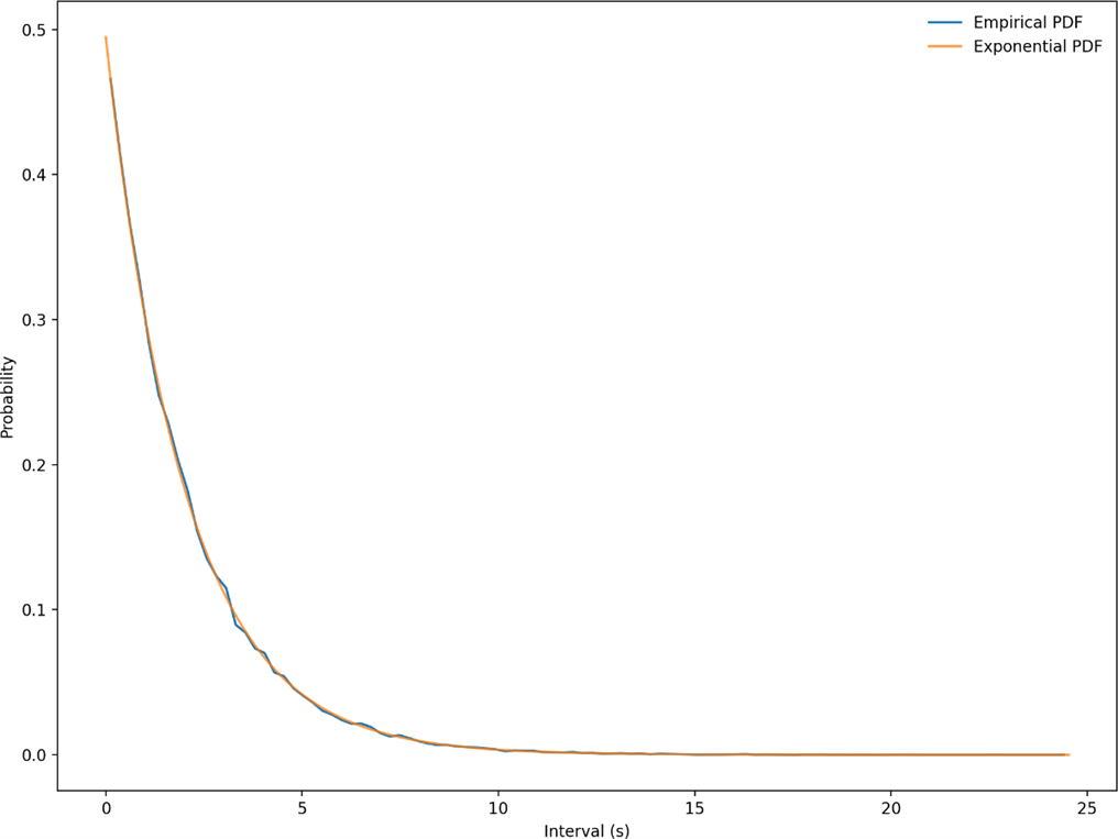

The distribution of the intervals of a Poisson point process have an exponential distribution, which can be specified with a single rate parameter as well. Since the tube can't detect 2 events with a time separation of < 0.5 ms, the Poisson point process (and the interval exponential distribution) can't perfectly describe the captured data, but at low levels of radiation the chance that 2 events occur with a separation of < 0.5 ms is still quite low.
At this point it was time to test the theory, so I generated an histogram of the interval times and normalized it to generate an empirical probability distribution function (PDF), which was compared to the exponential PDF at 29.7 CPM.

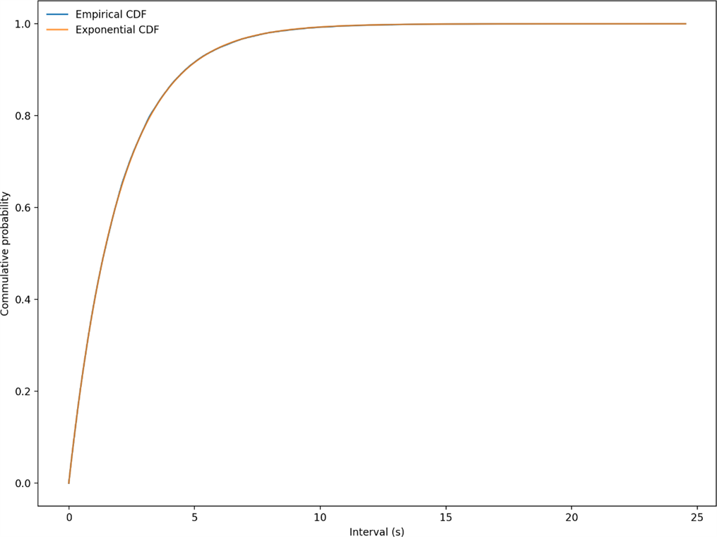

Then I did the same, but with the cumulative distribution function (CDF).

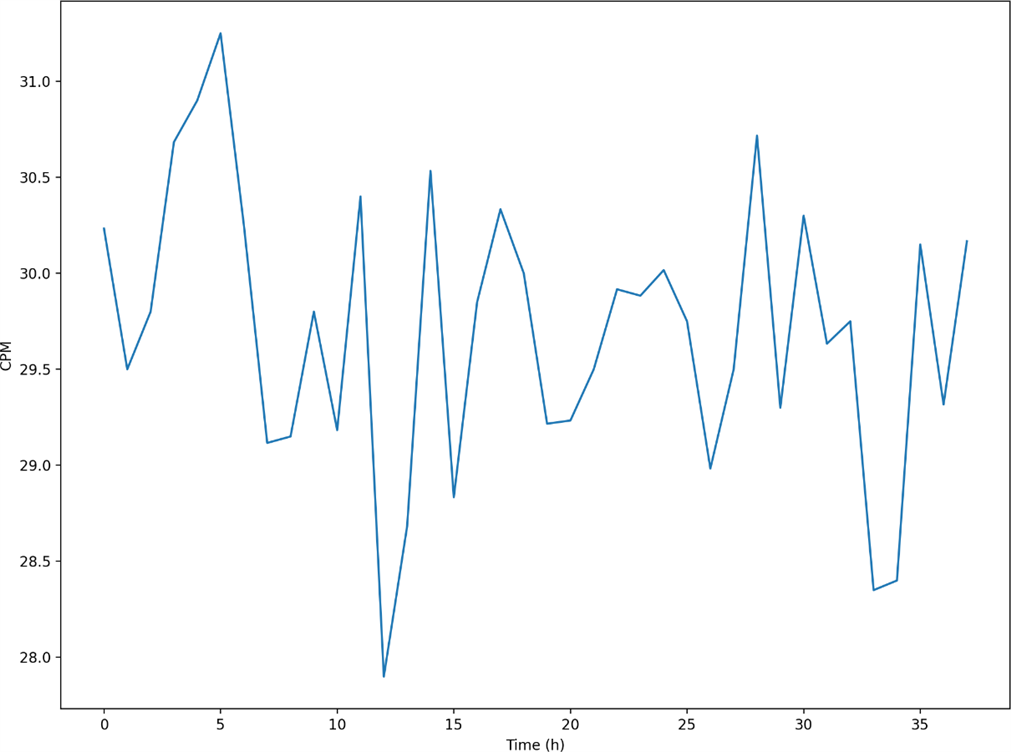

The empirical data matched really well the theory, but to perform more objective tests there are goodness of fit methods such as the Kolmogorov-Smirnov test, but I didn't want to make this blog post more boring. One last thing that I wanted to quickly and roughly check, was if the counting rate changed during time (or technically if the process was stationary), So i plotted the CPM rate for every hour:
And as it can be seen, at least in this time window, the process appears to be stationary.

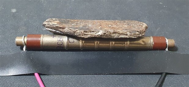

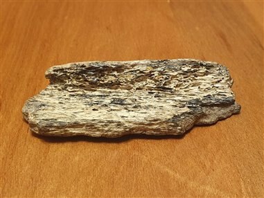

Of all common objects that I have in the house I found just one that produce a very noticeable count rate increase: a fossilized bone. It generated 237.5 CPM, with a 95% confidence interval of 236.5 - 238.7 CPM when layed over the tube in direct contact with it.
The rest of the object that I tried could barely increase twice the counting rate.

Just for fun I tested 2 barriers in-between the radiation source and the tube: a 1.85 mm wide plastic ruler and a 0.5 wide metallic box:

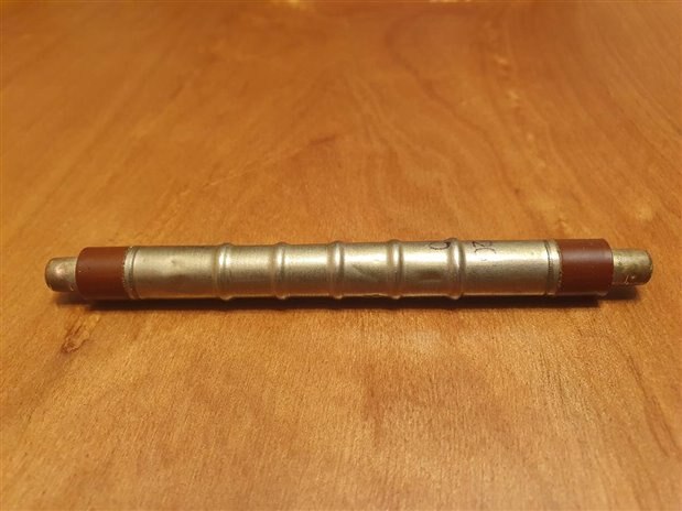

    That's an interesting looking G-M tube. I've got one that I bought years ago (1970s - they were sold as
    'surplus' at the time, so I don't suppose it cost me very much), but I never did anything with it.
    This one was intended for use with a piece of British civil defence equipment. It has a rubber boot around
    it to give some protection and the base is in the form of a plug with two terminals. That allowed the tubes
    to be changed easily [from looking online, it seems that there was also a specialised one that had a tray
    for testing drinking water samples].
    Helpfully, it has the operating voltage printed on it. Perhaps I should give it a try and see if it works.

    The input voltage is 6 V DC, so that I could use 4 AA batts, but here I just connected it to a small 6 V power supply. I then boost-converted the voltage to 400 V, this was not done in the most efficient way (I used some scrap I had laying around). The 400 V is what the Geiger tube (mine is not a scintillator) needs to see, and while no event gets detected, it stays non-conductive (I was not able to measure resistance with my SMU, so it might be in the Teraohm range), when an event gets detected it turns conductive (haven't measured how conductive) . A voltage divider in series with the tube generates an output of ∼3 V when an event occurs. The divider is set to have high impedance so that it reduces the current and the draining of the capacitor that is keeping the 400 V output to the tube. The pulses last around 0.5 ms and are samples with the ADC of an Arduino, the Arduino is connected to a Raspberry Pi that runs a Python program to read the serial port and store the data. The only purpose of the Raspberry Pi was to save electricity, as leaving the computer on for so many days on would have cost me quite a bit (All the experiments took me several days of continuous recording).
    I will upload the Arduino and Python code to make it available...
