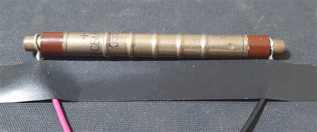

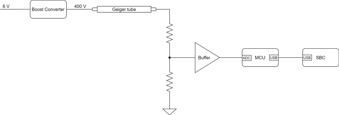

For the Geiger counter I used a SBM-20 (СБМ-20) tube, which I bought for less than 10 USD on ebay long ago. These tubes were produced in the Soviet Union during cold war, they have a length of 108 mm, a diameter of 11 mm, use a gas mixture of Neon, Bromine and Argon and require a voltage between 350 and 475 V, and when they detect an event they turn conductive for ~0.5 ms.
The setup that I build to make the measurements looked like this:
Voltage is boosted from 6 V to  400 V, and supplied to the Geiger tube. When a ionizing radiation event occurs, current flows through a Mega-ohm range voltage divider and feed to  an MCU ADC through a buffer. The MCU samples at ~18 kHz and sends through a virtual serial port the time when the event occurred to the SBC, which stores the data into a file.
To avoid affecting the measurements I taped the tube to the bench:

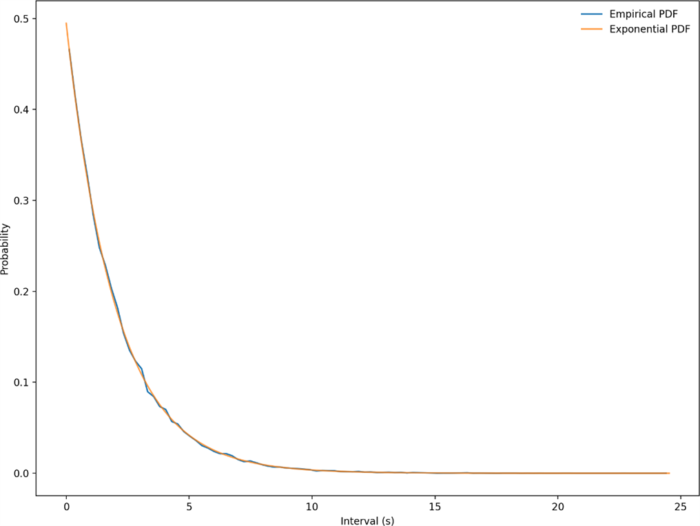

Lets talk a bit about the statistical aspects of the radioactivity events. Radioactive decay events are random and are not affected by external conditions (Temperature, pressure, magnetic or electric fields, etc.). Unless the materials that are radioactively decaying have short decay constant or half-life, the radiation events should occur at relatively constant rate (when measuring it using a large number of events in a long time window). These events can be modeled as a Poisson point process, which is a stochastic process that can be specified with a single parameter: the rate of the points, which species the average density of the points.
The distribution of the intervals of a Poisson point process have an exponential distribution, which can be specified with a single rate parameter as well. Since the tube can't detect 2 events with a time separation of < 0.5 ms, the Poisson point process (and the interval exponential distribution) can't perfectly describe the captured data, but at low levels of radiation the chance that 2 events occur with a separation of < 0.5 ms is still quite low.
At this point it was time to test the theory, so I generated an histogram of the interval times and normalized it to generate an empirical probability distribution function (PDF), which was compared to the exponential PDF at 29.7 CPM.

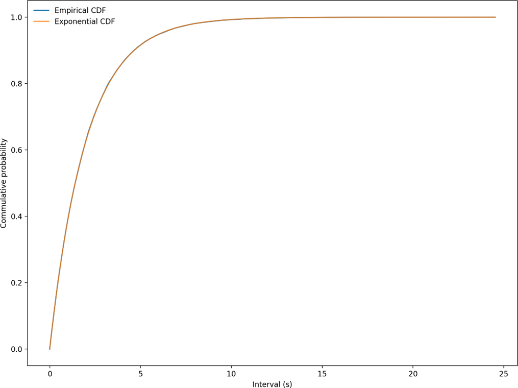

Then I did the same, but with the cumulative distribution function (CDF).

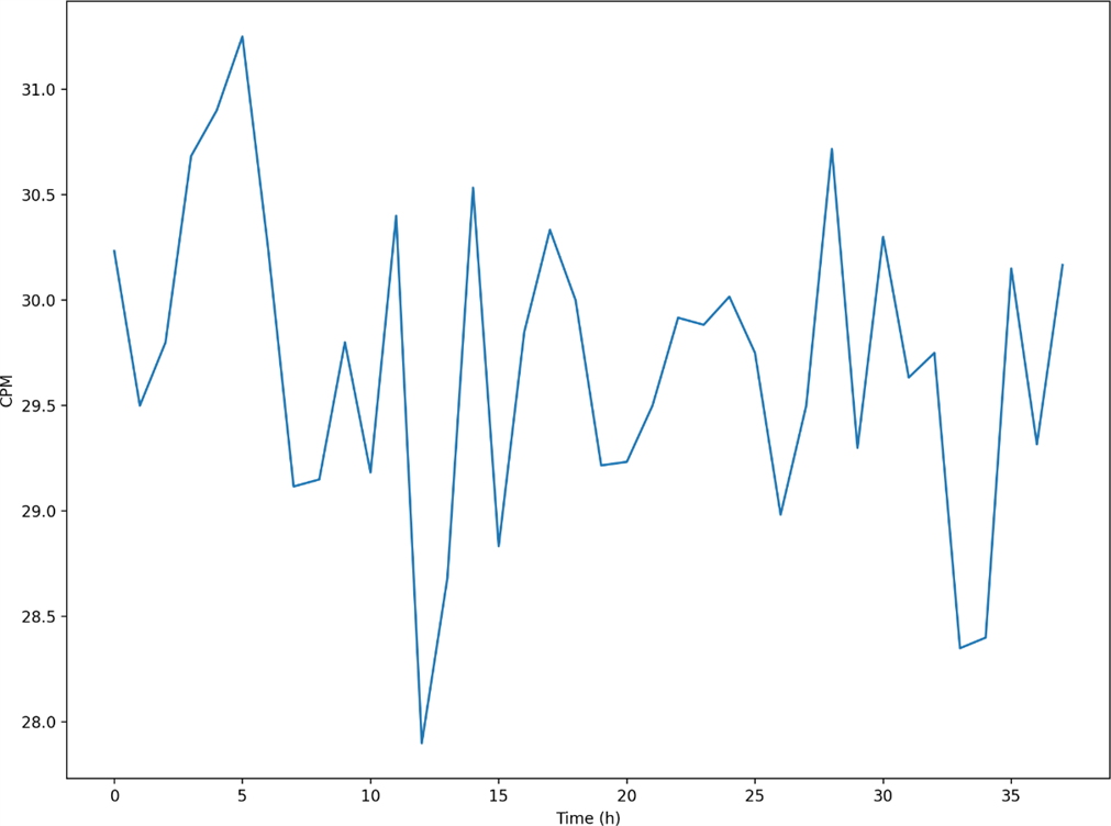

The empirical data matched really well the theory, but to perform more objective tests there are goodness of fit methods such as the Kolmogorov-Smirnov test, but I didn't want to make this blog post more boring. One last thing that I wanted to quickly and roughly check, was if the counting rate changed during time (or technically if the process was stationary), So i plotted the CPM rate for every hour:
And as it can be seen, at least in this time window, the process appears to be stationary.

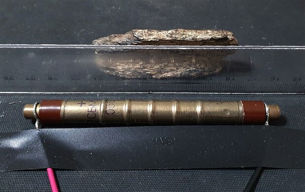

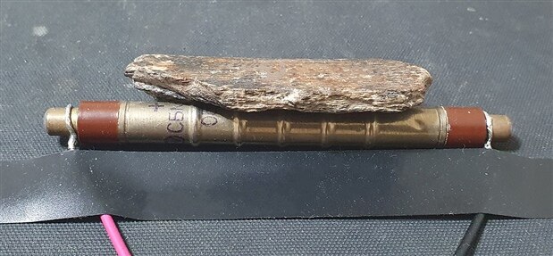

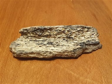

Of all common objects that I have in the house I found just one that produce a very noticeable count rate increase: a fossilized bone. It generated 237.5 CPM, with a 95% confidence interval of 236.5 - 238.7 CPM when layed over the tube in direct contact with it.
The rest of the object that I tried could barely increase twice the counting rate.
Next I wanted to see how the distance affected the measured radiation. So I measured the rate by separating the fossil from the tube at a distances of 2, 4, 8, 16 and 32 cm:
Absolute CPM
Background: Mean: 29.7 CPM, CI95: 29.5 - 29.9
02 cm:      Mean: 81.0 CPM, CI95: 80.4 - 81.5
04 cm:      Mean: 57.2 CPM, CI95: 56.7 - 57.6
08 cm:      Mean: 40.8 CPM, CI95: 40.5 - 41.2
16 cm:      Mean: 33.3 CPM, CI95: 33.0 - 33.6
32 cm:      Mean: 30.6 CPM, CI95: 30.4 - 30.9

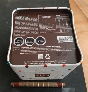

Radiation blocking
Just for fun I tested 2 barriers in-between the radiation source and the tube: a 1.85 mm wide plastic ruler and a 0.5 wide metallic box:
Absolute CPM
Background: 29.7 CPM
Unblocked:  57.2 CPM
Ruler:      48.1 CPM
Box:        43.8 CPM
I subtracted the background and also computed how much radiation flew through the barrier to the tube:
Differential CPM
Unblocked: 27.4 CPM
Ruler:     18.4 CPM (67.1%)
Box:       14.1 CPM (51.4%)
As it can be seen the metal box blocks more than 3 times the amount of radiation per width than the plastic ruler. These experiments could have been much more interesting, for instance I would have liked to test different metals, but sadly I didn't have much around to perform more interesting experiments.

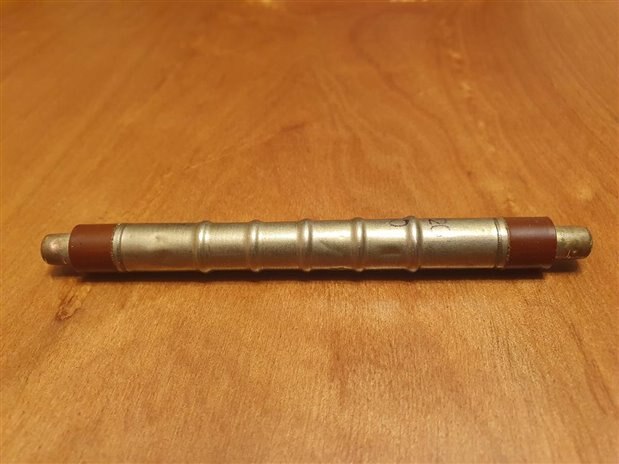

    Here are a couple pictures of my unit: It seems I bought it in 1973 from a company called Edmund Scientific. I guess I paid a couple hundred dollars at the time. I did not have the electronic skills to…
