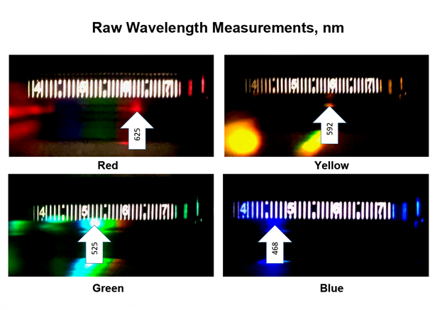

The spectroscope was then used to measure several Lite-On brand LEDs in my possession where datasheets were available and one unknow red LED.  The resulting spectrographs were photographed and shown below.
Credit: the author
The arrows with wavelength records my estimate of the brightest part of that line in the spectra.  If my attempts at calibration are to be believed, the blue LED is about 4 nm off high and might be corrected to 464 nm.
The intensity of the LEDs as a function of the wavelength when fully turned on are given in the datasheet by Lite-On in the following graphs.
Credit:  Lite-On Datasheets
Note that at half the peak relative intensity the breadth of the wavelength can be 25 nm or more.   And while the Lite-On datasheet does not give minimum, typical, and maximum wavelengths for their LEDs the Vishay TLHF5400TLHF5400 gives the following:
Credit:  Vishay TLHF5400TLHF5400 datasheet
So there is uncertainty in all the sources of data.  The spectroscope results have been tabulated below along with the datasheet values from Lite-On.

There is potential for greater than 5 nm difference from the typical datasheet value and the "corrected" value from the observations differs more from the datasheet than the raw value.
